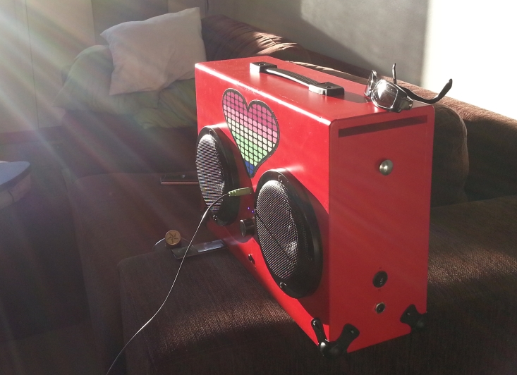

Hi

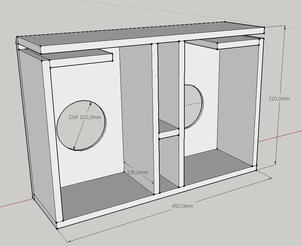

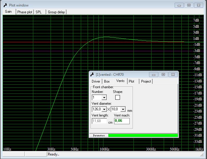

I just wanted to show you my experimental project of using a pair of MarkAudio CHR-70's in a Boombox. This was my 3rd Boombox I have built.
Both elements are in 6,5 litres BR. I calculated vents with the winISD. The Box has a 5 Ah Lithium battery, but also possibility to use 230 VAC.
I think it sounds very good and the little T-amp ensures (2x12W), that the xmax of CHR's will not be exceeded.
(The heart blinks by the music.. ;))

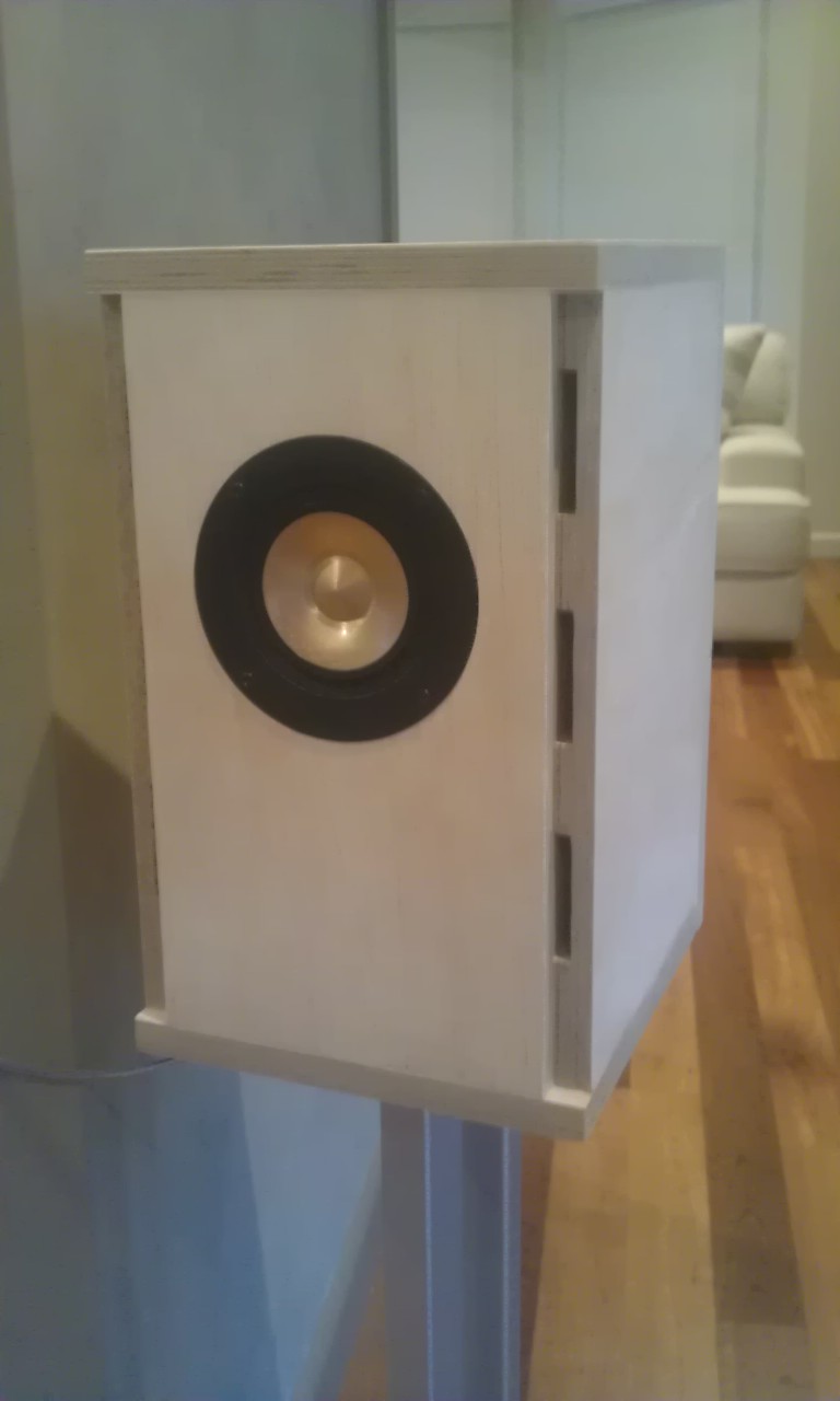

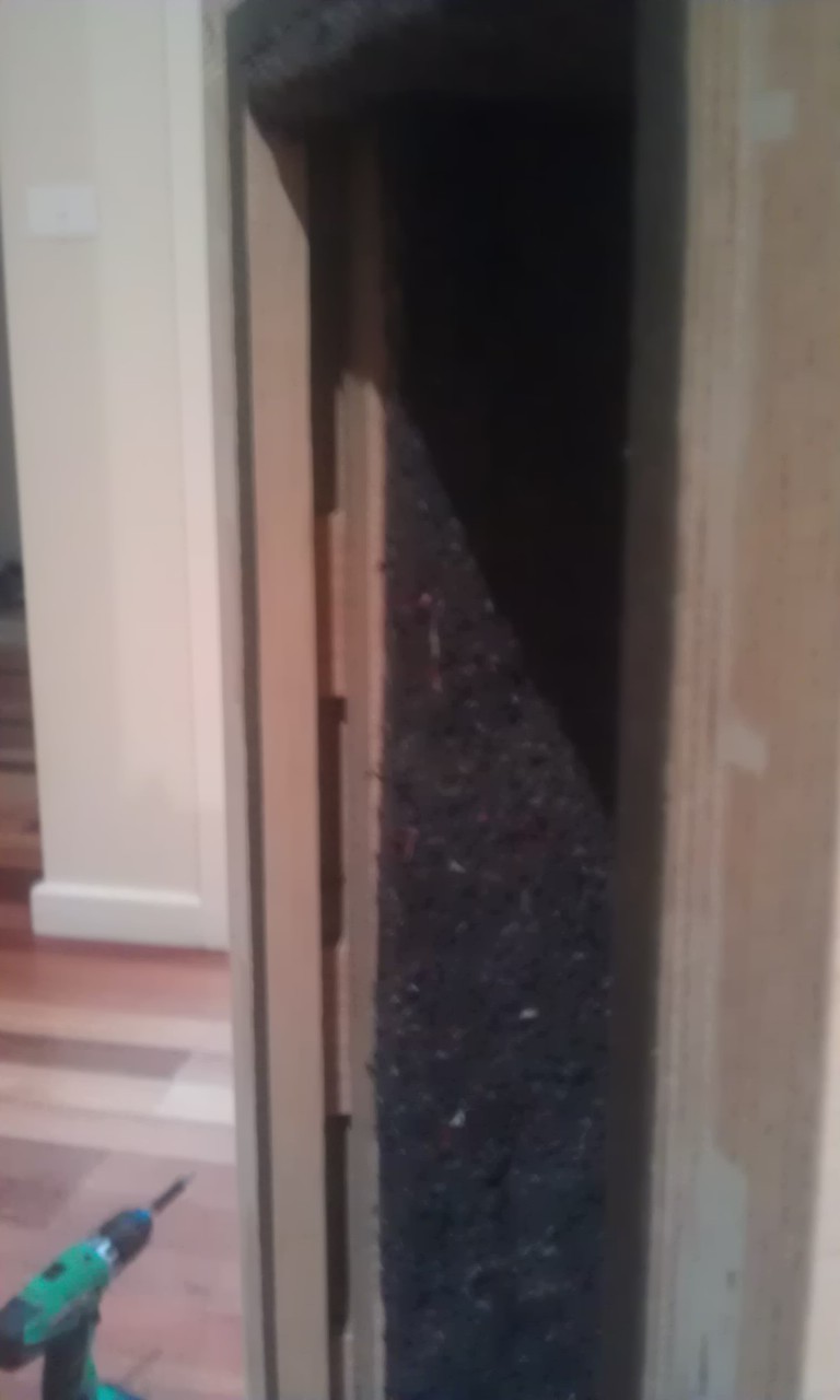

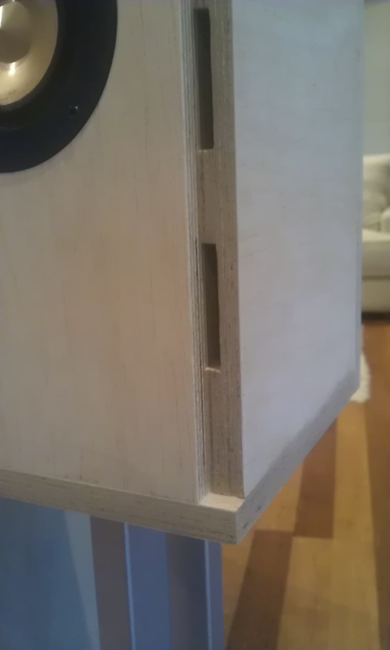

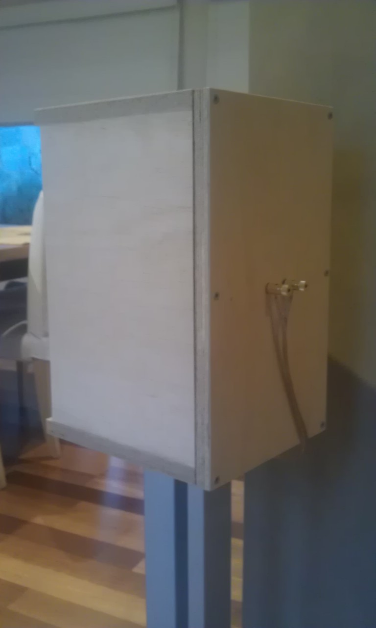

Hi All. I just finished these CHR-KEN's with the Enabled Planet_10 Hi-Fi CHR-70.2's ;). I've been breaking them in and they've been playing at low levels for around thirty hours. This project was my second speaker build and my first with the Mark Audio drivers. They sound great with my Helder Hi-Fi TA2020 amp! Guitars and vocals are excellent and I was pleasantly surprised with the quantity of clean bass these boxes produce. I haven't had a chance to mitre the corners so the ports are currently 198mm long in lieu of 191mm. I hope that doesn't adversely affect the box tuning. I routed out the ports into the 18mm marine ply outer side panels & also made the boxes slightly narrower and slight deeper than the Planet_10 design but maintained the nominated cross sectional area and height. I also installed a 12x18mm wide strip of plywood to the back of the outer side panels to allow for the wool felt lining attached to the rear plywood panel (see last photo). This helps to keep the slot before the ports clear. I hopefully will get around to installing the internal bracing but I'm soooo enjoying listening to the speakers I'm afraid I may never do it! :D
A BIG THANK YOU to Dave and Chris (Planet_10 Hi-Fi) for your efforts and for supplying the design (and anyone else who helped)!
Regards, Richard.

Richard,
Took you awhile :D
Longer vents will tune a bit lower.
dave
Hi Dave.
It took a long time for me to decide which box to build the CHR-70's into with the many designs available and then even longer to start building. I'll chamfer the corners soon to get the correct port length. Would there be any benefit in slightly angling the internal bracing panel to help reduce the standing waves between the parallel vertical surfaces?
Thanks, Richard.

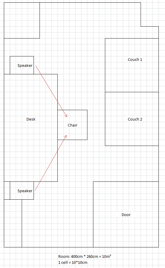

Thanks for the quick reply! I enclosed a small sketchup of my listening situation. I entirely agree that a Pensil or Tuby would increase bass extension and dynamics compared to smaller designs noticeably. As you can see on my room plan I have space to accommodate bigger designs but I am concerned about two things:
a) the stereo-triangle would not be optimal, because the speakers are far away from each other but I am rather close to them and
b) the desk I am sitting at is massive - so there is no straight line between the end of the tube near the floor and my ears.
Given a) and b) I thought going for speakers on the desk would be necessary.
When you look at the room plan, what are your thoughts on that?

First thought would be to suggest a narrow profile floorstander such as Pensil, but that would place the driver centre at approx 740mm from floor - most likely right at work surface height. You could raise them with a false bottom or separate stand, but Scott would no doubt say some thing like "at the risk of sacrificing some of the floor boundary coupling that is part of the design calculus" . Neither can the driver location or internal height be "stretched" to suit aesthetics - that is, without turning it into something else that may or not sound fine.
Any of the smaller desk-top enclosures would be a reasonable alternative. Of course they wouldn't develop the same bass extension, but a separate woofer could always be added should that prove to be a major shortcoming. FWIW, In both my "desk-top" set-ups, I like to raise the enclosures at least 6"
