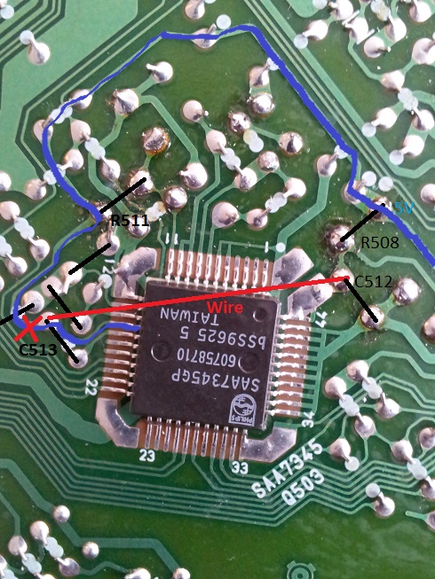

Decoder mistake
Hi all
According to an old post from Brent,
http://www.diyaudio.com/forums/digital-source/54009-marantz-cd63-cd67-mods-list-339.html#post959994, Marantz made a small mistake with the decoder circuit.
I was wondering if it's important to fix this when adding separate regs to the decoder, or should I just leave it as it is?

Don't know if it will make a lot of difference soundwise, but if you're working on the decoder area anyway, you could change it. Marantz' schematic is not conform the decoder datasheet.
Marantz fixed this in the CD63 MkII KI player and did some changes to the decoder circuit. So this is not a problem in my player.
Oh, so it's an mkI problem. Didn't know that
May be I was wrong, from my experience even MKII KI has the same wrong connections in the PCB. I need to make some changes in the PCB to ensure the +5V supply to the digital and analogue circuits of the Decoder are correct.

You are correct highlander, the PCB layout around decoder is a bit different but the mistake is still there. I took the board out to trace.
The blue line in the pic shows that 5v go straight to pin 15 without going thru R508.
The fix is to cut the track between R511 and C513, near C513.
Then wire from C512 (pin 44) to C513 (pin 15).
I think I am correct on this.

Fixed this on the decoder circuit. Also added separate regs (only 7805, SPowers later).
3x DAC
2x Decoder
2x Servo
Sound is now much cleaner and powerful, better bass. Less digital.
