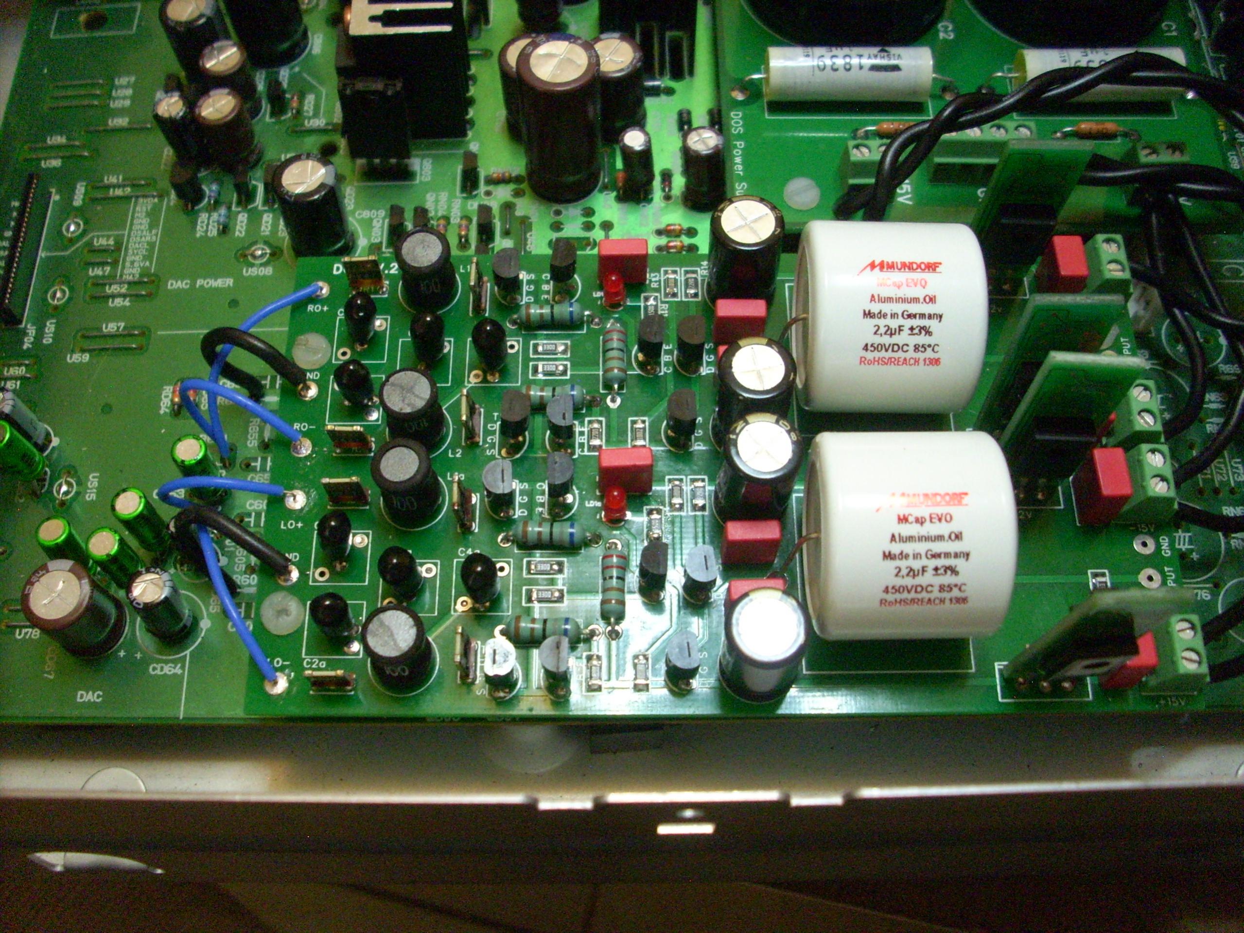

New DOS
Mundorf has recently come out with a new cap line, the EVO's. Their small size makes them ideal for use with the dos. Ray has already used them, mounting off board. This gave me the idea and inspiration for a new Dos board with the caps on board.
I changed most of the resistors to smd's, which created the board space to use the Evo's and to keep the board size about the same. I think I had to extend the board 4 or 5 mm's is all I had to add.
Also included Ray's use of an led for vref, and with his instructions of a month ago, in post, #19713 of this thread, I was able to adjust the current to what I wanted.
I just got this constructed and mounted into my 8260 yesterday. I am quite pleased with this new addition to the player.

Super cool work.... can you provide those boards ?
BTW, the new EVO caps are really good

470pF will get you close enough. The filter gets a more smooth roll-off and you can hear the difference in the high-end. If the player is not fully tweaked and still sounds a bit harsh, it can be a good tweak to make it sound a bit more friendly. But after my player was decently tweaked, I went back to the original filter to have a bit more 'bite' and detail in the high-end. That was before the DOS entered the room. The passive filter of the DOS can also be changed to Bessel by the way.
Ray

Did you adjust R611/612? You should, this gets the roll-off frequency back to where it should be.
Otherwise, I can recommend the 220pF capacitor between the 10k resistors. This is a very nice tweak to get rid of some 'digitalis'.
Ray
