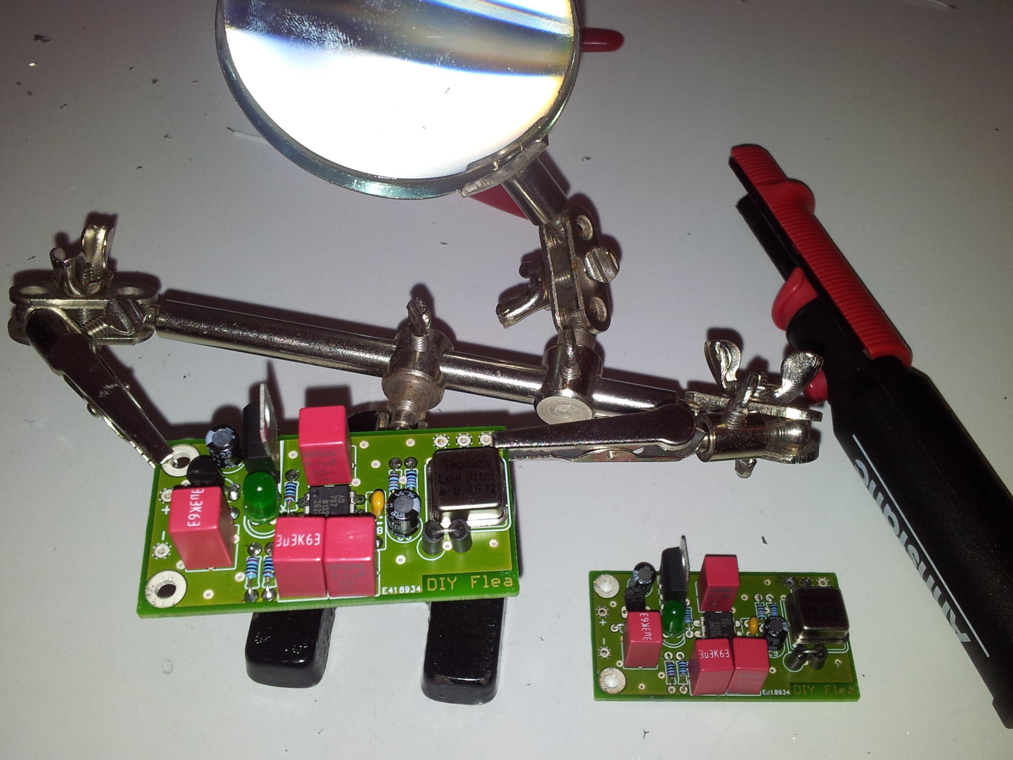

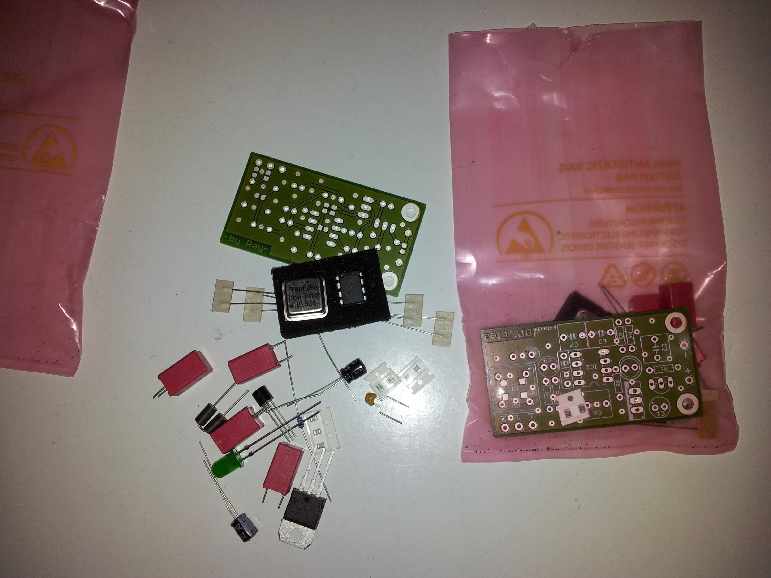

Two Fleas
Hi
Received two Fleas for DAC and Servo, from Ray few days ago. Have been putting them together and mounting in the player. SMD soldering is pretty tricky for a guy with a bad eyesight, but I pulled it off using magnifying glass and a lamp.
Sound is now very smooth and detailed. I expect it to get even better with more run-in time.
I want to thank Ray for good service and quick delivery!
Hi
Looks nice. I've finished mine about a week ago,but haven't put it in yet.
Could you upload a picture of all of your connections on the flea and the board?
Sorry, I don't have pictures of that and I have put my player back together.
For DAC: remove the crystal, CD02 and CD03 - use the holes left by the CD03. Looking at the front of the player, connect ground output of the Flea to the RIGHT hole and the signal output of the Flea to the other hole.
For Servo: remove the resonator (X101) and R126. Use the MIDDLE hole left by the resonator for the ground output of the Flea. Looking at the front of the player, use the RIGHT hole of R126 for the signal output of the Flea.
It's best to use separate PSU for the Fleas. If you don't have separate PSU, you can take 20v feed from C803 in the player.
You're welcome!
Nice work, good to hear you like the result.
Ray
