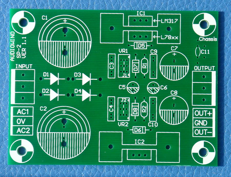

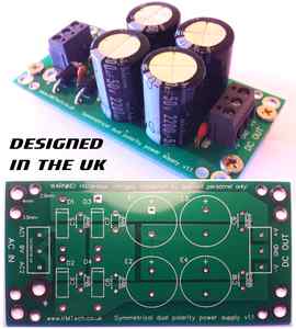

For the power supply to Dos I am thinking of using this board
after the toroid, followed by this
before dos (the 4 diodes replaced by 2 jumpers)
just want to know the best cost effective electrolytic capacitors to use on the 2 boards, would it be Panasonic FM on the 1st board then on the second board C1 and C2 FM's and C3 and C4 FC's
I'd rather use just the second board. It has room for rectifier diodes and smoothing caps, just like the first one. There are a few extra ceramic caps, but you can easily stick them on the underside of the second board.
Panasonic FM and FC are good choices, Rubycon comes to mind as well, and you can have a look at Elna Cerafine or Silmic to use at the output-side of the regulators, or on the DOS board.
