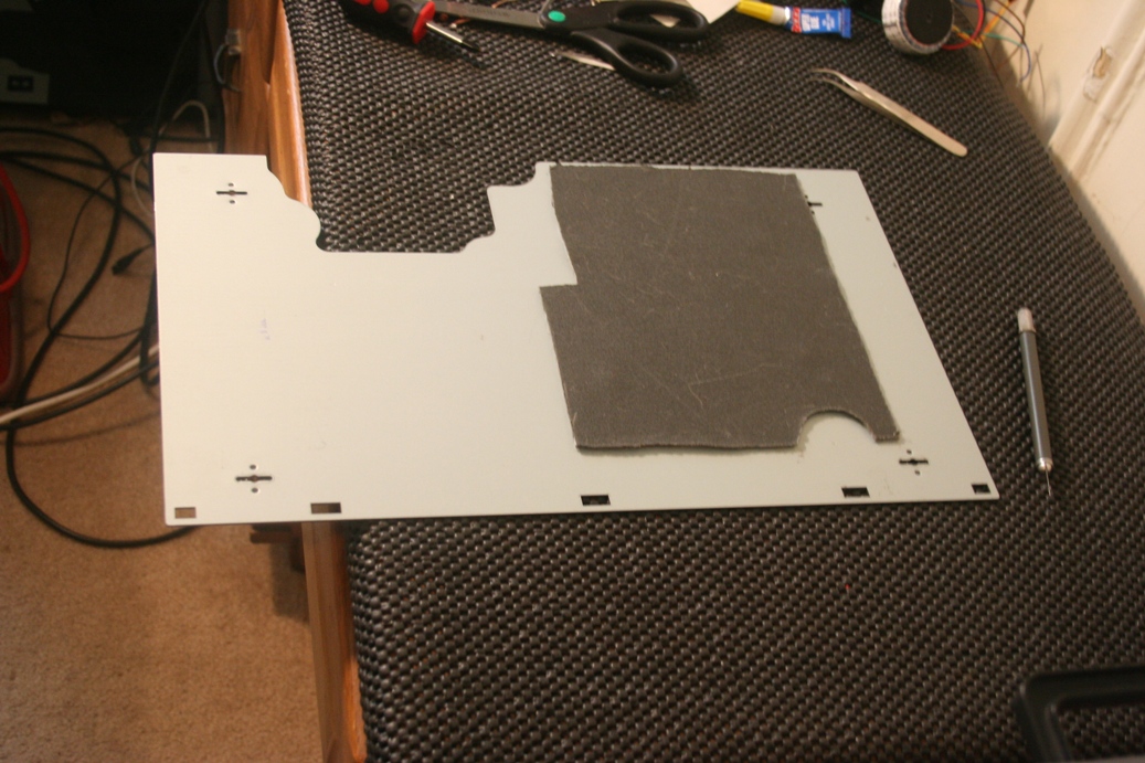

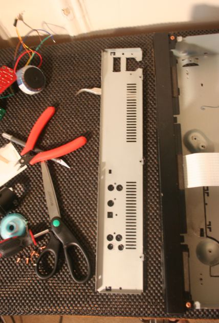

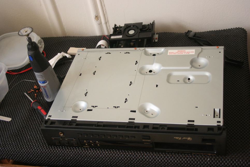

Do you mean something other than the standard access panel? I haven't done it on mine, but I understand there's a specific section stamped out of the base that's designed to be easily removed with snips and (I believe) flips round 180 degrees and can then be screwed back on.
Not sure which parts of the board specifically it gives access to, but it's only a section of it.
I might give that a go on mine actually. I'm fed up with removing extra power supplies and such to do a simple job on the underneath.

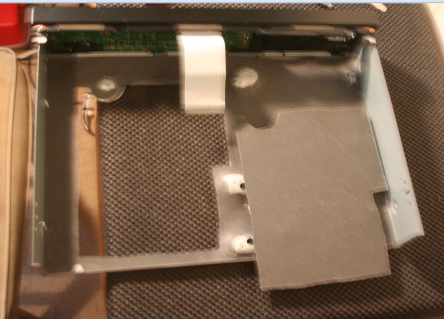

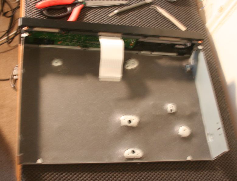

The base of mine does not have a section which can be 'snipped out' (mine's a KI Signature), but I've worked out that a section can be cut out to give access to most of the underside of the pcb. It's a pain to have to remove everything (flea boards, etc) to get at the underside. It also puts a strain on the wires that are soldered directly down to the board. You are lucky if yours can be removed easily.
I have spoken with a guy at a crash repair shop, and he has asked me to take it in so he can have a look at it. He'll be able to give me an idea of whether he can do it or not.
So, when the square is removed, it can be screwed back onto the steel underplate (and/or spot welded to the plate), and the steel plate screwed back in position. So, to access the underside of the pcb, all I need do is unscrew the bottom steel plate – 4 screws. And presto! The steel plate will come away along with the square that has been cut out.

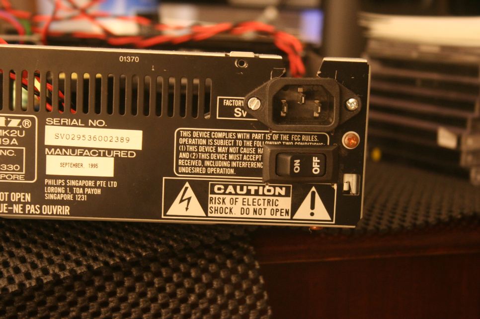

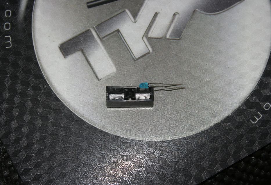

Marantz CD63 Case Mods
As requested. :)
