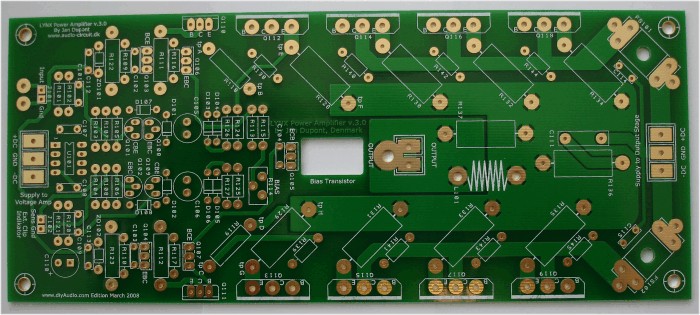

Hi Jan, the boards do look excellent and I am looking forward to building the amp. Just a thought; there are obviously many types of components that could be used to build your amp, some cheaper than others and some quite expensive. Do you have a definitive list of components that you would use personally if you wanted to build your amp to the highest possible specification without due regard to the cost. I for one would love to know unless it is asking to much. I hope you take some time out to relax after all your hard work on this group buy, Enjoy. Cheers Jan. Best wishes Jerryo.

jerryo;
If I had chosen to prepare the pcb for the best possible components, I think it would have been twice as big....
It's a poor mans Solid Rock Amp.......
But I will make some comments in the Quick Assembly Guide soon

Ok all
Thanks to much help from my beloved 11 year old daughter, who now has sticky and bleeding hands (but also got "very" rich ), most of the boards went out today......

Hi Jan + datter!
My 4 PCB's arrived today and look amazing. Now I "just" have to purchase components.
BTW, are you planning on building your PSU-card yourself? I'm asking since I'm very pleased with the looks of the amp-card, if you are going to let manufacture psu-cards as well. If so, can I purchase 4 pcs from you? We could make it a "Send prepaid jiffy envelope + money"-thing.
