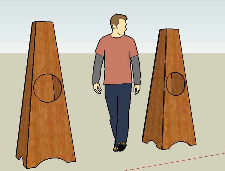

Nordic said:How do I work out the lenght of the feet part that extends past the bottom...? those bits with the curves cut out...
They aren't even necessary if you run the port out the front, back or sides...

What level of fudge factor is there with the actual dimensions?
I.e. will a few mm diffirence to the top plate make a big diffirence?
Just trying to make something that can actualy be dialed in on a saw, like 83 degrees as opposed to 83.34.
I guess one could also alter the height by a few mm
Edit:
Scrap that idea... seems it makes a huge diffirence in dimensions.
Angle = 83.34
Hypotenuse Side =1534.7825
Opposite Side=1524.4256
Changeing the angle to 83, would reduce height to 1449.6937 from 1524.4256 i.e. 3 inches

Have you considered posting these pretty specific questions on The Metronome thread?
It sounds like a great project to contribute to the Metronome family.
Jerry
Jerry
Oh, of course. I just know all the various builders of the Metronome are there, that's all.
The Metro box for the Super 12 was big for me. So I had been looking at the Metronome as a serious option for the Cast 10. It's curve is also amazing. Now that the dimensions for the Cast 12 are out and smaller it is, to my mind, a killer combination if someone would like the option of not using a sub.
Go for it! The looks are outstanding for a 12in too. Very harmonious.
