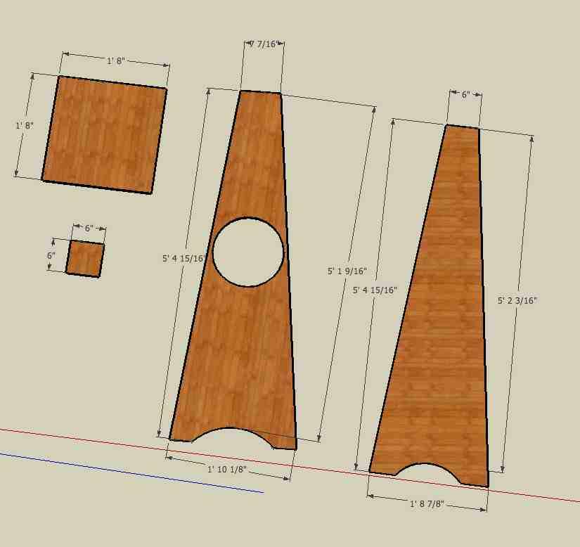

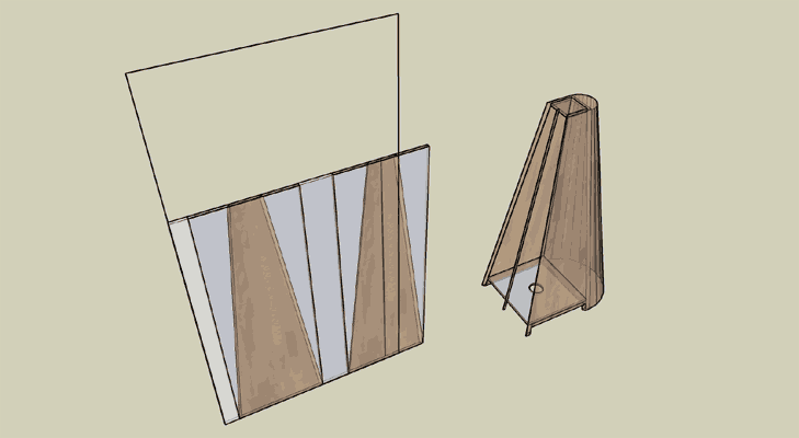

I have been converting the measurements to actual sizes of cuts,
Looks like it is going to eat plywood.... to the tune of $150 per speaker, with lots of left overs
I looked at another way of cutting them (to the same dimensions), but it is difficult and would probably need some big saws, this would produce 2 full sides and 2 half sides (which can be joined down the centre, which should get both drivers out of the $150 worth of plywood (3 sheets 2440x1220mm), with enough scraps for a subwoofer or some mini monitors left over.

We may want to break this out into a separate thread to not pollute this one, but I have plans to make a pair as well and would love to see your cut plans.
How were you planning to perform the cuts? I'm thinking a circular saw and a guide would work as I have the equivalent of a Fisher Price table saw. Also, the semicircular cutouts on the bottom to form the feet would be a challenge for me. Any advice on that?

My boards come in 1220x1440mm, which is a bit of a mismatch
It has to first be cut down to 1220 x 1646mm, the top an bottom (short sides then need to be shaved at angle just shy of 2,1:18.
I will use mittred angles, wich makes one side of the cut panel wider than the other, the lower side of the shaved top and bottom is always on the wide side.
I would start the first panel as the line running from top to bottom through the centre of a panel, so the first cut would be half of a side, this cut is done at 45degrees front to back and will be the side of the next headless pyramid witch fits in inverted next to this cut, so from the same board the panels cut next to each other will be face, rear, face, rear., this takes care of the tops and bottoms being angled correctly also...
Our first panel was only half a side, the second one you mark out can be a whole side, as can the third, the forth one will only leave enough space for half a panel again, So you can get up to three sides out of one board
My sketch has some rectangular blocks used as spacers to get the measurements right, I am starting to like the look of this band down the centre, it also shows the cut off piece on the top of the main board

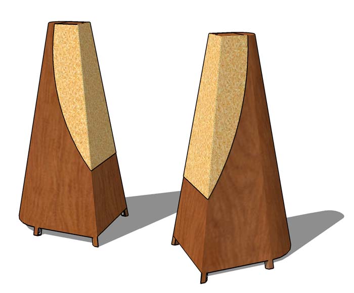

I started thinking the large 'nome just looked too gothic. Ended up adding a rounded rear wing (gonna be hard but I once made a rococo chair), I'll probably fill this with sand to avoid resonance and to provide braceing to the inner panel. And a nice clip on grill.

udailey said:I was reading that grills add dips in your frequency/spl curve.
It usually isn't the grill material themselves, but the grill frames that cause the problem. It is tricky to do a grill that doesn't get in the way but it is possible.

Hi Nordic,
I've been thinking about what is making it look gothic - or at least what we loosely call gothic. To me it's two things which are mutually reinforcing though happening at a subtle level.
First, adding elements of a strong curve approaching a 180 "U" to tapering straight lines in the design. Combining such curves with converging straight lines is a Victorian aesthetic. Sticking with just straight lines has helped the converging lines of the Metronome seem more contemporary perhaps unconsciously borrowing on the crystalline motif.
Combining 180 curves with parallel straight lines avoids this. But the Metronome is defined by it's vertical convergence in both form and function.
Second, the prominent parallel top and bottom in an otherwise converging vertical theme. Tall and thin dominates most other Metronomes allowing the more distant parallel tops and bottoms not to compete for our attention as much. When the top and bottom are compressed as in the 12 inch variation it not only brings these two surfaces closer together, it also lessens the clear aesthetic dominance of the vertical taper. And it is a shape we associate with "gothic" being a common Victorian motif used in architectural roof shapes as well as stone tombs and monuments.
During my analysis it occurred to me that the conventional converging straight line Metronomes could look even more contemporary in a clean and energetic crystalline sense by adding a faux top. Still parallel internally to the bottom in keeping with it's function. But externally with a cosmetic slant upwards from front to back or tilted from one side to another or something organic in between. We find crystals pleasing and this is how many naturally terminate.
However, I do like the large and more gentle visual curve you've added using contrasting color and value. I think the benefit it conveys is to somewhat harmonize or bridge the two effects I've described. But to me it just needs a little help to overcome them. This visual curve would be completely effective if either the top surface were rounded (preferably in an arc vs a large radius edge) or if the rear curve were less prominent. (Perhaps less than 90 degrees.) I'd imagine such a modified rear curve would still help with box regidity, internal reflections and rearward wrapping external diffraction if these were it's functions.

Thanks, yes I did try to round the tops, but hit a brain fart, figured out how to do it properly afterwards(was a long time since I did technical drawings at school), I did figure out lots of hidden thingies in sketchup now. Will add the curve later, but it iis going to be even harder to make... the current curve can be made by cutting grooves from top to bottom.
