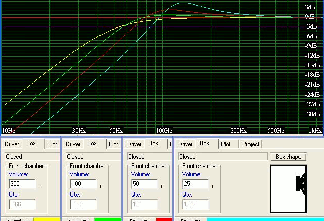

While we wait for guru assistance, is it okay to kill a little time chatting about one of your fundamental choices? Since you only need down to 80Hz, I think the AN cast Super 12 might be overkill in that size room. Sounds like you could get by with something less extreme (by fullrange standards). Anyway...
Attached is an extremely crude sim I did in WinISD using the specs at:
http://www.commonsenseaudio.com/an12cfspecs.jpg
(It would be nice for Godzilla to chime in here since he's the WinISD guru in these parts.) It shows the bottom end you will get in a sealed box, as you go from 300 liters (wow!) down to 25 liters (ouch -- not sure the cast frame would even fit). (By the way, this sim ignores room factors.)
As basic as this is, I hope you see that scaling the box size "adjusts" the bass response. Make the box too big, and bass rolls off gently but too high. Make the box too small and you get that bump in the curve -- some people find the bump pleasing if there's no sub, but the bump is not desirable when mating with a sub.
Obviously you wouldn't build any of these boxes in reality. In fact, I'm not sure you want a sealed box at all (though some people feel they integrate with subs well), nor if you even want those humongous cast-frame 12" as front mains where you're only going down to 80hz. I'm not helping you much, am I? :)

If you want full, tight, slam , go with the 12"s in a 2cu. ft. sealed cab . If you stuff with fibreglass , you can adjust the amount to give the exact bass "weight" you want , while the 2cu.ft. size is reasonable.
2 cu. ft. would correspond roughly to the 50Litre graph, but if you were to stuff the cabinet, then it could approach the 100Litre cabs rolloff. IME , stuffing will reduce some of the "snappyness"

Thank you for the WinISD chart. According this this a 2.5 cu. ft (70 liter) for the 12 looks like only a moderate bump in sealed. What would that look like ported with one large 6" port the way it was done in the AA review?

Thank you for the analysis on the 2 cu. ft. That's sort of an ideal size aesthetically. I take it reducing the "snappyness" too much is a bad thing. Half-stuffed would yield the 70 liter result. That'd be just a slight bump. Not bad. Or worst case size wise: an actual 2.5 cu. ft. enclosure with no stuffing to give maximum snap. Am I getting the hang of this?

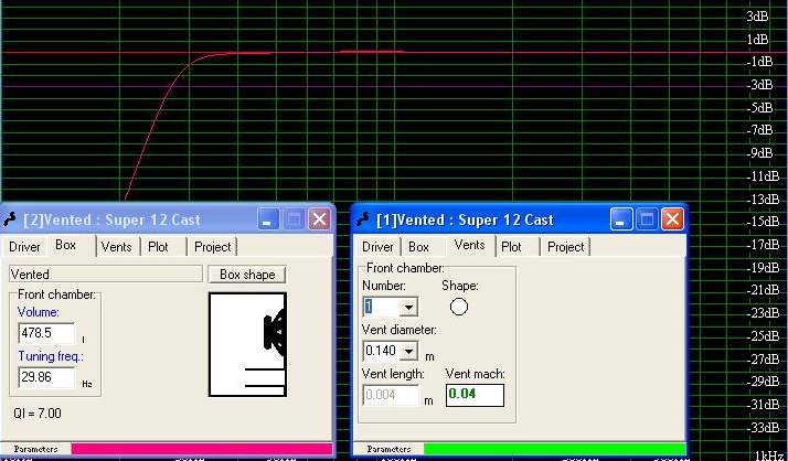

Finally, the biggest reason for going for overkill is that I need to reduce the risk of dissatisfaction.
Hmm, I think designing a speaker system is an inherently risky proposition, actually. The more risk-averse, the more I'd be inclined to build a design that others here have perfected over the years. But I salute your vision -- it's a big one!
According [to the WinISD chart] a 2.5 cu. ft (70 liter) for the 12 looks like only a moderate bump in sealed. What would that look like ported with one large 6" port the way it was done in the AA review?
I wouldn't go for any bump at all -- bump is for small speakers without much extension -- it gives you a little impression of bass. I think if anything, you'd want a nice gentle roll-off in the range where your sub will roll in (since the two will sum in the region where they cross over).
In terms of simming the Affordable Audio vented cab, the cab looks like it's at least 3 cubic feet (so 85 liters or so, minus volume of the driver and port). However, I could not get WinISD to make a nice freq. response curve and reasonable port length in 85 liters. I attached what WinISD does suggest, but as you can see, while the curve is nice, the cab is too huge, and the vent length is, ahem, a little on the short side.
Maybe a guru can chime in here and interpret what this all means!
Commonsense's full size cab is 2.8 cu ft. But it turns out there is a BR 2.5 that David Dicks feels works just as well. Hence my recurring references to 2.5. I have little desire to go into uncharted territory on my own any more than I'm forced to.

- I will build 2.5 cubic foot boxes. But to be flexible, I want to make them sealed so I can try this first before I cut any hole for a port. (A question: sealed would give the 12" the equivalent of the larger box it needs, but would a 12" do as well in a sealed environment as a 10"?)
- I know how great speakers free you from needing a center - I resisted a center myself till only recently. Certainly, for all those great movies originally made in stereo a center can even be worse. But for me it is now essential equipment for well designed 5.1.
- I accept with a larger driver I may lose that fine background detail. But I can't afford AER right now and I would only want an 8" if it was in this class. Besides, I'm gonna need something to research and look forward to :)
- 2.5 cubic feet is the limit of my wife's generosity. It may force compromise in "what could be" sound quality wise, but I want to try the big single driver experience and my wife has only ever had to contend with 1.5 and smaller!
