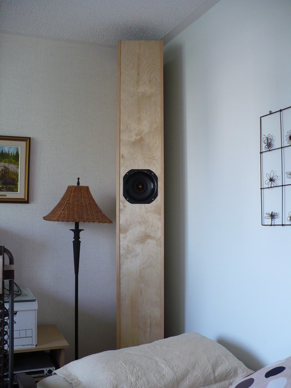

12" in 8" BIB cabinet ????? YES !!!
bomb effect in my 10 x 11 room.
