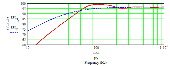

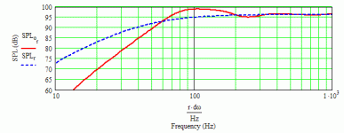

GM said:Anyway, using the AN12's published specs and assuming a zobel is added, a max flat impedance TL that except for size meets all the criteria of reasonably extended LF BW to allow a low acoustic subwoofer XO point, ~critically damped roll off slope for excellent impulse response, benign impedance if using a high output impedance amp and when properly located in-room may not even need a sub system for the majority of movie soundtracks:
L = 85.468"
CSA = 335.121"^2
zdriver = 32.197"
All dims approximate and sim assumes 1.091 lbs/ft^3 of polyfil. Compared to a sealed version it has a much lower Q Fs impedance, ergo flatter phase and slightly better impulse response, faster roll off below Fs and slightly more gain BW above it. If SS driven I doubt you can hear these subtle differences in-room though since it dominates down low, but you can always seal up the terminus (port) to test it.
Note that if you end load the driver its impulse response further improves a bit with the trade-off of its response mirroring the sealed's down to Fs.
GM

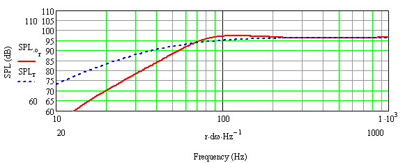

Square dimensions are not ideal, but it depends how much damping is in the enclosure. Both of the examples I did assumed a fairly reasonable quantity of damping / stuffing so it's not going to be much of an issue. Undamped or more lightly damped, it starts getting to be a problem.

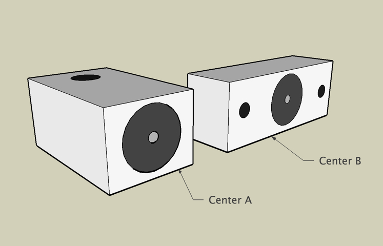

Actually, I would like to take this opportunity to ask if significant sound comes out of these semi-aperiodic damped vents? I'm asking on behalf of the Center.
I've attached 2 possible configurations for a 12in. center based on the 2.8 ft^2 volume with one 6in. aperiodic damped vent. I'd like to be able to use "Center A" which is much deeper than it is wide allowing a smaller front face.

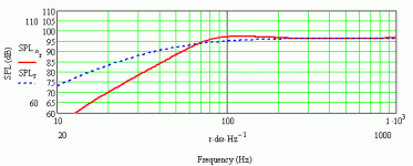

Rearranging the larger of my two TQWTs (~4.066 ft^3) yields a 14.875" depth and enough bottom end 'bloom' to probably not need any BSC:
GM
