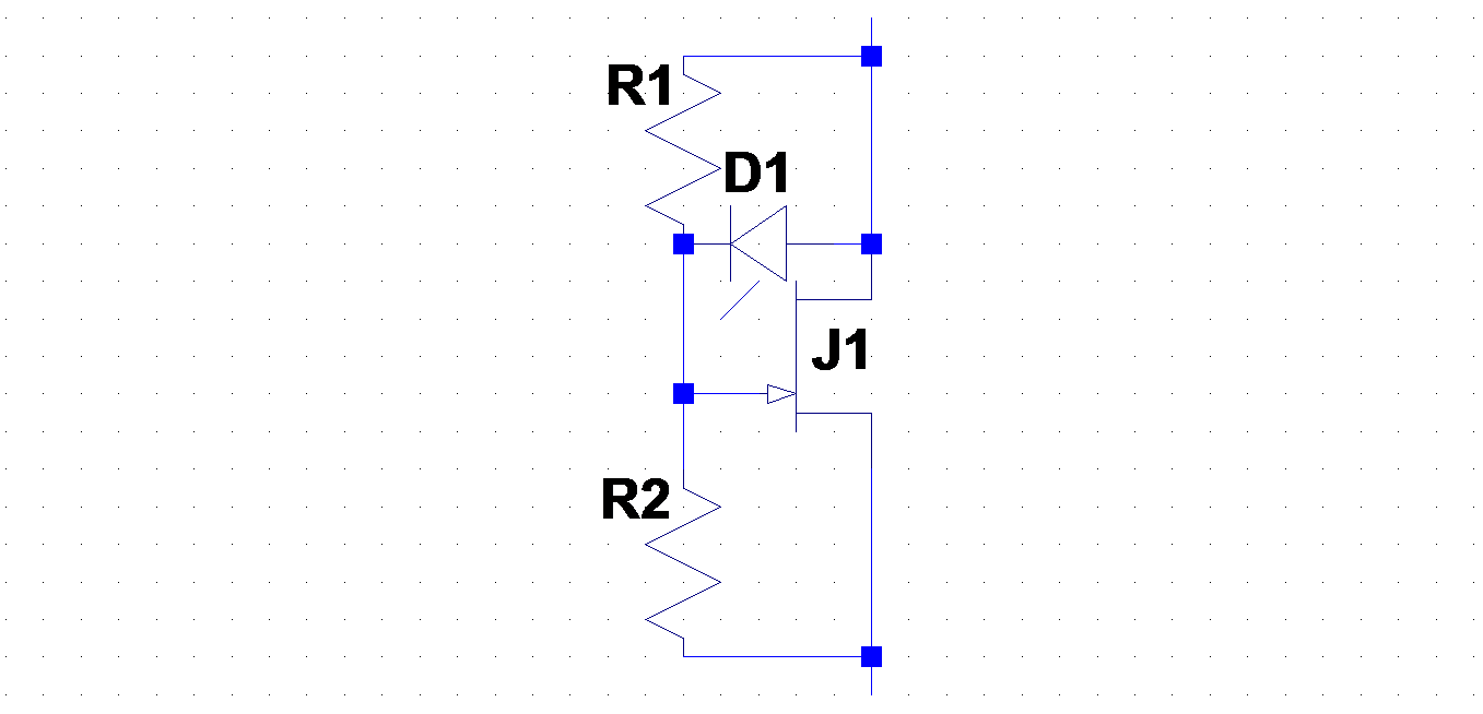

Anyone ever try this? J1 and J2 form a FET with center tapped channel...

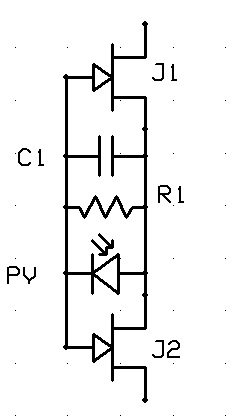

How about this? Still cancels the variable drain-source potential but saves a FET, so I can use the matched halves of a dual JFET in a classic balanced circuit that should cancel practically all residual distortion.
I have also removed the capacitor to eliminate a pole, should make it easier to optimize the leveler control loop dynamics.

Should work, as long as the diode stays a current source. It might need to go gate to source for that.

What do you think of my JFET idea in the previous post?

In practice I plan to use two diodes, one to provide an offset so that the inherently uni-polar diodes produce a bi-polar output.
Then I can balance the whole circuit and have complete distortion cancellation, to the limit of the dual JFET match at least.

Hi Dave,
Its still a bit early in the morning and I have not yet finished my second cup of coffee, so forgive me if I am confused or get this wrong. With respect to the center-tapped FET approach that you and Scott have been talking about, it is a clever way to achieve the 1/2 signal feedback to the gate(s) that we all use to reduce the FET's distortion contribution. We also know that, in practice, the 1/2 feedback does not perfectly eliminate the JFETs distortion contribution. I do not think that the center tapped FET approach reduces or cancels any more distortion than the conventional approach that uses a single shunt JFET where 1/2 of the drain-source signal voltage is fed back to the gate.
As long as the FET-based variable resistance FET arrangement has any signal across it (which it must, in order to act as a variable resistance-attenuator of some sort), the natural tendency of the FETs drain-source resistance to increase as the drain source signal voltage increases in magnitude will remain, and its effect can only be reduced by feeding back 1/2 the signal to the gate (or a value that may be slightly different than the theoretical 1/2 amount in my experience). I don't think the "balanced" or "push-pull" or "complementary" appearance of the center-tapped FET approach does anything more in practice than the classical 1/2 feedback approach. It certainly does not seem to cancel or otherwise reduce the net amount of signal appearing from drain to source on the FETs.
I have many times tried to come up with a circuit that is fundamentally better by using a dual-matched JFET to do this, perhaps in some way with one creating a replica of the distortion created by the other, but have not been successful in ending up with anything better than a well-deigned classic approach where one JFET is used with the 1/2 feedback approach. Maybe I am missing something.
