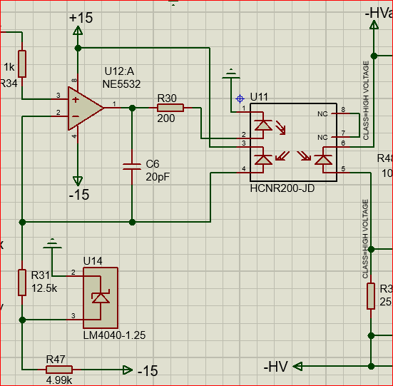

Hello David,
I thought the output diode could be used directly, as an impedance that varies for the signal depending on the primary drive. Replace the FET, not drive it.
The advantage would be that you have a linear relationship between the input drive (I think what Bob calls the error voltage) and the output diode ac impedance.
Biasing aside, on the input side you have an opamp driving the LED with the input side diode in the feedback loop. So the input side signal current varies linearly with the error voltage that drives the opamp circuit, and by virtue of the excellent matching, the same signal current flows in the output diode. So you have an 'output side impedance' linearly related to the error voltage. And unlike the FET, that impedance does not change with signal amplitude so no distortion from that part.
Jan

(Also @ Samuel) Actually, the output diode will be used in reverse mode, and the drive from the coupler will cause a photodiode reverse current linearly related to the driving error voltage. So it is just like a linearly controlled impedance.
This reverse current is basically independent of the actual signal voltage across it which is the issue with a FET as I understand.
Of course proper biasing is necessary. In one of my applications I bias the diode with a reverse DC current of 100uA and then modulate it with a linear signal into the driving opamp at 10 or 20uA RMS. Pretty much perfectly linear and no output signal dependence.
In an amplifier you'd put an R in series with the output diode to pick off the signal voltage but in this app the reverse diode can stand on itself as voltage controlled impedance.
Jan

I don't see how that would work either. You described it by saying, "the drive from the coupler will cause a photodiode reverse current linearly related to the driving error voltage." It sounds like you are saying it acts as a current source. If so, that is very different from a photo-resistor that acts as a variable resistor that is part of a voltage divider. Not clear to me how to use a current source to make a ultra-low distortion signal attenuator that would accomplish the same purpose. Maybe you could describe the proposed circuit operation a little more make it more obvious.
Think of it as a variable impedance - FET, CDS cell, reverse biased photo diode, same concept.
Being a voltage to current converter you probably need to add a sample of the signal to the error voltage that drives it. In the circuit fragment I posted, at the opamp non-inverting input. The output reverse biased diode would form the variable impedance, without the series resistor, but with a DC bias arrangement.
The main advantage as I would see it is that unlike the FET for instance, the impedance does not vary with the signal voltage across it.
There is a Spice model in the datasheet of the HCNR200 from Avago, now Broadcom. And my Spice sim is indeed not LTspice - I actually paid for mine
Jan

Jan,
Okay, thank you. So, if I understand correctly, you suggest to add the oscillator signal with the error voltage and run both of them through the optocoupler in order to change the oscillator signal level. If so, then it would seem that the optocoupler would be acting as some type of multiplier. So far in trying to understand, that makes me wonder if the distortion of the optocoupler circuit has been measured and found to be extremely low? I wonder because it would seem that the large signal transfer function of the optocoupler circuit would have to be nonlinear for it to act as a multiplier. In that case it would only be approximately linear for small signals. Or maybe I am still not correctly understanding how the circuit would operate?
OK, forget the term 'optocoupler' because I sense it has a predetermined connotation that turns a lot of people off. Just think of a black box that has an input and an output, and a very linear transfer function Iout = K. Vin. Just like a FET would have a transfer function Id = K. Vgs. You could even put a label on the black box 'FET special # 9' ;-)
I propose to replace the contents of the box with something that might be better at what it is supposed to do.
What I am not yet clear myself is this. The FET is used in its saturation region where Id = K.Vgs is no really true, if I understand correctly. Rather, in the saturation region it would be Rd = K.Vgs. Right?
So now I have my optical circuit which has Iout = K. Vin. As if you use the FET in the pentode region. Being a voltage controlled current source rather than a voltage controlled resistor. My question is then would it be possible to use a voltage controlled current source rather than a voltage controlled resistor as the level control element in your oscillator? Because if you can, one source of distortion could be eliminated, namely that the FET Rd is non-linear with regards to the voltage across it, while the controlled current source does not show this non-linearity.
So, lets concentrate on the conceptual level rather than get bogged down in circuit details. What do you say?
Jan

I think one would insert a DC bias current into the top node of the controlled current source. Like if you used a FET you'd insert a DC bias into D. Like a resistor to a clean DC supply point. Would that work with these oscillators? You could even couple the controlled cs to the control node capacitively.
BTW the larger question is can we use a controlled current as control element. The solutions with FET or lamp or CDS cell all conceptually rely on a controlled resistance. I propose a controlled current which can be made as linear as you care.
Edit the linearity of concern is the voltage dependence of the controlled element I believe.
Jan
