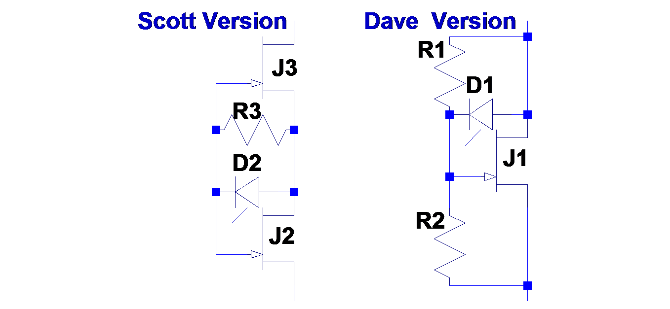

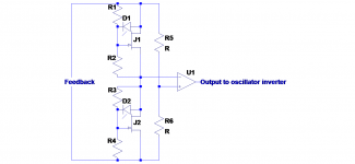

I repeated Scott's circuit in my post for convenient comparison with my circuit, but Scott's picture was in-line and came out more conspicuous than my own, which was an attachment.
So my point was kind of lost, made worse because quotes in response drop the attachments but include the inline.
So here are two attachments to clarify.

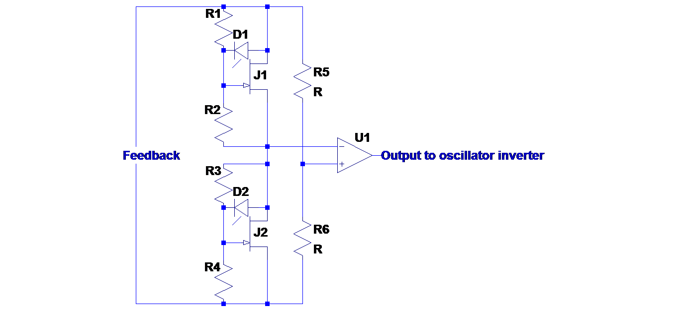

The first shows the difference between a simplified version of Scott's circuit and my circuit.
The main difference is that my version only uses one JFET, this lets me use the two halves of a dual JFET in a balanced circuit, as shown in the second attachment.
So I have the 1/2 Drain-Source cancellation on each side and then cancel any residual.
I pretty much concur with your comments, similar to what I had in mind when I came up with this idea, does it make sense?

I left out the drive circuit for the opto-diodes but it should be reasonably clear they are driven in opposition.

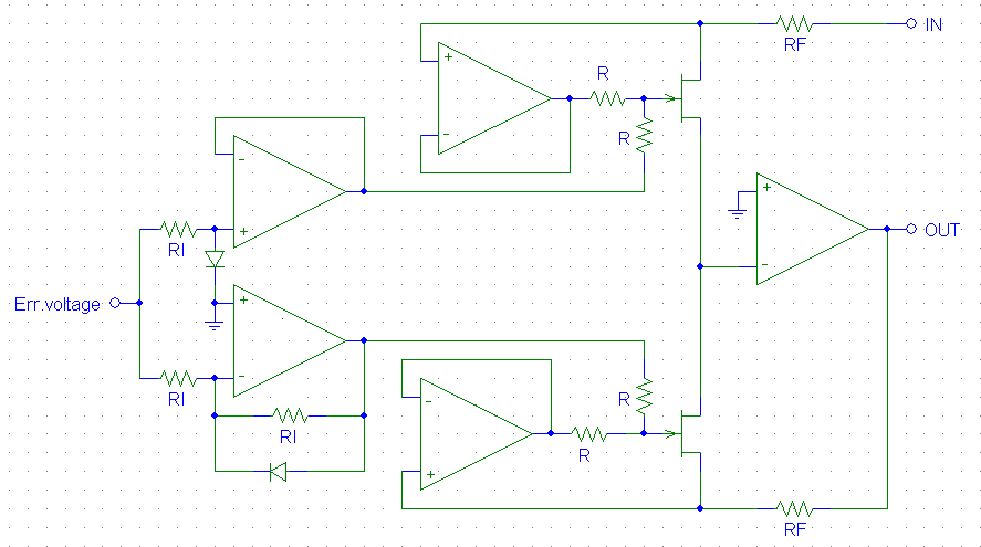

David, why you wish to use the photocells for to drive the FETs? The optocoupler can produce very small current, and this may be the cause of the high impedance's problems. Also the DC offset will be injected in the signal loop.
Balanced regulator idea is very good, but not new. Probably interesting working condition would be, when the both opposite FETs normally run in the possible maximum open mode (minimum drain-source voltage drop), and one of them goes to the little higher impedance if needed. One of the simplified implementations in the oscillator's inverter may looks that:
Victor.

Hi Victor, I only tried the photocells because it seemed a simple way to apply 1/2 drain source potential and then balance both FETs.
I realized it could be done with a few extra op-amps but I am not so experienced that I can draw circuits immediately.
So the JFET circuit was proposed for discussion first, I am not determined to use it.
I did think about the impedance issue, typical photo voltaic couplers can put out about 50 uA so the divider impedance would be around 10k to 100k, very approximately. That seems not too bad.
I did plan to run the FETs close to maximum conductance, just as you mentioned.
I even considered if it would be reasonable to run them symmetrically around zero, with forward bias on one FET junction but too small to have detectable conduction. But simpler without it I think.

In practice I plan to use two diodes, one to provide an offset so that the inherently uni-polar diodes produce a bi-polar output.
Then I can balance the whole circuit and have complete distortion cancellation, to the limit of the dual JFET match at least.

Can you? with single jFET, and 1/2v fb you really only reduce 2H. How to also reduce the stubborn 3H ??
THx-RNMarsh
1/2 JFET gate feedback reduces 3H of the agc element.

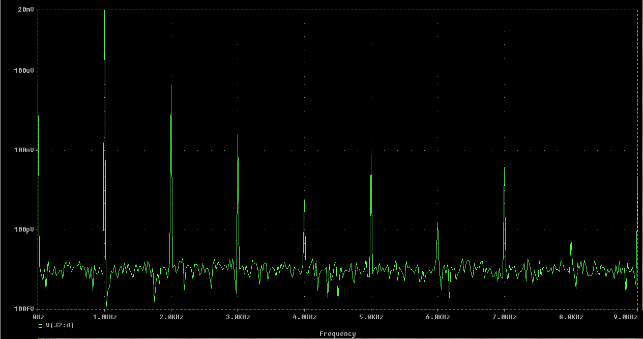

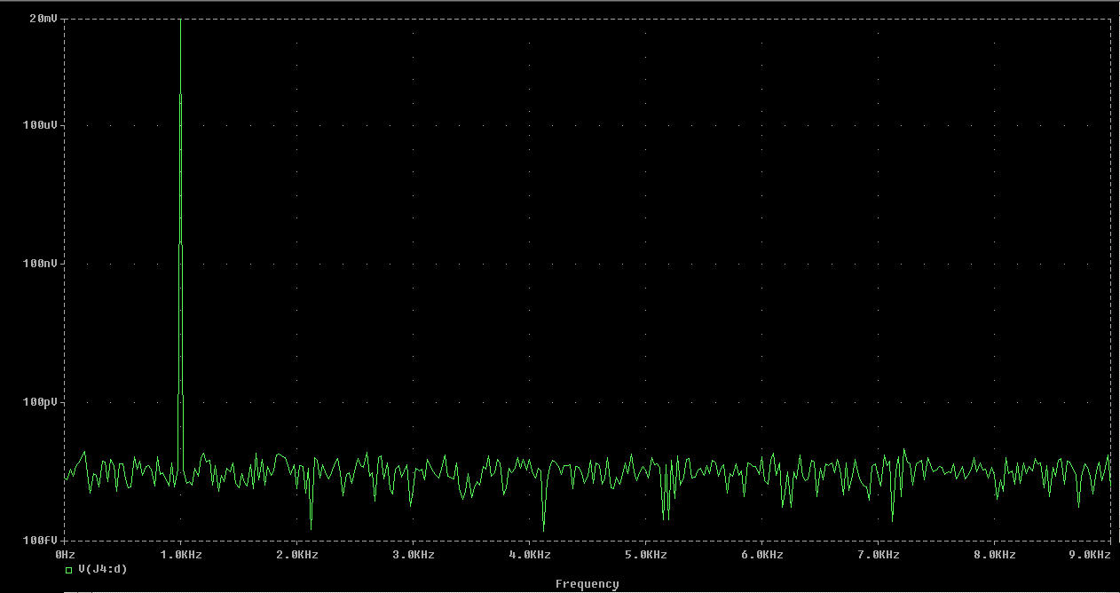

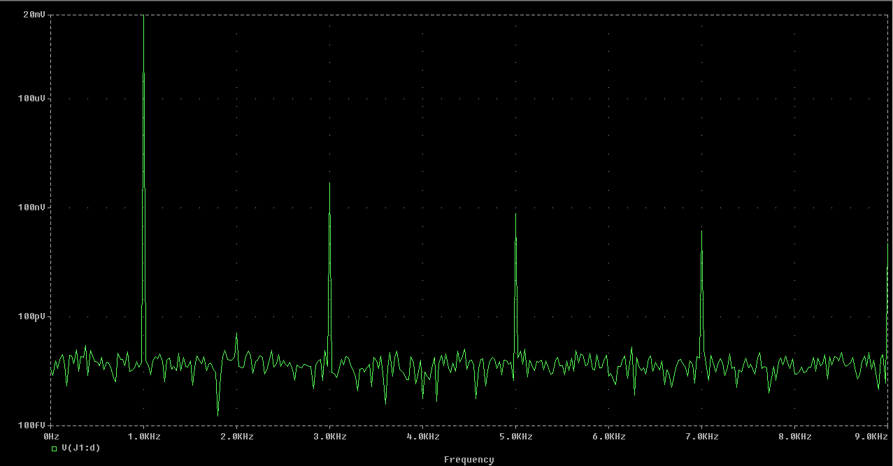

Here are the simulation results. 1kHz 20mV peak d-s voltage on every FET.
1) Without 1/2 d-s voltage on gate.
2) With 1/2 d-s voltage on gate.
3) Divider from the two identical FETs in the same condition.
This shows what I just said. with the jfet, you cannot get both 2H and 3H to null. 2H can be nulled but 3h didn't go away for my tests.... mostly with the 339A design.
So, please refer me to the circuit for (3). Is this what you have done with your gen/ossc???
THx-RNMarsh
Can you?... How to also reduce the stubborn 3H ??
I use two FETs from a monolithic dual. Please check the circuit I posted in #6821.
From Victor's description this is what he has simulated in picture 3.
I did not even simulate that section, it's clear that distortion cancellation is mathematically ideal.
The limit will be set by how well the two JFETs match in reality, for a monolithic dual this should push that particular distortion another 40 dB or so below the level already possible with Victor's oscillator.
THx-RNMarsh
Unfortunately no. This is only result from the simulator. I thought about the balanced regulator, but I have no practical realization at this time. Many problems must be solved before this type of the regulator may take effect in practice. In my opinion, this regulator is reasonable when the oscillator harmonic levels can be dropped under -160db, and also can be properly measured. If the other parts of the oscillator can't produce so clean signal, and the measurement tool can't measure it, then no reason for to use. Will be step by step a long way, and maybe in future...
Victor.

I'm having some trouble understanding what the diode is for.
Also, I'm having trouble getting past the fact that the Rds on a JFET increases as Vds increases - in either polarity - since the JFET is nominally symmetrical, and any amount of Vds increases the depletion region and the pinch on the channel with any given amount of pinch that is already there due to the reverse bias on the gate. I don't see how creating a balanced arrangement cancels out any 3rd order harmonics that remain after the 1/2 gate feedback has done the best it can to reduce the thirds.
Finally, I would caution against anyone depending on simulation for the evaluation of JFET agc distortion, since the JFET model is generally over-simplified. One example of such oversimplification (although maybe not the relevant one here) is that JFETs have subthreshold conduction just like MOSFETs, and this is not covered in the model. Overall, I think the simpler models of the JFETs transition from the triode region to that saturation region leave a bit to be desired. So in this agc distortion department, I would tend to only trust actual distortion measurements of a real JFET agc element by itself.

That's the photo-diode of the opto-coupler, used in photo-voltaic mode to bias the JFET.
LTspice doesn't seem to have a photo-diode symbol and I haven't created one yet, just drew a line to represent the "photo" bit.

I don't see how ...balance...cancels out any 3rd order harmonics that remain
It's a classic Wheatstone, any variation in the impedance of the JFET is duplicated in both arms so the op-amp sees no input.
Some third will presumably sneak in, as control is applied and balance is disturbed, but it can be made arbitrarily close to zero, subject to JFET match.

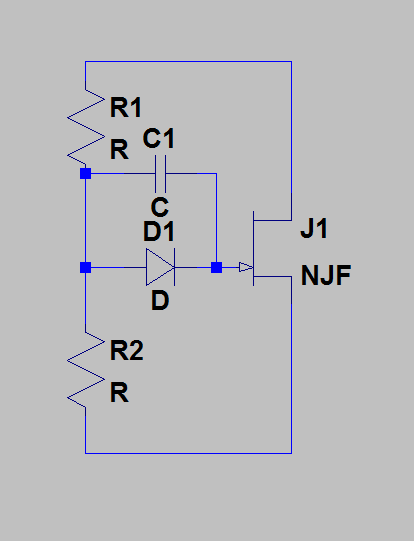

Joined 2004
Here is a small rearrangement of the PV+Jfet idea. The PV diode doesn't need to supply any current. The cap across it may or may not be necessary (not sure how noise aspects would work in this).
It can be used as a variable resistor in any configuration since no element needs reference to ground. I would add a trimmer to optimize the divider for the specific Jfet operating point. The total R would be the max desired R in the location.
Driving an LED from a level detector should be straightforward however if you use an incandescent lamp you can dispense with level detection and any transients associated with it. If you can find a lamp with a vacuum and couple it to the PV cell optimally (good thermal isolation) you would be close to what you get with a vacuum thermocouple with the potential of improved flatness. Probably would not work that well but sounds impressive.
