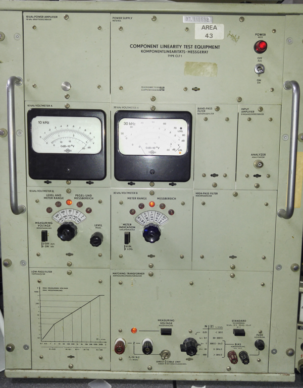

I hope you didn't think I was completely serious. However both of my Radiometer CLT-1's have a no load residual of approx -170 on HD3 (10 KHz, the only frequency it operates at) in my home lab. Its impressive but not too relevant except for its specific purpose.

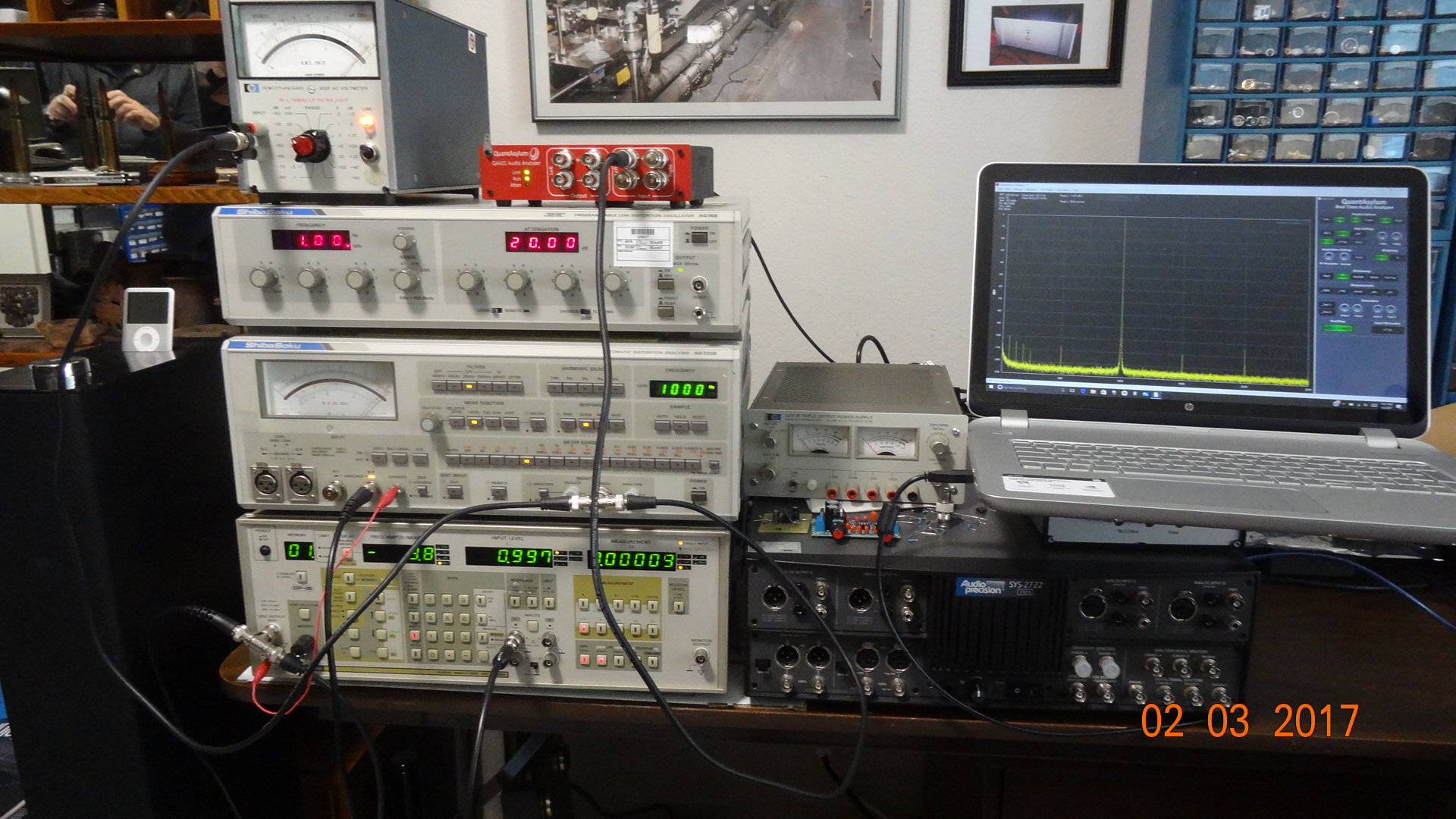

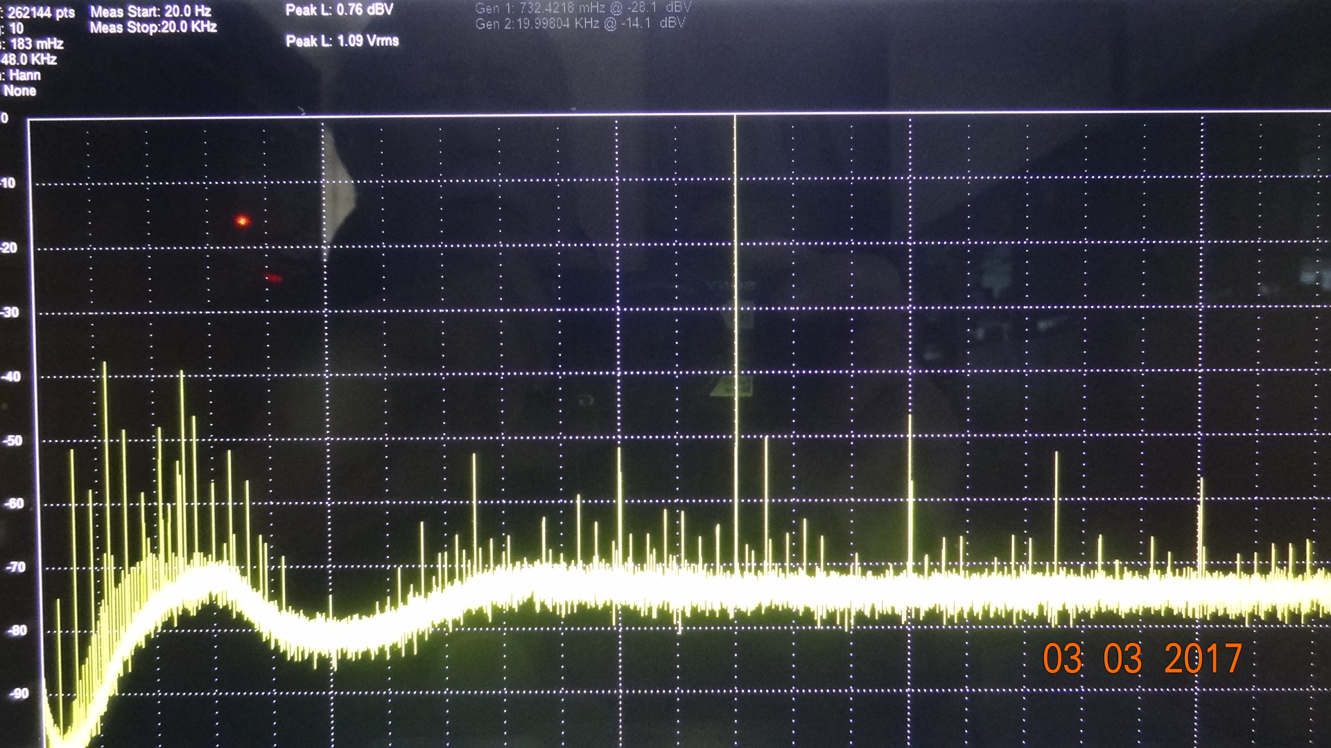

here is the 725D/QA401 analyzer test for accuracy at very low levels. At the moment, I have tested down to -90 FS range:
The fund freq is 1KHz and 1v or 0dbv. The injected freq is 2.4KHz at -90. The 725D is on its -90dbv scale. Seems OK.
[note: Using VP-7722Aas 1KHz source and ShibaSoku AG16B for 2.4KHz because of its 0-99.99dB atten, built-in]

The CLT-1 is not home lab equipment, I was referring to the notch filters and oscillator boards folks here are making. I don't recall ever seeing a single IC or audio equipment maker making even a remotely similar measurement claim with any commercially available test equipment. I'm preparing a simple post with pictures to make a few points it will be ready some time today.
