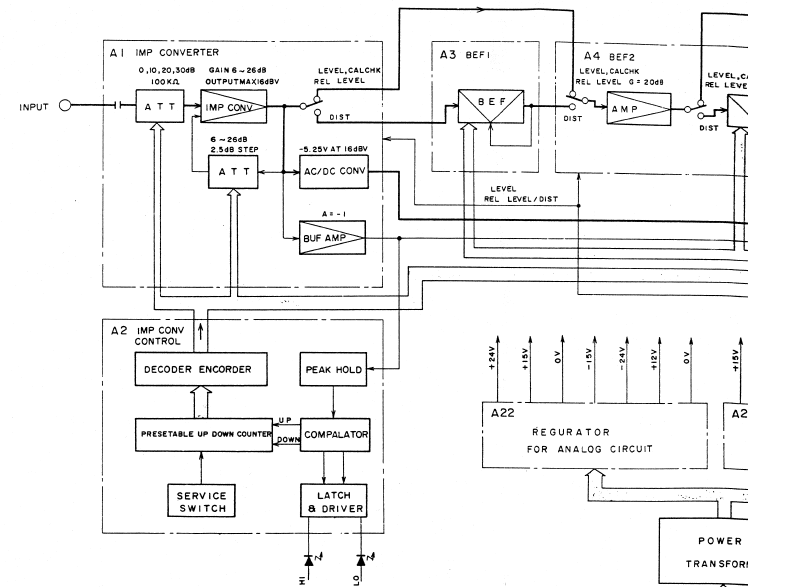

The Shibasoku has automatic input ranging. It looks at the fundamental input level and sets the input attenuation and gain of the impedance convertor (input amplifier) form that. This system is an independent circuit from the range switches on the from panel.
It sample at a bout 10 sample per second.
The operator has a choice of either automatic range selection of the front panel range switches or manual selection of the range switches. The frequency tuning of the 725 is done from frequency counter The 725 can be set to hold so the tuning doesn't change during a measurement. There is no phased locked auto tuning of the notch filters.
As long as the injected test tone is significantly lower level from the fundamental level, say -40dB below fundamental then, the 725 won't react to it. There no way a test tone equal to the fundamental level can be used.
The only difference I can see from level mode to distortion mode is the the notch filters are bypassed in level mode.

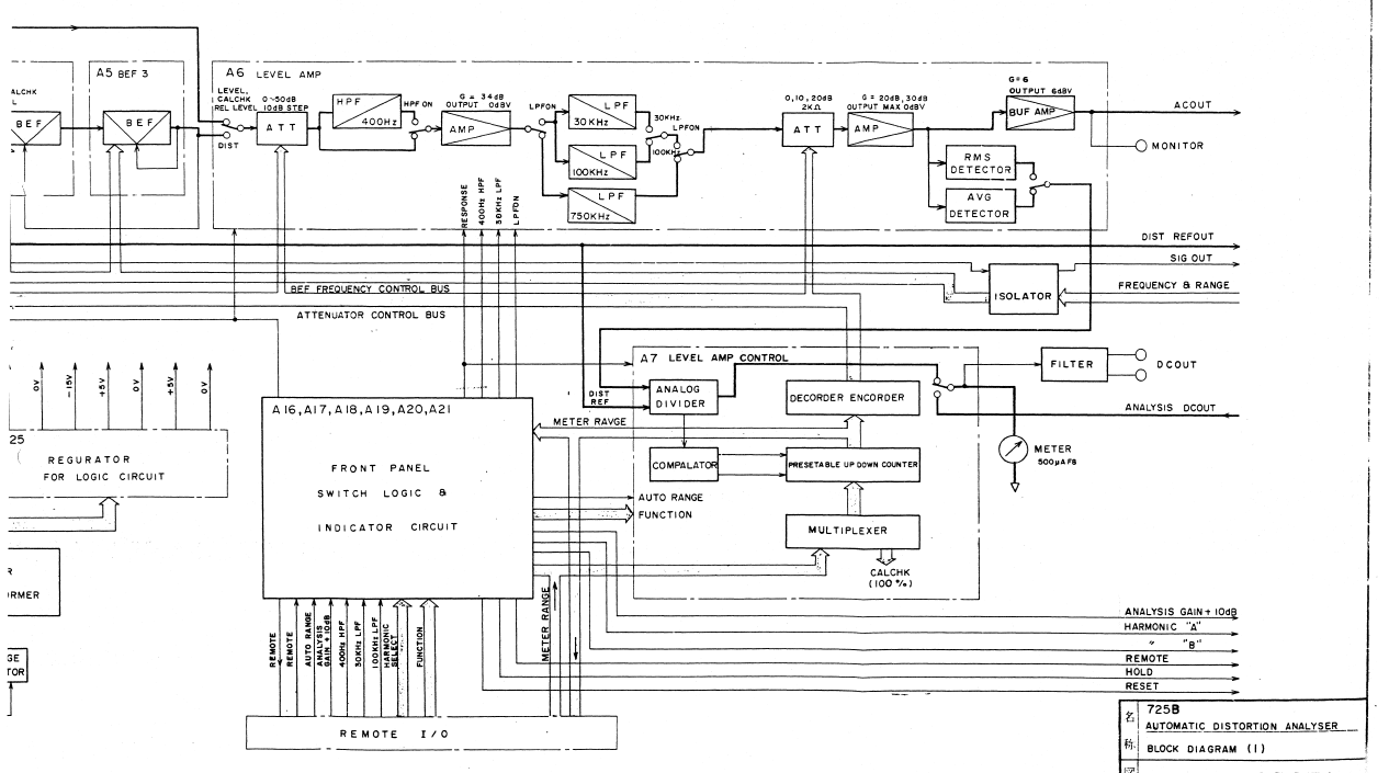

The block diagram from the operation manual doesn't show the gains of the 725 nearly as well as the service manual. I post service manual block now.
I can go through each gain stage one by one and verify the gain in level mode but it is much more difficult to do this in distortion mode because the signal are small. I would have to inject a test tone at a non harmonic of the fundamental.

The 100dB of gain is spread over several amplifier stages. Not from one amplifier.
The block diagram form service manual 725B is same for 725C and 725D.

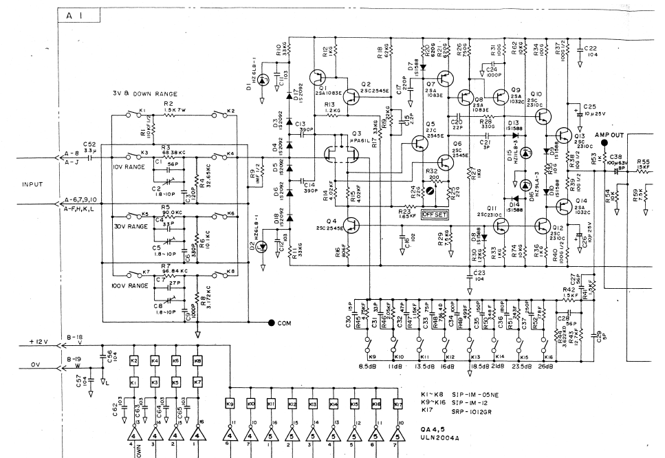

This is input amplifier (impedance convertor). Most of the gain change is done here.
All other gain stages are op amps.
Unlike the 339A and other analyzers the THD+N ratio calculation is done in the meter circuitry in DC. There is nothing done in the AC signal chain. Just gain change.

There is 1.5K in series with the input and feedback, so at a claimed 5nV noise you have already lost me. The input is 7nV noise best possible case.
