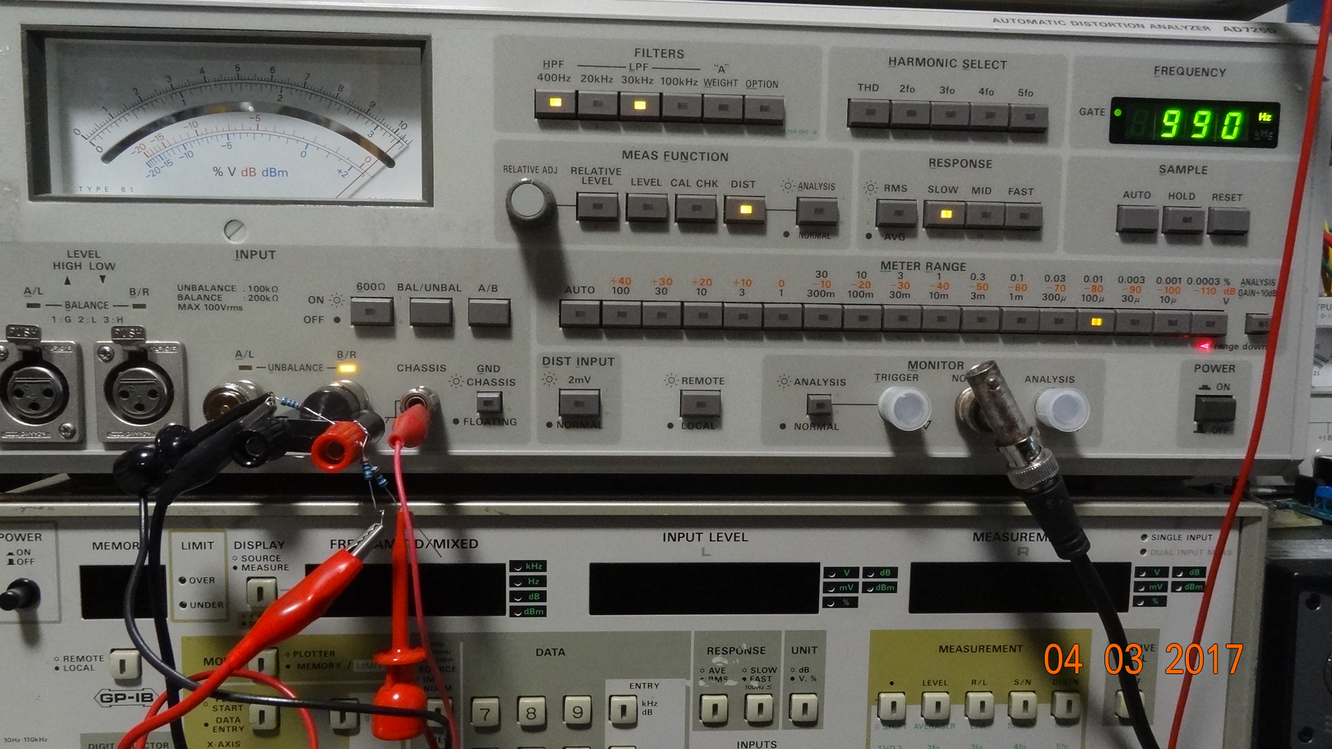

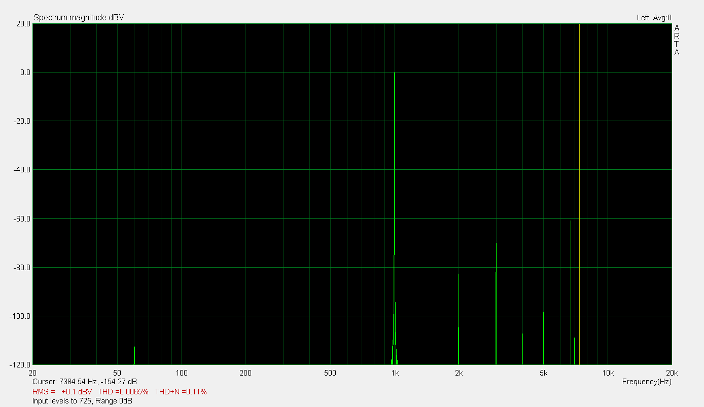

Hi Scott,
Did the scale test for the 725D.
Pic #1 is the input levels to the 725D. The Range is 0dB. The test tone is about 6.7kHz at -60dBV. I placed the cursor beside the test tone.
Pic #2 is same input levels measured at the monitor output. Analyzer is in level mode. Range is 0dB.
Pic #3 Monitor output levels in distortion mode. The lowest practical range I can use at these levels is -50dB. Therefore 0db on ARTA is -50dBV FS. The test frequency is -10dB down from 0dB FS, (-60dBV).
This is right where the level of the test tone should be.
I don't see any problems with the Shibasoku 725D. The scaling is correct.

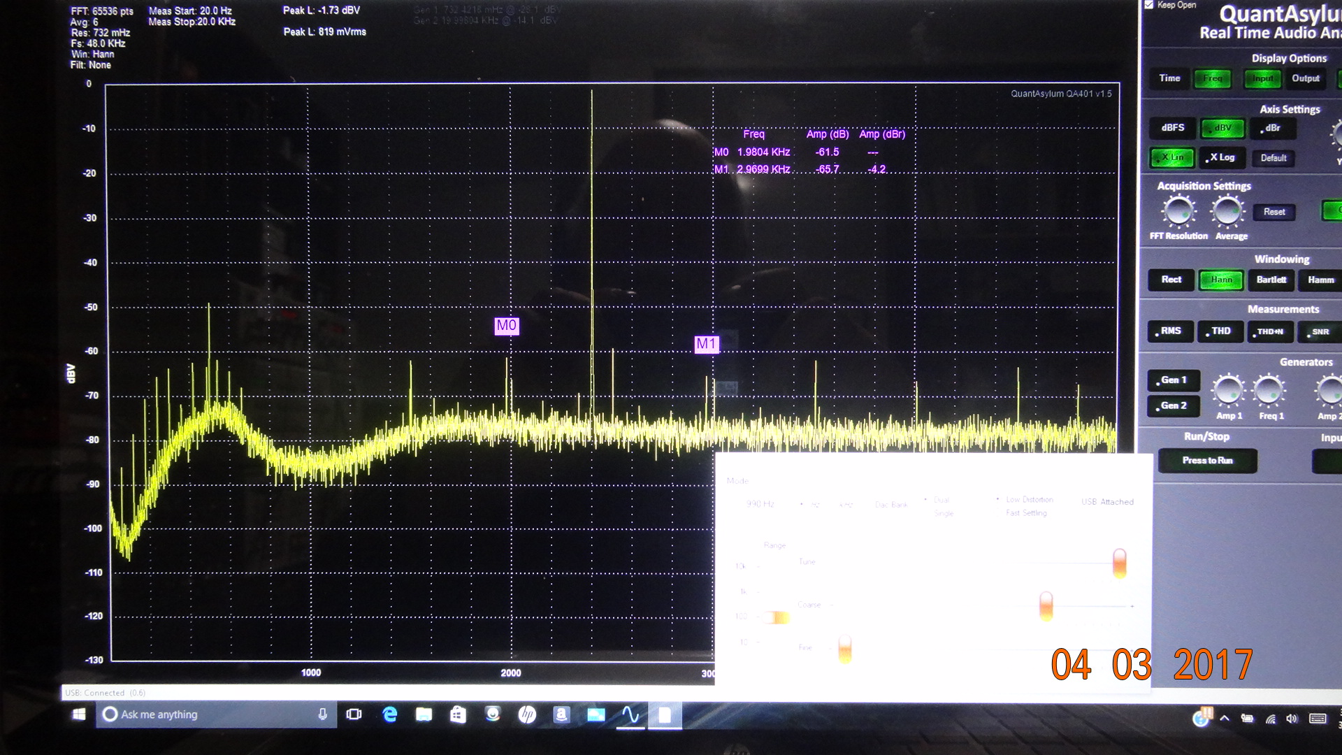

I set up my analog spectrum analyzer and adjusted the two tones (990Hz and idle tone of 2.4KHz). I made the idle cal tone also be -60dbv. The idle tone gen is the ShibaSoku AG16B with precision attenuator. I then applied that combo of signals/levels to the AD725D and QA401.
I got exactly -60dbv on PC screen for the idle tone on the 725 -60 scale. With the atten, I then dialed in additional -10dB steps and changed the 725 lower by 10dB. Same, same. All the way down to 725 scale of -80db .... see below...
THx- RNMarsh
THx- RNMarsh
Again PLEASE what are you showing here there are a bunch of numbers rattled off and I can't make any sense of it. What is the equivalent noise BW of your display and what is the rms level of 0dB. If you are saying that -80dB is really -180dB this is wrong PERIOD due to some gross misunderstanding.
geeez Scott..... you havent been following along on this subject .... 0 is always 1v or 0 dBV..
-80dBv is at the top.... shown by QA401 as 0dB. Count each division from top to bottom --- -80, -90, -100, -110, -120, 130, -140, -150 to the noise.

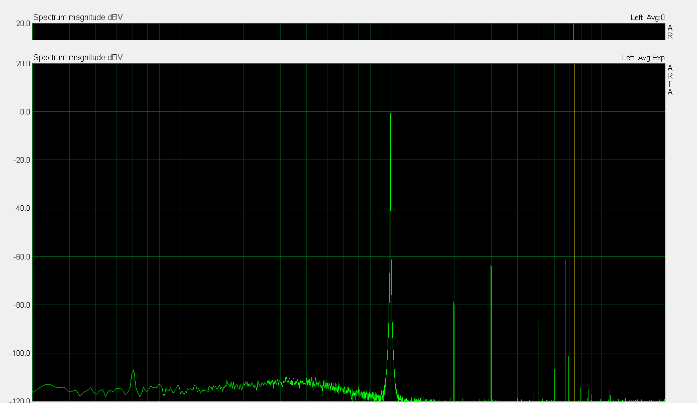

...... At -100dbv or any range it does not appear to be directly related to the noise shown on the monitor output.
With no signal on the 725 input (shorted), set to level mode only and the scale set to 1v/0dbv, the noise floor at the monitor out port ref 1v is -122db. The QA401 is considerably better, so isnt a factor on the noise shown at the monitor output. So, on this port we can have>120dB range ref to the 1 volt max output of the port.
Still with shorted input-- When set to distortion mode, the monitor noise increases significantly to -55-60dbv re 1 v max..
This is all processing/dsp et al noise, as there is still no test signal applied. It is the limit to the distortion level measurable.
However, you can show lower noise than -60 on the monitor output if there is a filter applied to that port. Such as is in common with the 400Hz Filters. The ADC/FFT is working on a signal from 0-1v.
The 725D has its Harmonics shown with the monitor output noise as scaled to the equiv of the selected scale... lowest being -100db scale.
THx-RNMarsh

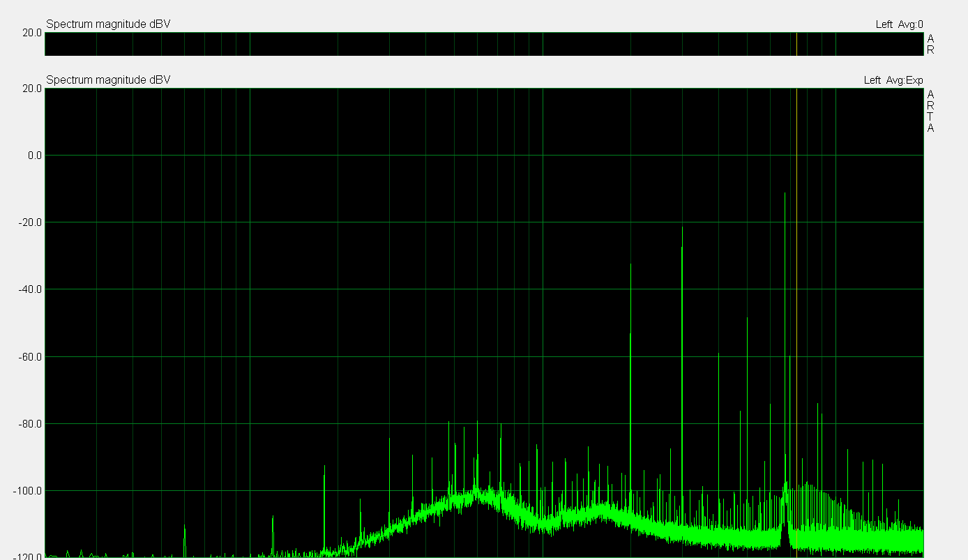

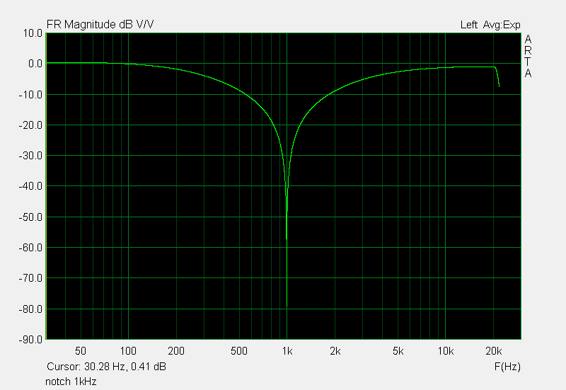

I converted my Twin T to a passive notch filter. I'm using the Shibasoku 725D in level mode to provide the gain. The following is the result of 2.5Vrms into the TT at 1kHz. ARTA 44100Hz, 131072 points, RBW 336.5mHz, BW 22kHz.
725D 400Hz and 30kHz in.. Range -90dB
Harmonic level + Correction factor
2nd -150.32dBV + 9dB = -141.32dBV
3rd not obtainable
4th not obtainable
5th -156.15dBV + 2.68dB = 153.47dBV
6th not obtainable
7th not obtainable
8th not obtainable
9th -156.94dBV + 1.42dB = -155.82dBV
10th not obtainable
Pic #1 Twin T FR.
Pic #2 spectrum
Just what we measured before.

Imaging from the Mdac in the multiplier modulated with other noise.
You can see 60Hz side bands from level modulation at the base of the fundamental.
It's a bit obscured by the noise but I had some better images of this. The fuzz is from the averaging being disturbed.
