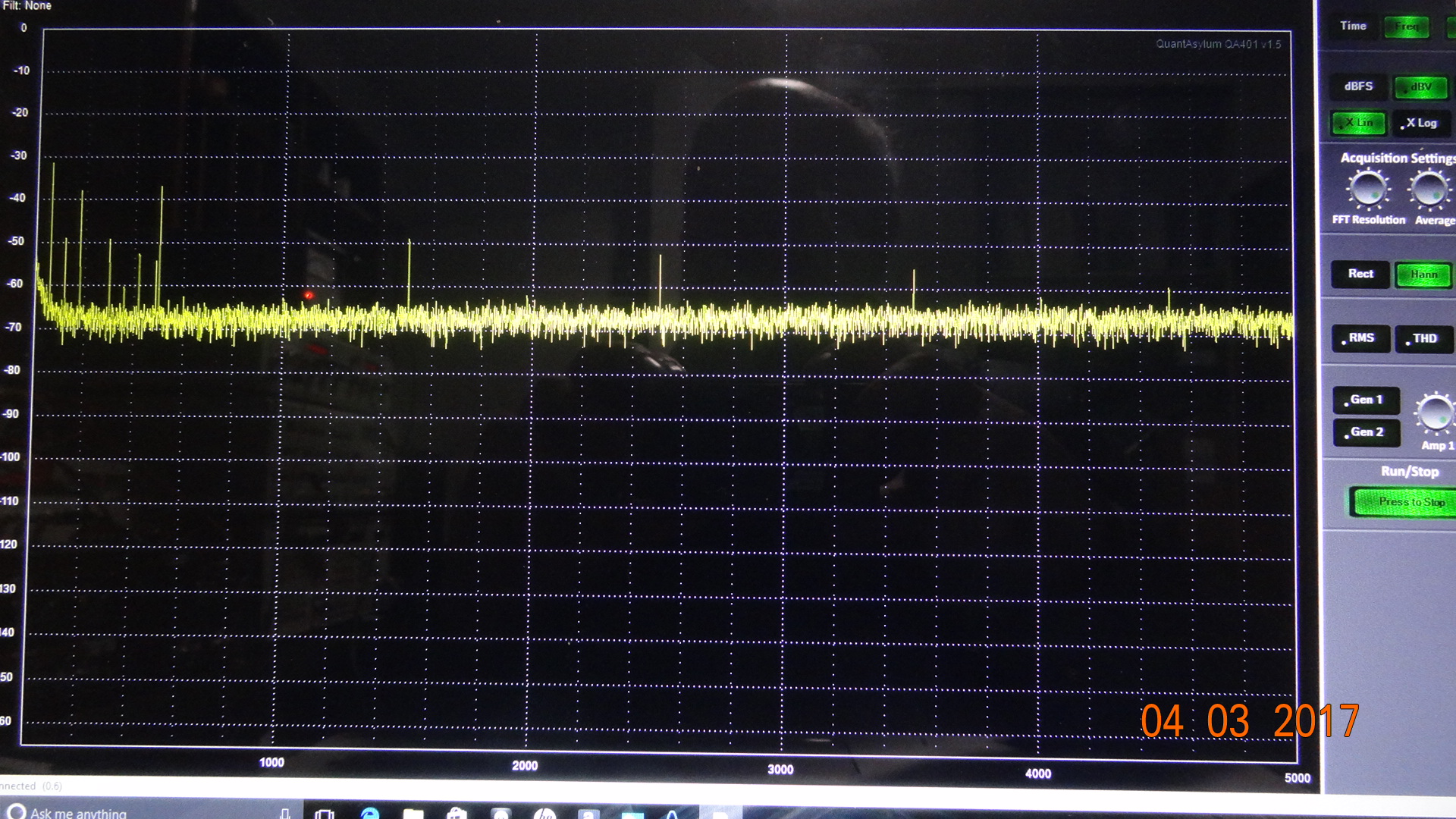

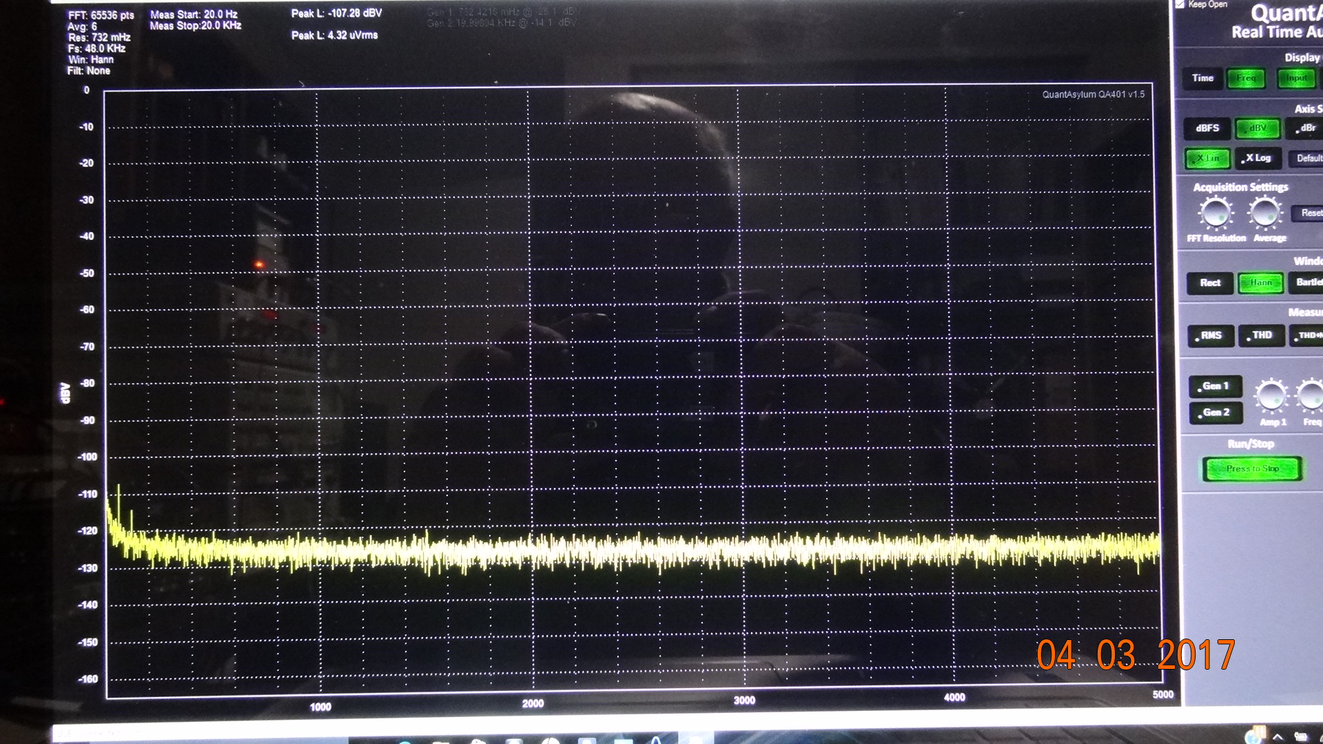

It is probably easier and less prone to error if I just measure noise with a sensitive analog ac voltmeter or a spectrum analyzer.
With QA401, first - here is the noise floor of the monitor output when no input signal processing. Ref 1v = 0dbv
And here is monitor noise but with processing (analyzer mode) turned on.... no signal from DUT;
Both just wide band random noise.
THx-RNMarsh
THx-RNMarsh
