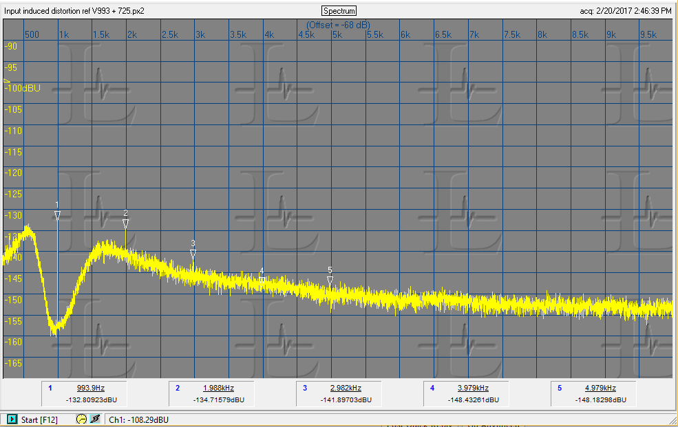

This plot is about the best I can get from the 725 at this stage. This is a 262144 point FFT and a 192 KHz sample rate with Victor's oscillator on battery power. I need to figure out how to improve the input amp.
Looks more believable, BTW as Waly said I remain disappointed that the noise averaging re:FFT's remains so misunderstood. You CAN NOT reduce the noise by averaging no matter how many averages you do, you can only reduce the bin to bin variance the mean remains the same (the noise BW of the bins always matters). Synchronous averaging of the noise in preference to the harmonics would require two matched Shibasoku's, and a lot more (see, for instance, the NIST battery noise paper posted here numerous times).

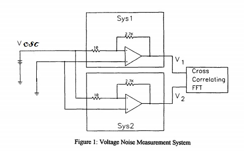

Here Sys1 and Sys2 would be two identical systems for removing the fundamental frequency.
http://www.mikrocontroller.net/attachment/100819/Measurement_of_Chemical_Battery_noise.pdf
EDIT - You added a comment, I apologize if I misinterpreted this but your comment here makes no sense to me (noise BW of oscillator?). The fact remains Dick's plot remains unbelievable by 15-20dB, a 5nV noise floor would require ~1.4kOhm total real part of source impedance in the entire notch filter and amplifier chain the Shibasiku can not synchronously average the noise.

We should get to the bottom of why there is a noise floor discrepancy in Richards FFT measurement.
The 2nd harmonic in the plot Demain posted is only 5 dB higher. The various models of 725 can very that much.

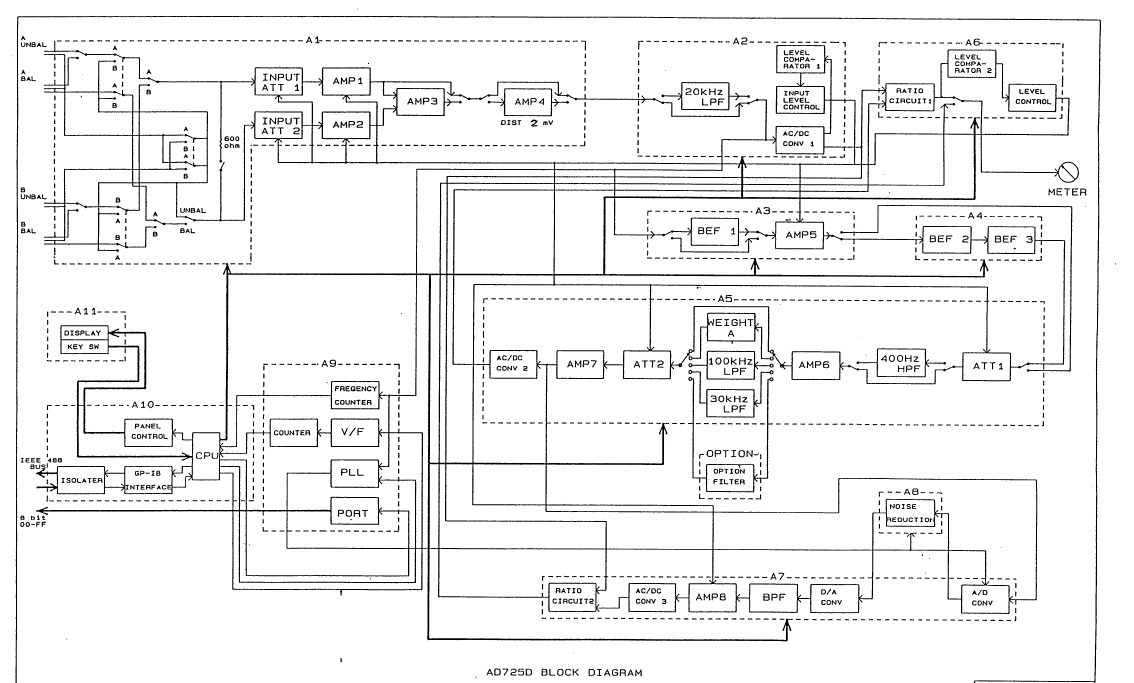

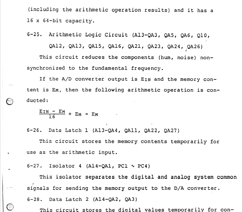

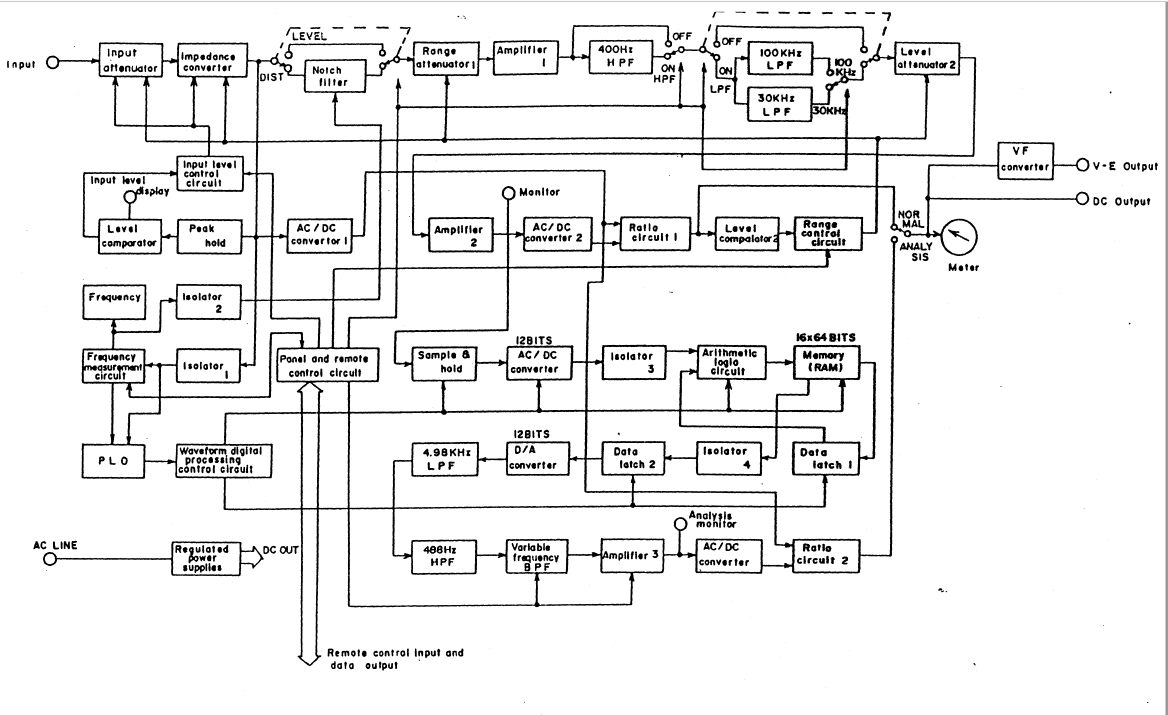

Scott here are some bits from Shibasoku on the 725 and the noise reduction system.
Two block diagrams of the 725B and 725C.
A page from the manual giving the noise reduction formula.
Shibasoku's patent of their noise reduction system.
The formula in from the manual looks like a moving average to me.
The sampler is phase locked to the fundamental. There is a counter in the PLL loop to multiply the PLL output. The PLL output generates the sample pulses. With the fundamental suppressed by the notch filters, the remaining fundamental and it's harmonics are synchronously sampled. If the harmonics are relatively constant there average is a constant. If the noise is random it is continuously averaged down.
That's my take on it.
https://www.google.com/patents/US4417310

It's more a sort of lock-in amplifier. Noise is statistically independent time point to time point so there is no self reference as with a sine wave. Another point, the depth of the noise in the notch around the fundamental (if it can be resolved) would be where you see the instruments front end noise. This would assume the skirts on the oscillator are low enough this close to the fundamental.
The Shibasoku noise reduction system is used in analysis mode. THD mode is another name for it.
Richard is not measuring in this mode in the plot posted. The analyzer is in normal mode.
THD+N. In this mode the 725 functions the same as any THD+N distortion analyzer.
The only processing is from the QA401.

If Richard's plot is normal mode from the block diagram IMO there is an error in computing the reference level.
Richard's plot does show a lower noise floor than my plots. But he is doing this with a QA401 where I'm using the EMU0204. This shouldn't matter if everything is calibrated. But it is home and garden stuff. Not intended to be a used as precision instrument.
The QA stuff is for sure not a calibrated path.
