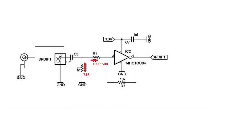

Switch-change R1 to 75ohm, R4 to 100R or 1K ..R7 to 10K or 100K...i think all the resistors are mixed in your configuration.
Yes, if the intent is to use the inverter as a gain of ~10 inverting amplifier for the SPDIF digital signal with input Z of 75R, then the resistors should be as above.
(Why is the inverter needed? The feed from the isolator is not inverted. Does the isolator invert the sense of the signal? Maybe the inverter is yet another bug.)

Assuming that the LMV7219 comparator schematic is validated and working, it looks like the 74HC1GU04 inverting-amp design may be faulty. Note that the comparator is non-inverting, while amp is inverting.

A have a few observations/comments.
1. The logic levels in figure A of post #254 seem to be wrong. The low level seems to be around 1.6V. It should be below 0.4V. I wonder what is keeping the low level this high?
2. The logic levels in figure B (with the isolator) seem to be correct, around 0V and 3.3V for low- and high level respectively.
3. In post #211 I commented on the value of R1. I guess my comment was not complete. If R1 is changed to 75ohm it should be moved to the other side of C3. A better solution is probably to add a 75ohm resistor on the input, so from the input to ground.
4. The comparator-based design will probably also work. I haven't simulated or tested it, but it looks OK. I am not sure that it will be better than the simple inverter based design though.
By the way, the polarity of an SPDIF signal doesn't matter.

The circuit in post #272 will not work. The output will probably be high all the time, because the input signal swing is only around 0.5V peak-peak. So not enough to give a high input signal, since the DC level at pin 2 of the inverter is less than 0.1V.
