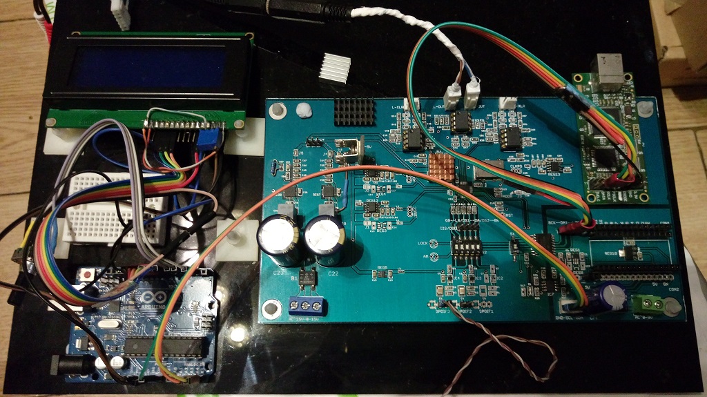

This is my almost finished DAC discussed in this thread. I added some more preregulators and i'm trying to find a good grounding scheme for everything inside the case.
The most annoying problem is when i'm electrostatically charged and discharging on dac case my microcontroller goes crazy and display shows
hieroglyphes.
I will go in details with my final configuration if there are still interested people in this subject.

Is anyone able to give me some hints about grounding ? I have some parts of the DAc wich are completely isolated from the others and i dont know how to proceed. For example the USB>I2S interface has an isolator and USb side is completely isolated from DAC side. Also the Arduino part is completely isolated from DAC.
Also when i am electrostatically charged and touch the DCA case the display goes crazy and also Arduino.
If needed i will draw a diagram for easier understanding.
I don't have the electrostatic issue but my worked until I one day the last opamp starting to heat up and output are highly distorted ( I am only using single ended output). Something is oscillating after working for few days and I also ran out of idea. Now I am kind of leaving it alone for the time being and will get back to it when I have the mood.
P.S. The arduino ground is very sensitive to where I connecting LCD display ground, the rotary and the power ground.
attach is my dac with help from the original designer.
