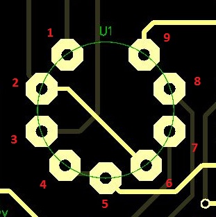

Just in case - looking at the tube from the top (e.g. through the tube), this is the right pins numbering.
There's the problem. I numbered them clockwise from the top view. Looks like I need to mount the boards upside-down.

Yeah, the easiest way is to put the tube on the other side of PCB...
This upside-down board thing is adding a whole new twist to the sport! voltage is pretty close on R3 and R10 when I first flip the board over to measure. I think I'm watching the tube cool. It drifts all over the place when they are upside-down. They quickly settle when right side up.
I tried to figure out how I managed to have voltage on the input of these. With the tube installed backwards it looks like the input would have actually been an output. It must have oscillated to actually put out voltage. Did a good job on my scope! Pushing 250V back into the signal generator didn't go well!

I've assembled a set but never have debugged them yet. The tube layout is backwards so the socket needs to be mounted on the bottom of the board.

I did see that the tube socket was reversed. I was looking at the board and it looks like most of the parts could just be mounted on the bottom as well. I'm thinking only the IC would have to be mounted on the silk side so that is not a deal breaker. I have only scanned through the thread so far.

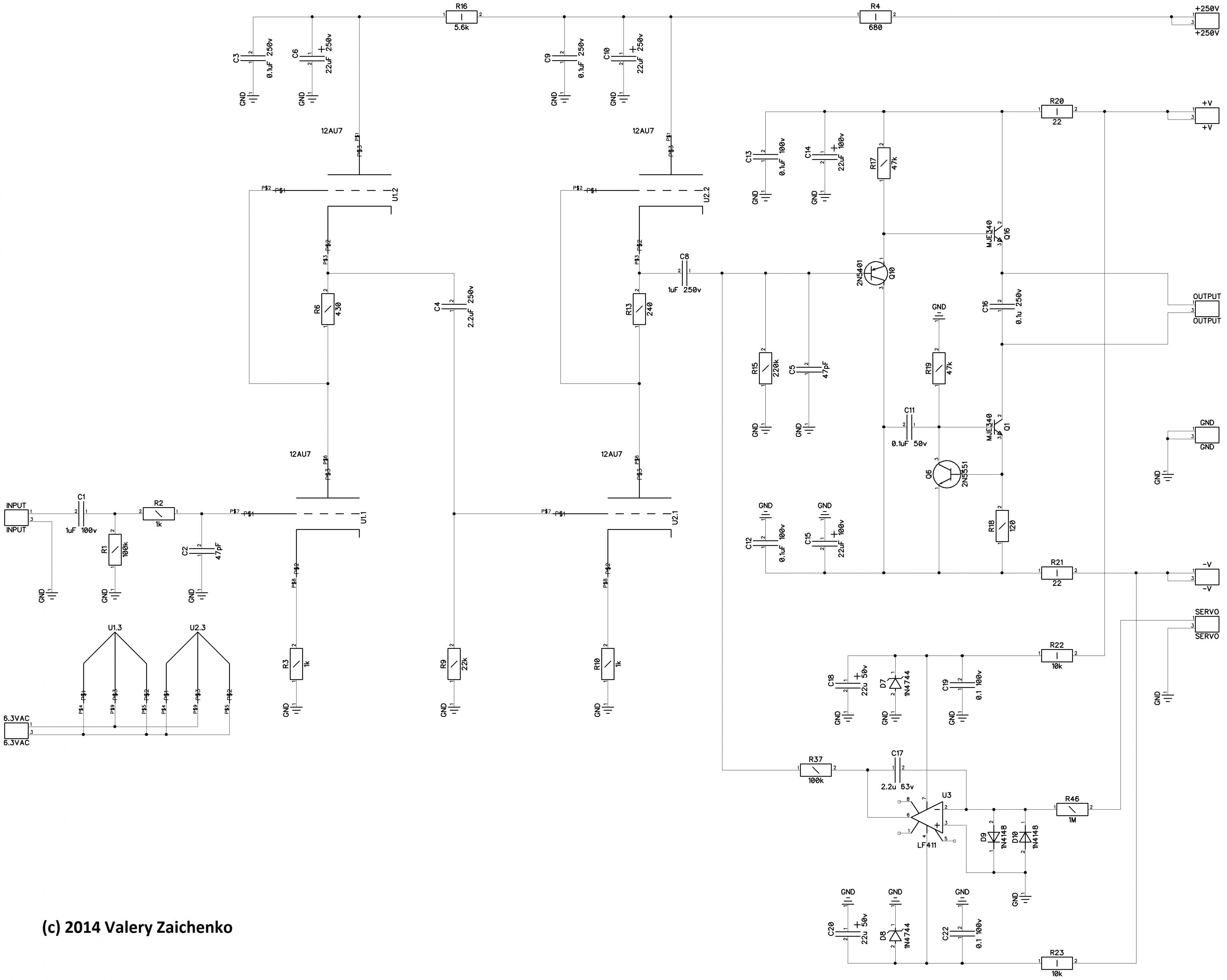

1) Is there a schematic that matches the part numbers for your layout?

Hi Terry, I've got a well-working prototype, built with my initial layout, as shown >HERE<. Tubes are at the top side then.
If you've got the boards with Jeff's layout, then the tubes must be placed at the bottom (upside down).

No problem, Jeff's boards are nice, we just understood at some point that he's got the tube pins numbered in opposite direction.
Transformer I use is a small 15W toroid, giving both 240V AC (0.05A) and 6.3V AC (1A). Designed for tube guitar pre-amps.
The layout matches the schematic. The orientation of C15 and C20 are backwards on the silkscreen. I'm still getting used to designing a layout with a negative rail so I get the orientation reversed often.
The bridge is a 2KBP. Go for a high voltage one. Q4 and Q6 can get warm. They should have heat sink.
