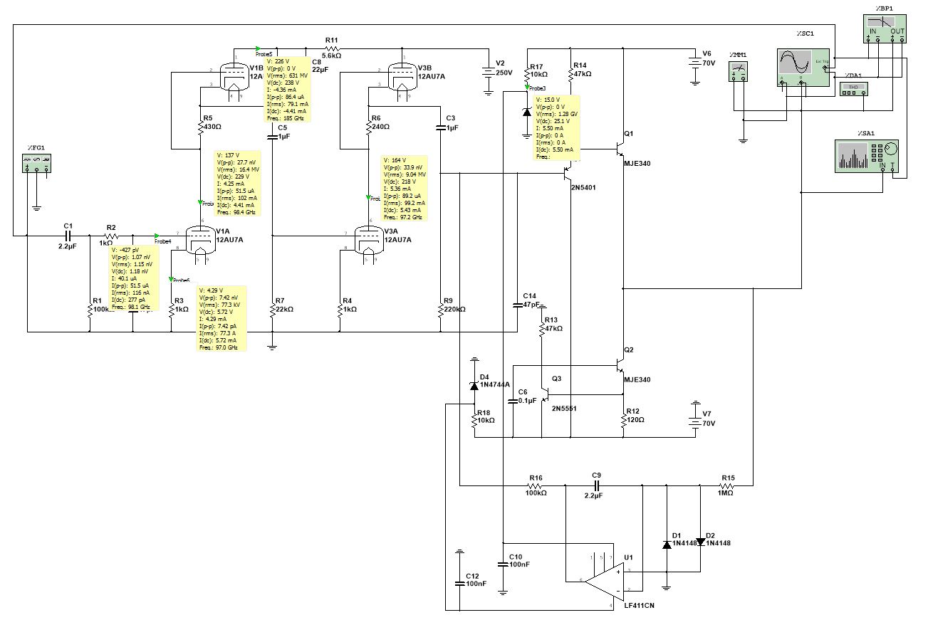

I'm back to getting these things running again. Do I need extra drive current on the input to these? My test signal from my scope drops to zero volts like a short as soon as I install a tube.
Hi Jeff, no - if it's built according to schematic as shown in >Post #35< - it just works...
What is your scope connected to?
I have my signal generator and scope both hooked to the input. As soon as I install a tube in U1 my input voltage goes to zero.
Something is wrong... the tube has got high input impedance, so in general it doesn't influence the signal. What are the voltages at the grid, cathode, anode (pins 7,8 ,6)?

My tube connections are opposite yours. 1 = 238V 2 = 238V 3=0. My supply voltage is sagging to 238VDC when I connect a meter.
Jeff, see the key measurements here (attached). Grid is almost zero, cathode is +4.29V, anode +137V (may slightly vary)...
My components are a little different. C5 in mine is 2.2uF. I'll try to work through it and figure out what is up. The high voltage on my grid and triode don't look good. Thanks.
Yes, it looks like shortened grid-anode... very strange
