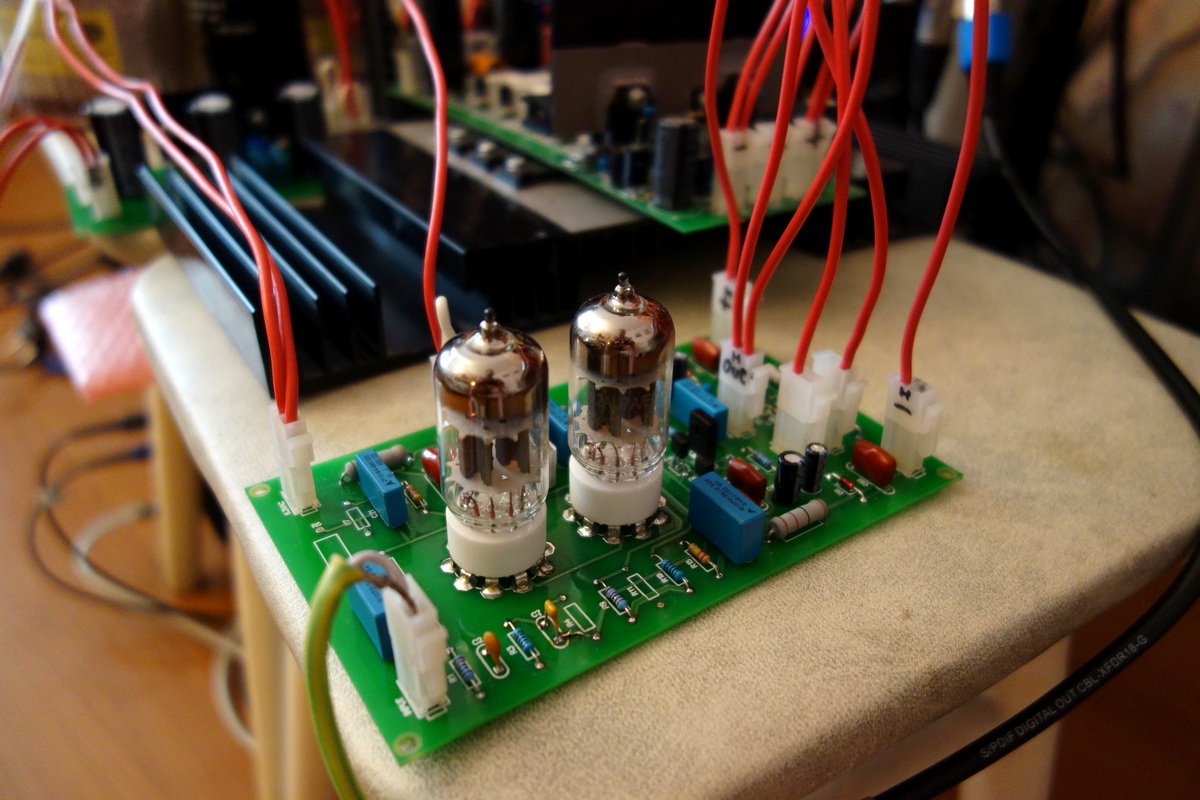

Terry, nice - creative approach with PCB upside down and the parts on the back side
247V is absolutely enough. Slightly rounded corners closer to 20KHz are also ok - having no global NFB loop, this design is neither super-wideband, nor super-fast. However, it performs very well within the audio range and I hope, you will like the sound.

Ok, I got a chance to hook up the boards to the Slewmaster OPS. It oscillates. It will sort of behave with no input and no load but as soon as I touch either PD+ or PD- with a probe, it will start to oscillate. I was actually able to get it to play a sine wave and square wave with no load on the output but at times that would cause oscillation too but with a load attached it goes almost instantly into oscillation. I'd like some ideas on where to try some fixes for this.

Oscillation looks really strange with this particular design. Normally, the reason for oscillation is the phase reverse in NFB loop at some high frequencies. No NFB loop - no oscillation.
The only signal, coming from the output, comes via DC servo. it is very slow by design, but... potentially there may be some artifacts, related to OpAmp stability. Can you try to run it with no servo installed (and no load for the time being). There may be some offset, but that's ok - let's see if it influences oscillation.

I initially started up it up through a light bulb. Looked pretty good but as I said if I tried taking any voltage measurements it would start oscillating. The light bulb would do its job and lower the current. I then hooked it up without the light bulb and would hear sizzling as soon as it would oscillate. I shut it down in time to avoid any damage. I think it is close to working, just needs the proper compensation. Maybe it won't work with the Slewmaster but it would be nice if it would.
I still use it with 3-pair MosFET Slewmaster-based OPS with no sign of a problem. Interesting...
I haven't tried it with my MOSFET Slewmaster. I'll try it first with the servo removed and report back.

OK, here's what I found. I pulled the servo. Offset is 24mv so not bad. I'm still using the light bulb and have the rails about +-42V. With no load attached it is still a little sensitive to a touch of the probe on the PD- but only very shortly and then settles. I have the bias set low for safety while I do this. I have 10mv across a pair of 0R22 emitters. With a load attached it actually seems more stable. It doesn't appear to be oscillating now but the weird thing is I am reading about 20V on PD+ and -20V on PD- where I would normally see 2V or less. The bias has not gone up though.

The deed is done. I dug a little deeper and found some 470p caps and soldered them to the lugs on the bottom of the boards. No more oscillation just beautiful music. Had it playing for about an hour now and everything is stable. Hopefully tomorrow I will set up another Slewmaster with a different IPS and A/B them. I want to give it time today to let the caps settle in. I don't have a protection circuit hooked up right now so I have to be careful how I start things up. It doesn't like having a load on it when starting. Speakers need to me disconnected during start up. It doesn't have a large voltage on the output like the Low TIM hybrid but it doesn't want to settle with a load attached. This was a fun one with the challenge of the board layout but it looks like it's going to be a keeper.
I'm running it at +-72V rails right now and it isn't breaking a sweat.
