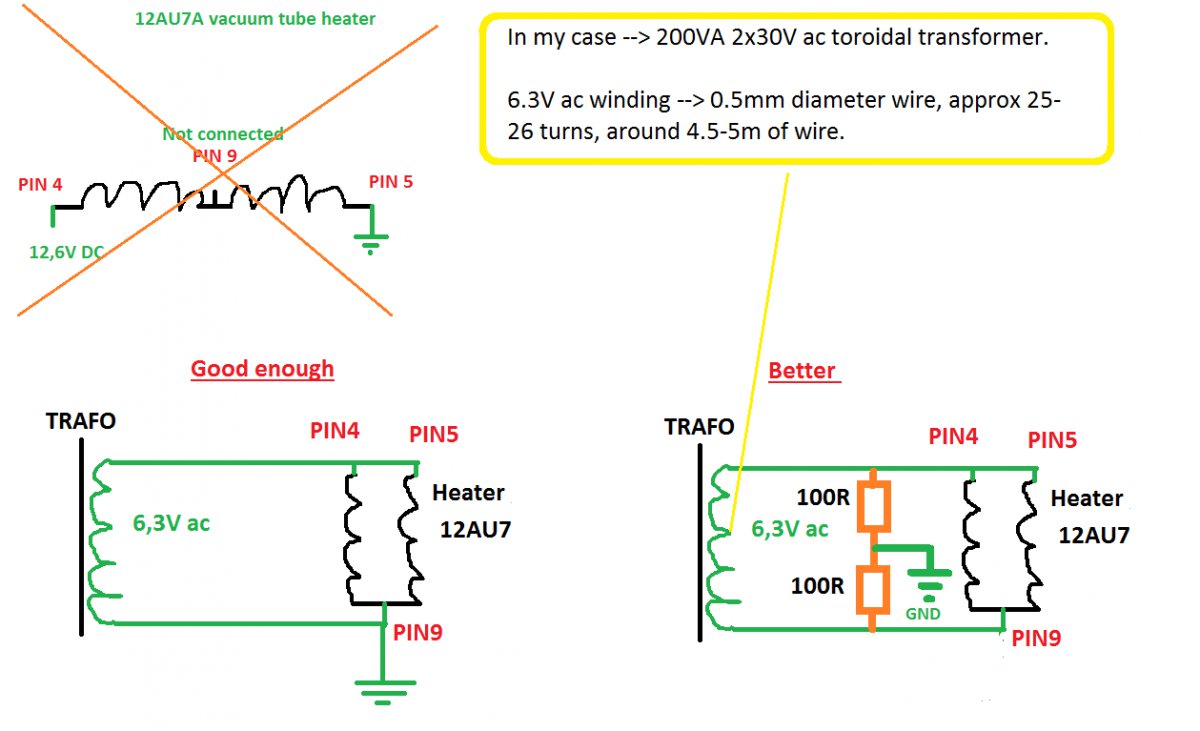

In the quest to find the answer I left the test speaker plugged and tried unplugging each transformer. Unplugging the rail transformer didn't change anything but unplugging the small 230V/6.3V transformer stopped the hum. So now I'm going to try using a separate transformer for the 6.3V and see if that changes anything. I'll report back.

OK, this is what I have discovered. This morning I decided to hook up only one channel to see if maybe they were reacting with each other. No luck, the hum was still there. However, while moving things around I touched one of the open 6.3V wires with my finger and the hum all but disappeared. This transformer has dual secondaries for both 230V and 6.3V. I am only using one of the 230V pairs but both of the 6.3v, one for each IPS. So next I tried just grounding one side of the open 6.3v leads through a 10k resistor and the hum is now only barely there. Looks like it is the 6.3V circuit that is causing this grounding problem so now I'm asking what is the best way to ground this to do away with the hum without hooking something up wrong.

I am using heater connection as bellow.
Regards Peter

I think there may be a safety issue if you ground the 6.3V because of the close quarters with the 250V in the tubes. I think it's supposed to float.
Ok, using Bory's suggestion above except I used two 10k resistors where he shows 100R and it worked. The ground hum is gone. With my ear right next to the speaker there is a little noise but no ground hum. That little bit of noise may just be because of all the open wiring running all over the place. I'll hook up the other channel now and make sure all is good.

I figured you didn't have any hum which is why I've been concerned. The only way I could find to get rid of it was to use a separate transformer for the 6.3v. That is of course, until I tried Bory's approach. I'm not sure why my Antek transformer is reacting differently than yours. I am actually seeing about 6.7V on mine so I may try lowering the values of the two resistors until I get closer to 6.3V. I am really looking forward to A/B'ing this against some of my other amps. I may actually be able to hear some real differences.
Blessings, Terry
EDIT: I just changed the resistors to 100R and there was no change. Still 6.7vac but everything seems nice now so I will just leave the two 100R in there.

Put the resistor in series with the paralleled heaters.
Having around 600mA through the heaters (2 tubes together), we want to drop 0.4V, giving us 0.4/0.6=0.67R
Dissipation - 0.4*0.6=0.24W
So, let's do some rounding (R - a bit lower, W - a bit higher), giving us 0.63R / 0.5W
In fact, you can try 0.47R, for example, and see the result. You don't have to try getting 6.3V exactly, just getting closer to it is ok. As I mentioned, even 6.7V is acceptable.
Valery
P.S. Jeff had it at 7.5V initially, which was a bit too high - that's where this point came from...
