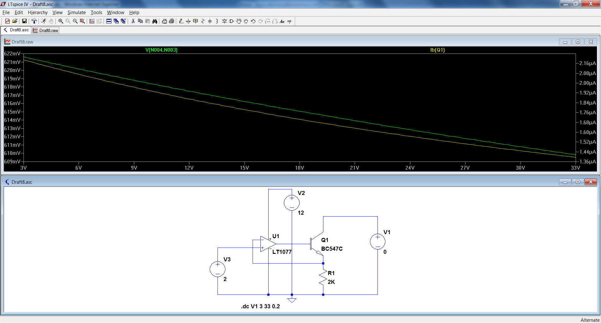

In fact, the Vbe variation is a secondary consequential effect of the prime cause, which is the Hfe variation.Previously, glaring at the Early effect equation did not leave me any the wiser about the relationship between Vce and Vbe. Things are making more sense now however, so I pulled the Early effect equation inside out in order to plot theoretical Vbe vs Vce at constant Ic. I used parameters from my BC337-40 model.
X axis is Vce. This chart shows that at 1Vce, Vbe changes by about 246uV per volt Vce. This corresponds to a PSRR of about 72db which lines up with my experience.
This can be demonstrated in this simple "thought experiment": in this circuit, the collector current is kept constant to ~10e-3.
The transistor belongs the C group, meaning highest Hfe for minimal current error, and also highest Early effect.
For a 1 to 31V Vce variation, the base current changes from 2.2µA to 1.4µA, while at the same time Vbe changes from 621.5 to 610mV.
26*ln(2.2/1.4)=621.5-610, thus everything falls nicely in place
