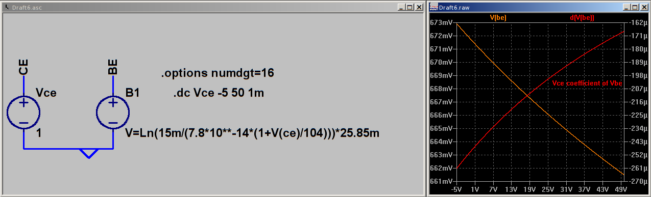

That's the opposite of what I was saying, although I'm happy you volunteered. What I want to see is a Vce vs. Vbe graph, for constant Ic.

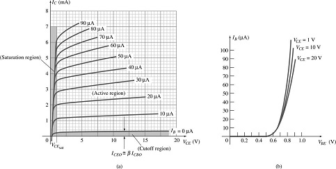

There apprears to be a lot of SIM curve tracers to play with. But is this kind of info you are looking for...?
THx-RNMarsh
Previously, glaring at the Early effect equation did not leave me any the wiser about the relationship between Vce and Vbe. Things are making more sense now however, so I pulled the Early effect equation inside out in order to plot theoretical Vbe vs Vce at constant Ic. I used parameters from my BC337-40 model.
X axis is Vce. This chart shows that at 1Vce, Vbe changes by about 246uV per volt Vce. This corresponds to a PSRR of about 72db which lines up with my experience.
