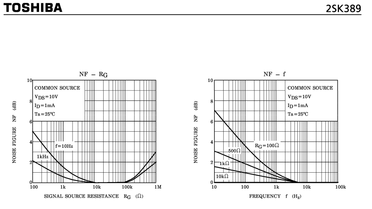

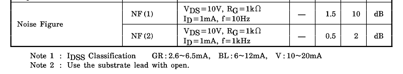

The 6 KHz 1/f corner and best noise match between 10K and 100KOhm really
promises excellent voltage noise behaviour below 10 Hz. No, not really.
Note the huge spread between typ. and guaranteed.

Which do you recommend?
Hard to say. FETs shine at high impedances and generally have higher 1/f corners.
If you want 2nV/sqrt Hz, that is the noise voltage of a 240 Ohm resistor.
So your source must have less Ohms or you have already lost, even with
an ideal transistor. Transistors that need high source impedance, say > a few 100 Ohms
to avoid adding noise power are therefore no good choice. The 2SK389 is best
at 10 to 100K or so. The noise figure diagram says how much you are punished
if your source imedance is too high or too low.

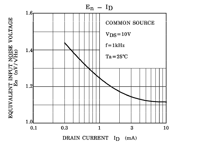

For FETs the white noise is determined by the ratio of gate capacitance and gm.
One always can parallel more transistors, gets bigger gm and less noise.
That is done already on-chip with the Interfet devices, but the C goes trough the roof.
The c/gm ratio of the BF862 is outstanding. IIRC, someone here on diyAudio
has built a monster with 32 transistors or so. I think he needed a small inductor
in the gate connection of each 4 transistors to avoid oscillation.
If it has to be FET, that's probably what I would do.
BF862 are cheap and seem to have a low 1/f corner, at least for the FET league.
But since your source resistance must be < 240 Ohms a priori, the FETs small
noise current is no real advantage.

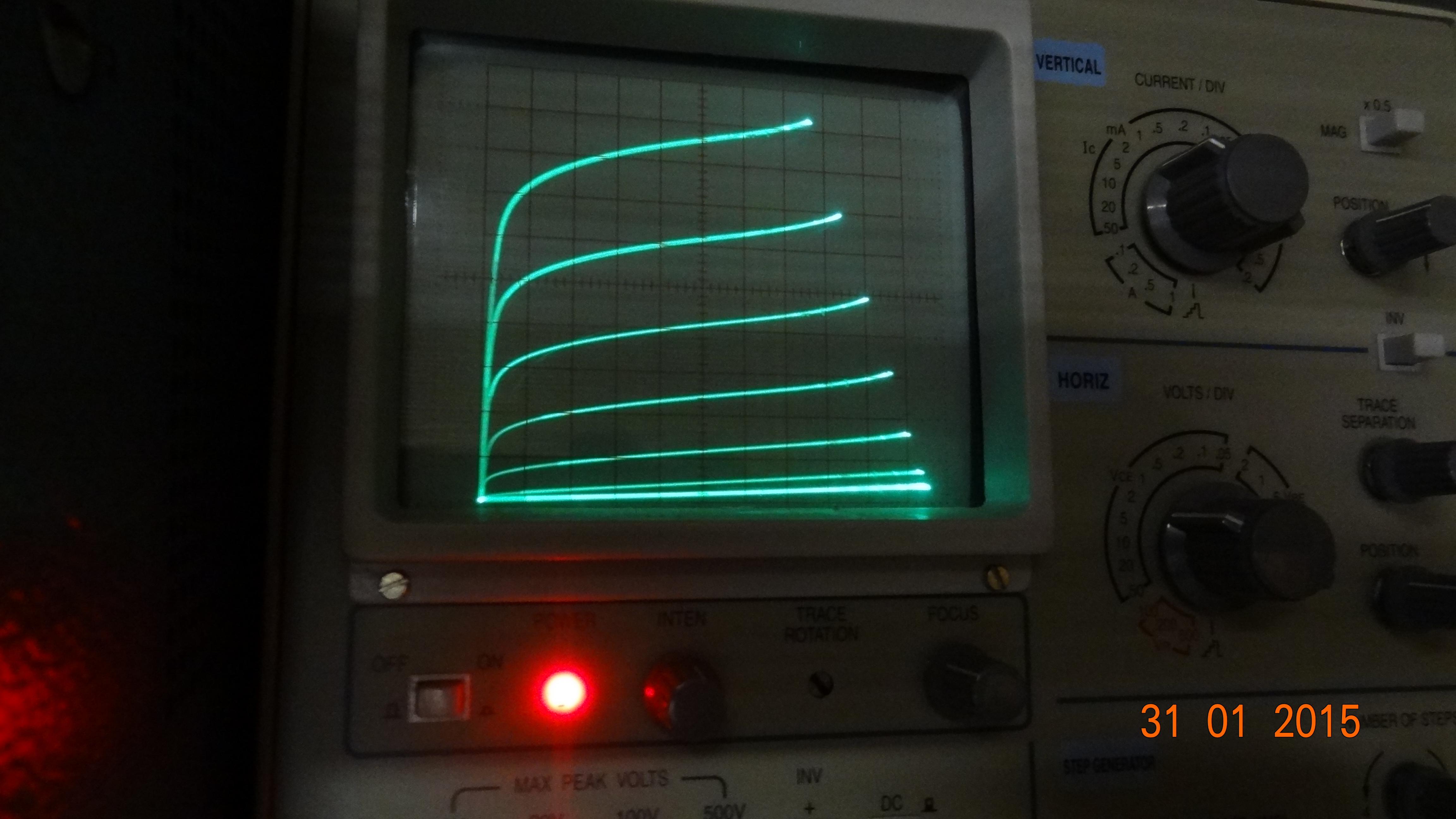

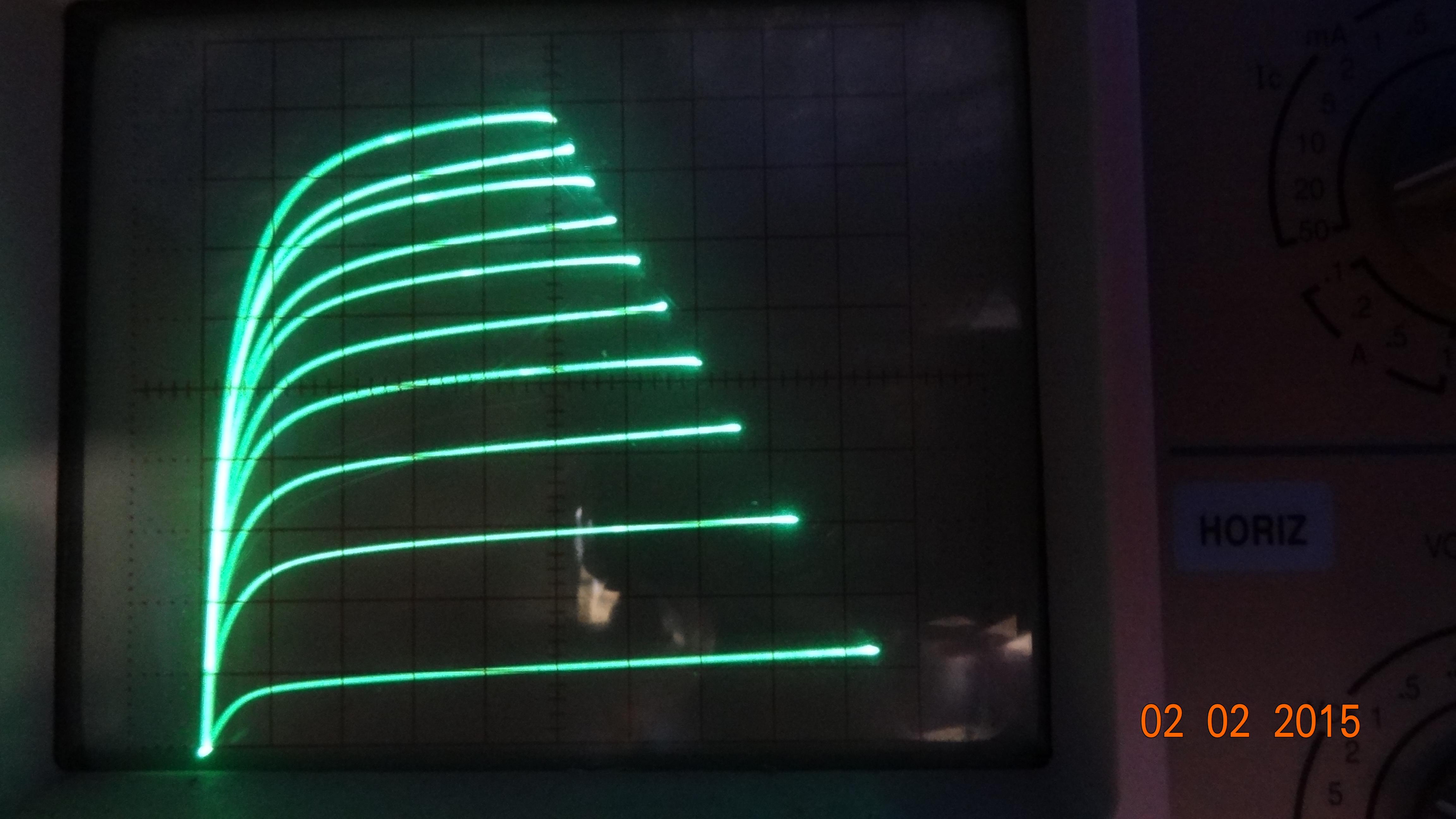

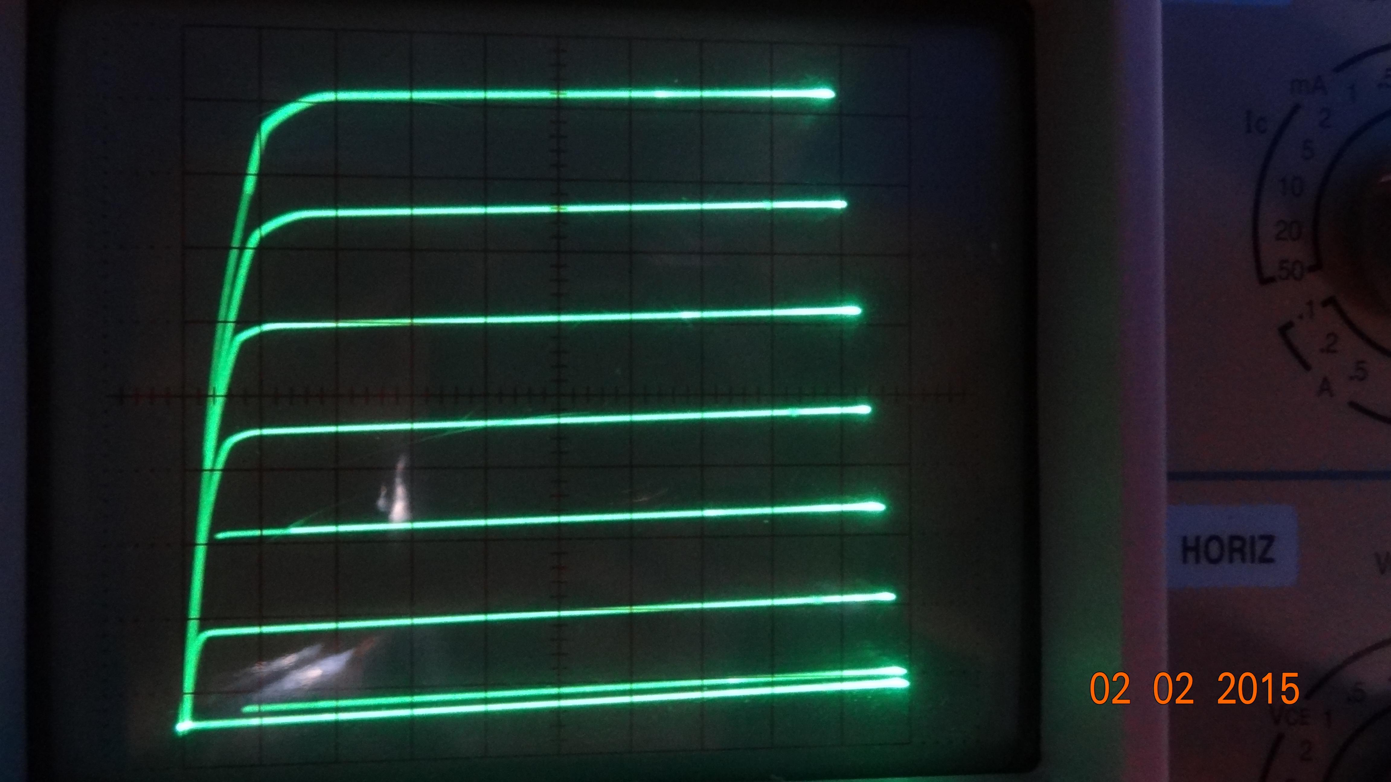

We/I want the lowest noise at 10Hz AND lowest distortion as well.
Below, you will understand what I mean by linear device (as per the curve tracer):
The first two are from a very low noise jFET but as you can see the steps are unequally spaced and the horizonal is a soft S shape with curvature at each end. Some point in the middle would be the best choice for a linear (without feedback) performance. The third is from a device which is very linear over a wide range of operating voltages and currents; evenly spaced, flat and horizonal. BUT, it isnt low noise.

What are these? (especially the last one). I have not found a JFET with gm invariant with drain current. If it is a bipolar plot of Ic vs Ib this is really apples and oranges. Low noise JFET's have short channels and always look like the top two plots, apply a cascode and they are dead flat. Yes you can cascode them and still put them on your curve tracer and see for yourself.

The third picture is a bipolar transistor, not a jfet.
As I suspected, a truly apples to oranges comparison. The beta vs Ic characteristics have absolutely nothing to do with Ic vs Vbe or in other words the voltage in current out behavior as a input device.
Second picture is either a jfet, or a depletion mosfet. Note the Vgs=0 bottom curve, this device has an Idss or u*Cox*W/L. Also note the parabolic shape of the incipient saturation points.
First picture looks like a bipolar close to base punch through condition (so at large Vbc).

Vgs is not = zero in actuality--- I adjusted the curve tracer to make the first step near zero so you can see all the steps and their spacing. It is a jFET. Bof 'em.
The first two are the same device under different, but not unreasonable, operating conditions. All are at 18vdc max.

Yes, it is easy to build charades, publish incomplete information (scales, step sizes and types, etc...), then let other guess what you mean or intend to show. Must have some entertainment value.
