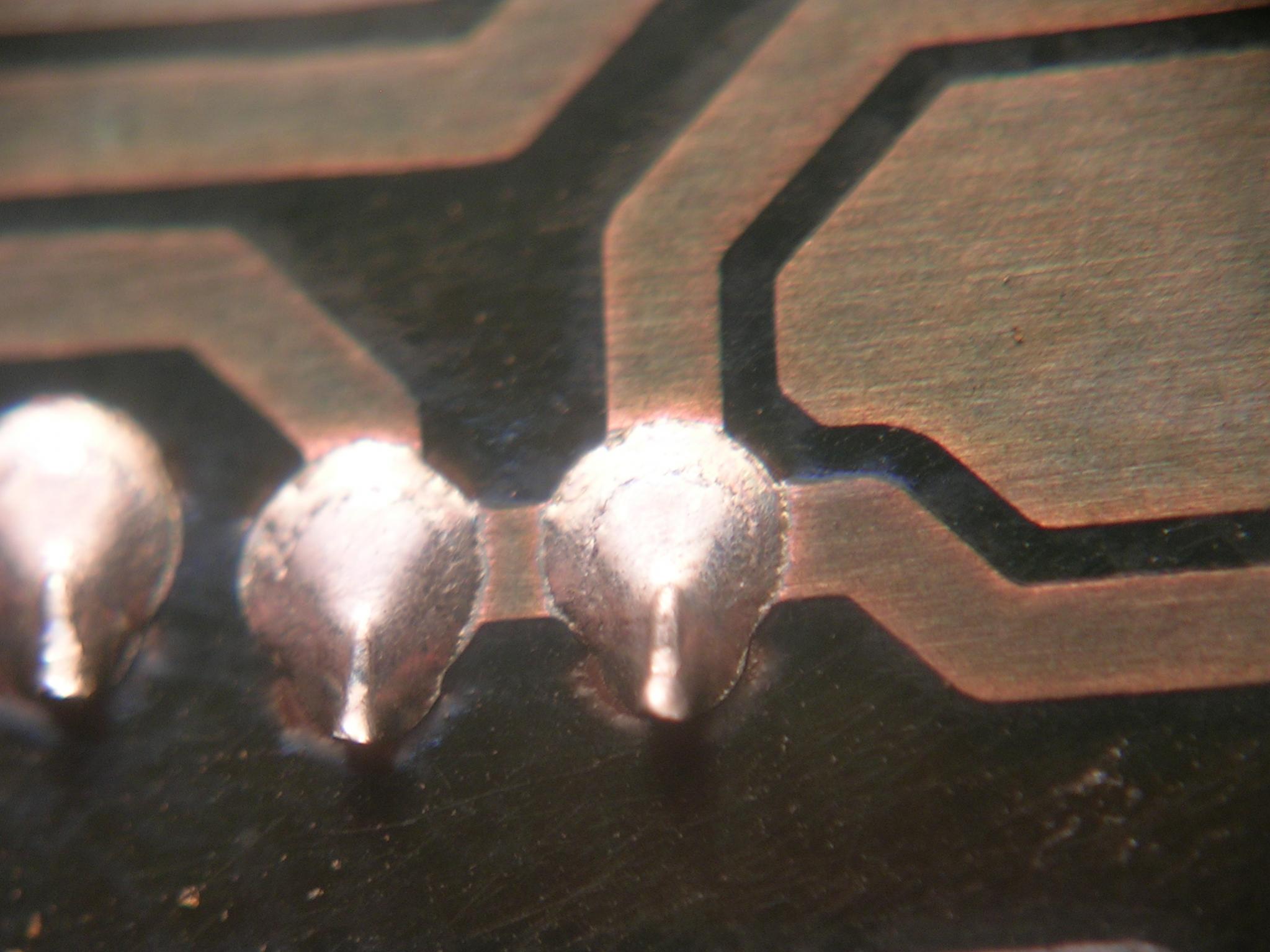

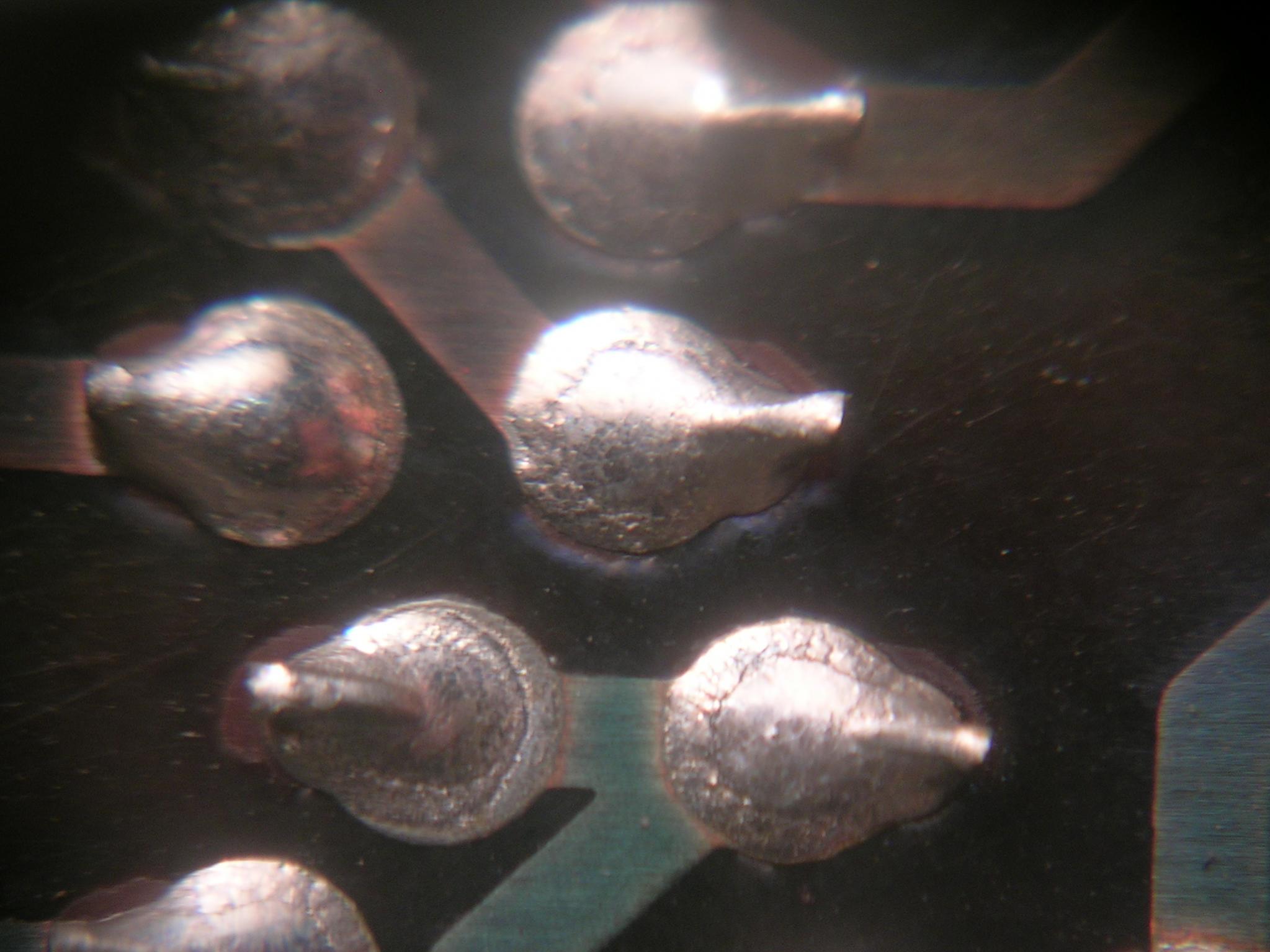

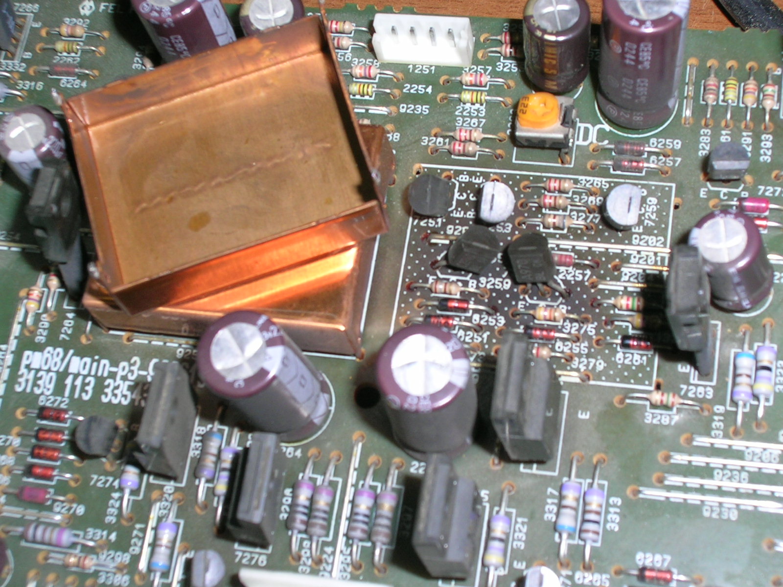

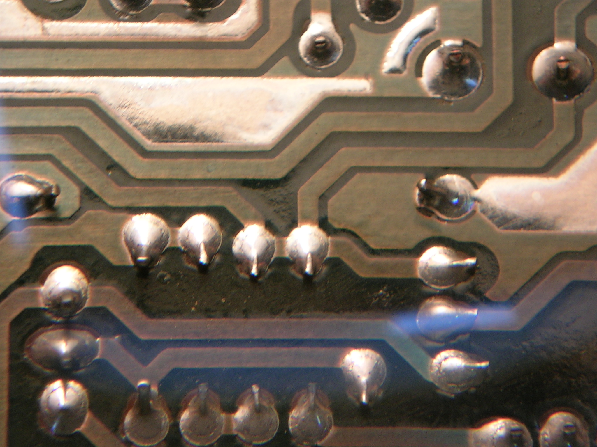

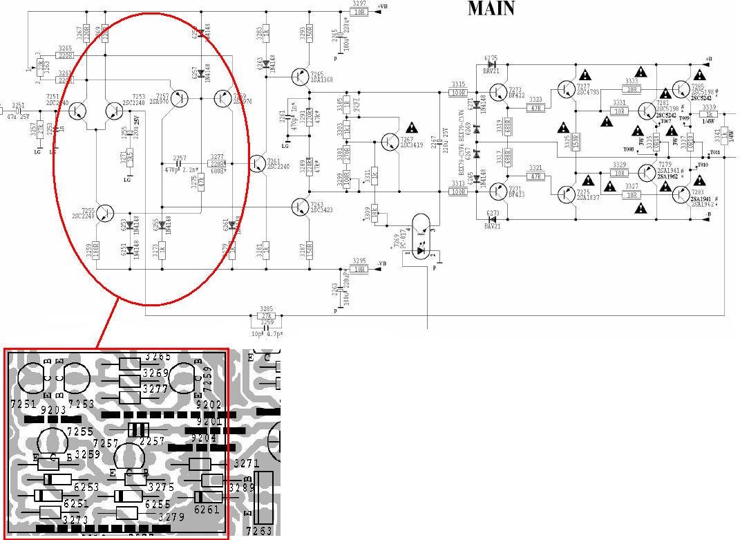

Richard suggested (for reducing sub Hertz noise) the elimination of air currents circulation around active (and passive) components.
This gives me the opportunity to say that the same air currents upset the DC bias point on some circuits (in a very annoying way if one bothers to monitor them).
The intuitive solution is to encase (confine) these sensitive circuits.
In such a case, the thermal behaviour inside the sub-casing (inside the box ) should be monitored on the long run.
I attach photos from an application where they failed to estimate the thermal problems of such a solution. The entrapped heat caused discoloration on the upper side and solder degradation on the lower side of the pcb (with consequent damage to loudspeakers due to intermittent electrical pcb contacts, causing strong power pulses downstream)
