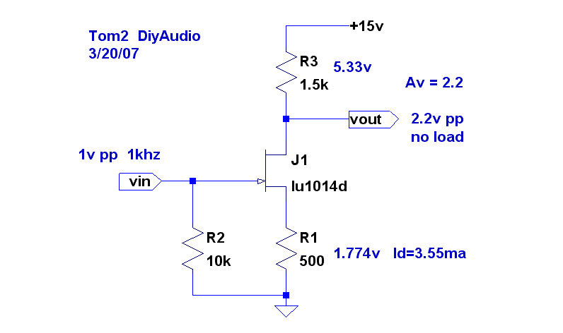

WARNING! I just started using LTSpice. I have only a particial clue as to what I'm doing with with this very powerful tool. Hey I'm here to learn. What a great hobby.
I hope I attached the right signal sources to the inputs.

you forgot input caps...........
anyway-this circ is more than simple enough ,so you can build it and try without sims;
better put some energy in constructing good enough shunt reg.
and-stay with bipolar supply (+/-) ,just because then you can omit input caps.
all in all-we already have starting schematic-now you can try to implement folowers

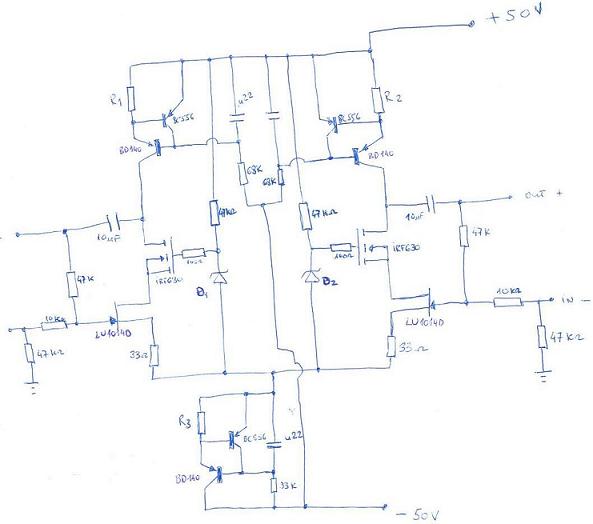

While looking at the schematic that Choky provided in post #78, I was thinking how to modify this circuit to suit the parts that I have in my drawer. And this is the result. The circuit is almost identical to Choky's, I just cascoded a Jfet. While this may seem unnecesary, the reasons were:
I already have a salvaged amp that has a working PSU, giving around +-50 V, so I wanted to use it. I have more Bipolars than mosfets in my drawer, that's why I prefer Choky's CCS. I have LU1014D, so while that my not be the preffered part for a preamp, it should give satisfactory performance in the cascode, as in ZV9.
I do need your help in determining the correct values for R1, R2 and R3 and I was not sure about the value of the Zener diodes, I guess they should be around 6.2 V?
Thank you very much,
Vix

vix

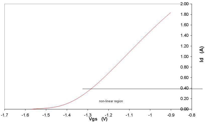

looking at pdf I attached (sorry- I forgot who is here responsible for measuring and drawing that.........Respect!!),seems that LU is good for nothing bellow 300mA........that's 300mA per side,600mA through lower CCS ............meaning that R3=Ube/I = 0V6/0,6 =1E.......plenty for veeeny BD140
even with 300mA (where R1 and R2 are 2E) BD140 will be fried........
you can stay with tiny Jfets for this
but-saythat you can live with some (!!?) NONLINEARITY........CAPSLOCK,then you can try with 100mA per side....R1 3E,R2 and R3 6E.........
use bc556C ,use bd140-16.....and zenners..........(0,1Ax33 +1V4 + 4V) = 8V7..............what is nearest standard value?
anyway-try.........but check dissipations for those bds and trim PS voltages accordingly

to vix again.........with these currents-time for reworking entire schematic......other (more robust) CCS........
anyway-just as illustration-my variant of famous (hehe) xccsblswhatever preamp for my friend Igor.........singing nice tunes along with Haf9505 on Fried Coffins etc.
in your boots-I'll make something leaned on this schematic......LUs,also CCS-ed above,300mA per side,minimum needed PS voltages
Thanks!!
In that case it would start looking more like micro-X-ZV9 with dual rails. :) :cool:
If I got it right, there will have to be around 600 mA from the lower CCS. (So there would be 1 ohm sensing resistor to set a current of 660 mA)
If the upper CCS-es are used (like those in Aleph P 1.7) instead of 680 R resistors, how much current shall flow through each of them?

Zen Mod said:
good for milivolts of input voltage
Thinking about mc gain stage. The input capacitance might affect
the loading of the cartridge. Easier to use 170's 389's though.
Also the pdf file of the transfer function is at a single value of
Vds. It would be interesting to see a family of transfer functions
as a function of Vds. This would show the "triodeness" of the
device.
Yes your right, nonlinear section. Maybe thats good?
