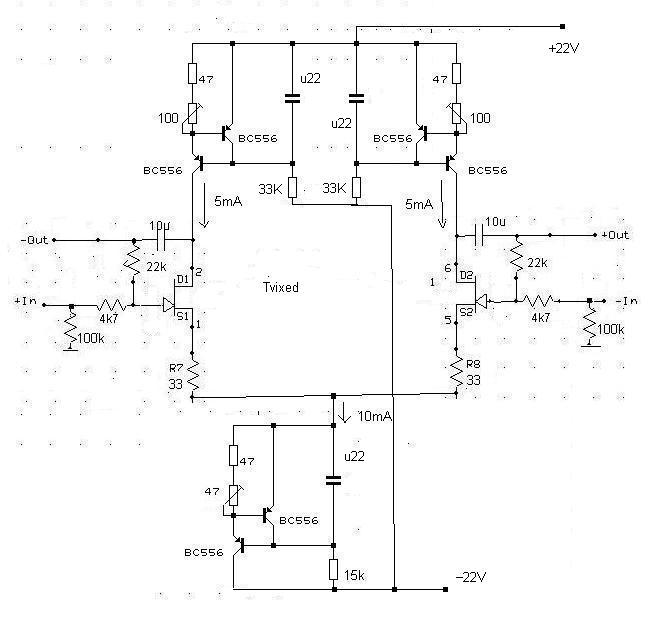

Official Court Jester
Joined 2003
that's for babo
pretty tired now-I'll double check it tomorrow
if someone see something funny-just say so.........

Zen Mod said:
pretty tired now
I know you are tired.
Babo singles (2SK370) not really to be matched as there are
the caps blocking dc to ouside world. The matching is always
preferable tho . . .
I'm sending you some of 2SK370 as a small gift pakage. Try them.
JJ is complaining you not building any.

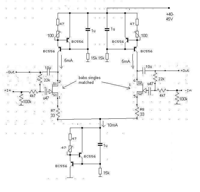

I was thinking about deleting input caps and makin' it with negative rail. One more change, can CCS be LED referenced? By the way, I'd increase the input resistor to 10-20 K and feedback one to 47K
Choky, can you help with a schematic, I am not good at drawing...
