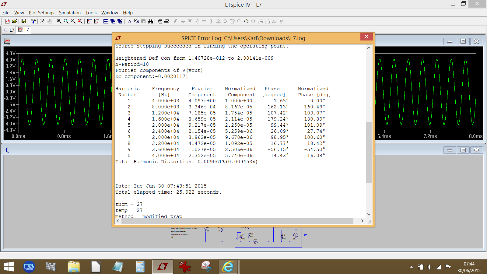

I've taken your circuit and swapped the models for the standard LT library ones. You can alter these back to suit yourself. The vbe (vgs) multiplier transistor was missing and I've set the bias to around 100ma. I set the run time for 8ms and the timestep to 0.000000030517578125 which was just copy and pasted from Windows calculator (10ms/262144).
Level set to give 1 watt into 8 ohm.

I am very new to this software. Recently I built a TubeLab SSE amplifier and attempted to model it in LTSpice. I learned a lot from this forum and the model seems to be working well. I have to admit a few of the components I literally copied from George's LTSpice jpegs and some others. One of my main concerns is the output transformer. I have Trancendar 5k 8R 10W transformers. I am not looking to model them in detail, I know I can download and create very elaborately designed .inc models. I really just want to understand how to convert what I know about the transformers to the coupled multi inductor method suggested by LT Spice, using Henerys and the other perimeters. I would love some suggestions, advice, direction? Thanks!

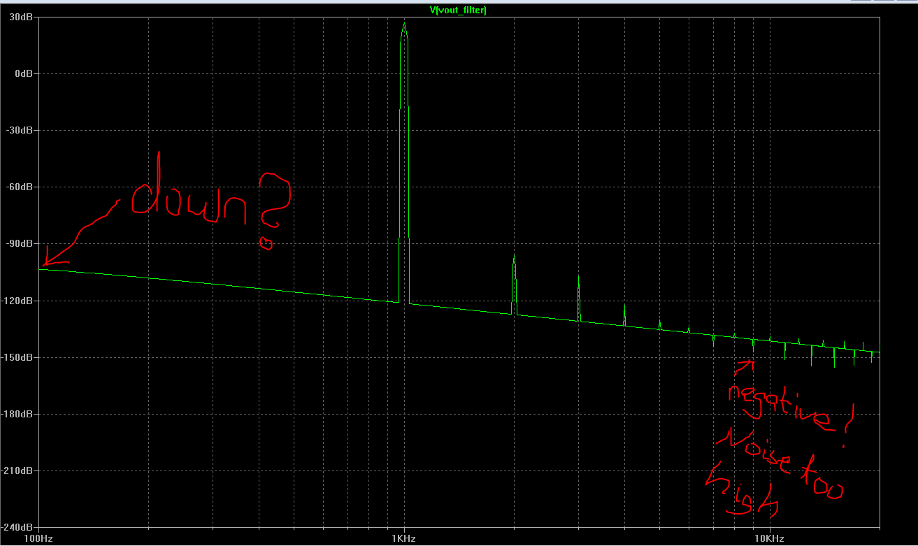

Hi, I need advise on how to set up a transient plot to get a good FFT noisefloor.
I have this setup for the simulator:
.param nFFT=1; for .four command
.param numcyc=30; For transient plot
.param dlycyc=1
.param Points=1000
.param simtime=(dlycyc+numcyc)/Freq
.param dlytime=dlycyc/Freq
.param BW=80k
.param Harmonics=BW/Freq
.param Timestep= 1/({Freq}*Points)
.maxstep = Timestep
But I'm not happy with my noisefloor.... what to do?

lots more points in .tran, the fft and use a window function - usually I use Blackman
exact integer number of cycles of the fundamental in the record time makes windowing less important but I do both
I use very small t_max_step_size but don't do any explicit calc as long as its several times your fft analysis record length divided by # of ftt points
and sometimes you need better DC solution and/or to allow longer .tran sim time, discarding the settling time region, just analyze the last few cycles when startup transients have died down

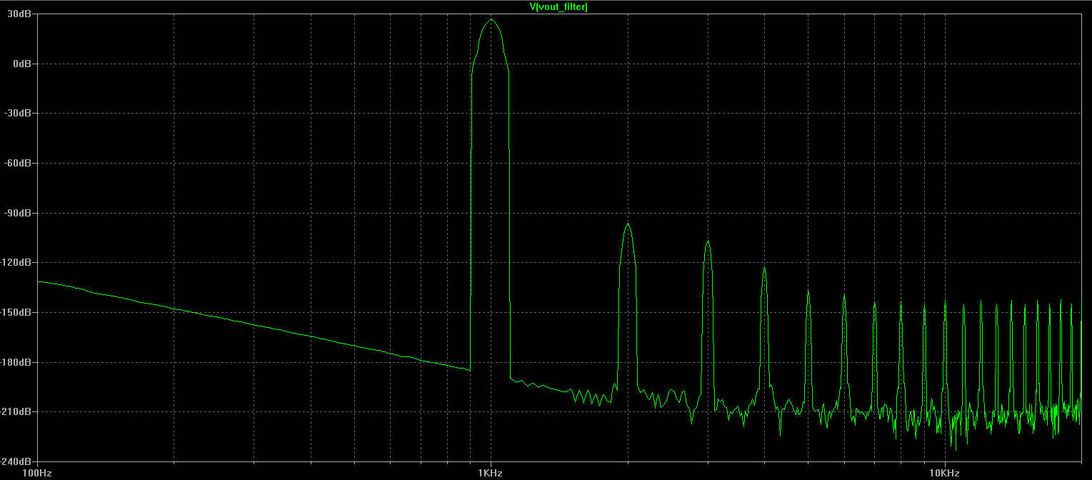

Blackman did the trick! Thanks
In the name of learning, here are both plots, without and with Blackman window applied.
\\\Jens
Yes, and you can still get rid of that slant if you find the source of drift in your circuit or use the alternate solver.
Thanks,
Now it is good enough to be used for tweaking
\\\Jens
