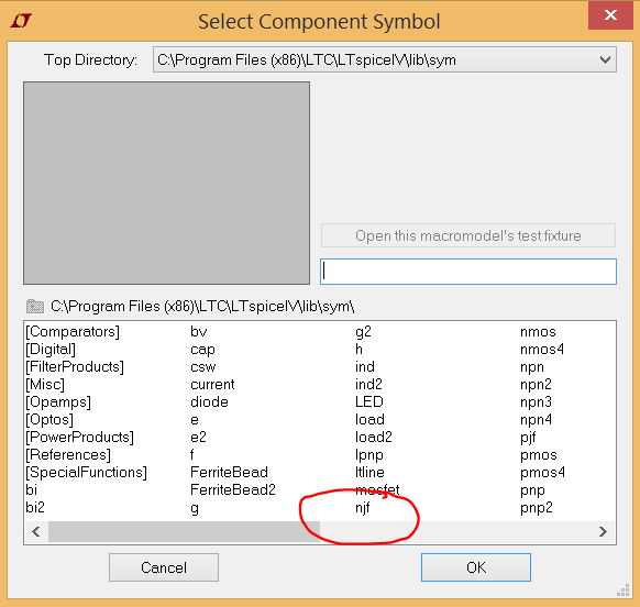

That is Cordell's model of the LSK389.
The 389 is a dual version of the 170.
All I need is to convert it to the singleton and it becomes a valid model by Cordell's method for use in LTspice.
I can't see any pin out designations even though it is a 7pin device.
What needs modifying to allow it to be used where a singleton 170 is used in the .asc?
All you need do to use the model is to pick 'njf' (nchannel jfet) from LT's component menu and overwrite the device number as you would for any other model. Of course you place two fet's on the diagram, or however many you want.
You could make your own unique part and pattern outline up but its a lot of trouble to go to, and working like this allows more freedom placing parts on the diagram.
Is that what you mean ?
I did pick njf from LT.
But the dc op is showing a tiny 0.11mA of Id instead of ~1.4mA
it could be a faulty CCS tail current, but it only has a LED from LT and a BC550C from Cordell.
So It seemed more likely that the njf was the problem.
If I change the device from njf to 2sk170, the dc op fails.
If I try lsk170, then I need a model in Cordell models.

Solved two problems at this visit.
I had not specified the LED in the CCS.
Cordell has a "RED" in his models.
I just swapped in "lsk389c" for njf and it works.
Seems the 389 is not modeled as a dual and is actually a singleton, i.e. it is actually a model for an LSK170. And that explains why there are no pin designations for the 7 lead device!
Note that c in lsk389c is Cordell and nothing to do with Linear's C grade.
