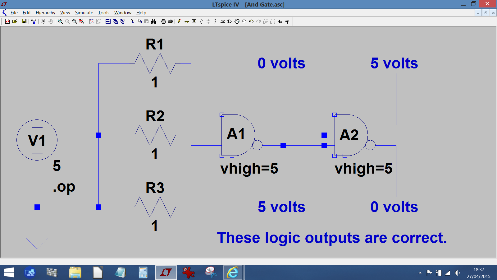

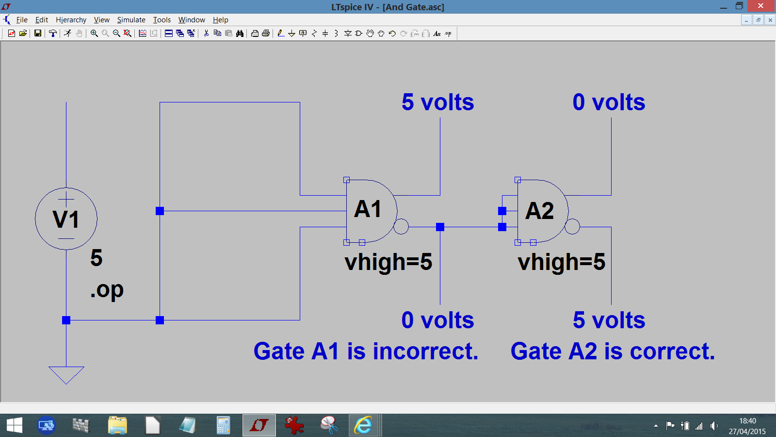

Can anyone explain what I'm missing here.
I have been thinking of adding a section on using logic devices buthave discovered a fundamental problem... which no doubt is something I am missing.
Here we have two AND gates selected from LT's library. Rather thoughtfully these include the inverted or NAND output as well.
The problem is evident when looking at the two versions here. To get the correct logic function on gate A1 needs the inclusion of the series input resistors. Even making these 0.00001 ohms works. Make them a link and the gates two outputs flip states.
The asc file is attached if anyone wants to play with it. Just link the resistors out and see how the function of A1 reverses.
What am I doing wrong

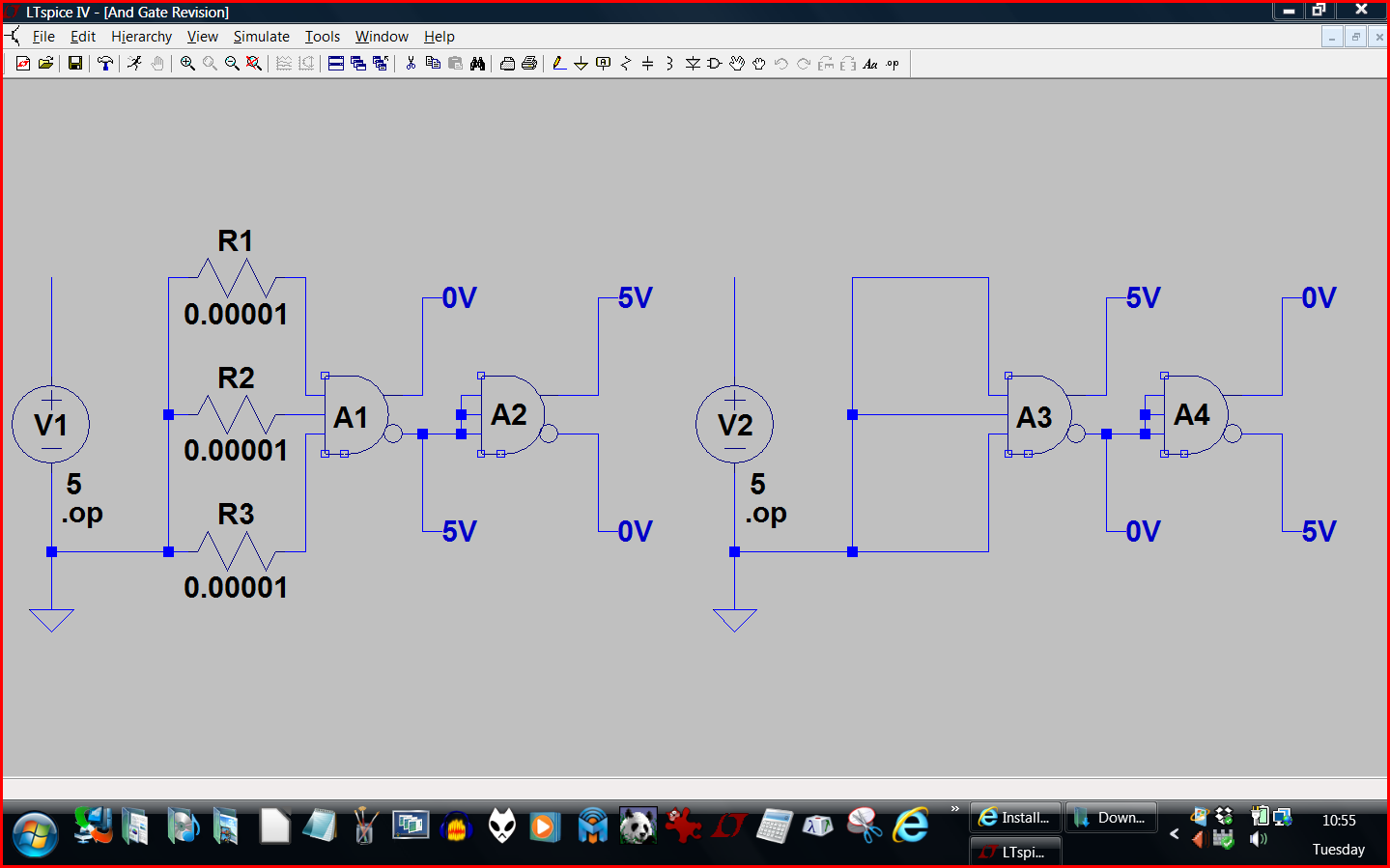

The blue text is just added comment. the vhigh=5 applies to just the symbol telling the gate to operate as if it were on a 5 volt supply.
If you hover the cursor over the lines you see the voltages.
Try this, the two circuits side by side. The blue text is now LT generated when the file is run and shows the voltage as LT calculates them.
