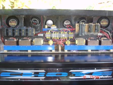

hello, how about this booster for amplifier
bai,
naa kay idea ug pag calculate para sa input ug output
transformers ani........:bawling:
ako man gud rang nasabtan aning booster kay mura ra ni siya'g
inverter pero dili lang kay usa ra ka frequency, but the whole audio
spectrum........
dayon imbis na naay oscillator para maka create ug sinusidal wave
audio amplifier ang gigamit.
munang galibog kog dyotay.......:scratch:
hehehehee..............
boosters
ok..
medyo taas tag discussion ana nga parte bay..
i would like to explain it to you personally..
well now, back to the topic, these types of boosters does not perform well on the whole audio frequency spectrum..:(
its performance is degraded specially on the highs due to core loss (iron cores)..despite this,it really gives the "punch" bass..
so i have used power amps for the highs & this booster for the lows..:D :D
cheers!!!!!:cheers:
bitaw bai murag tuod-tuod nagod kung gabulong ug explaination
bahin ani.......
pero ok ra.....na a man ka.....
:D
mura'g wala gyud ko kita'g libro bahin ani nila......
kabahin ug quality maayo gyud ni siya sa low, as what you've said
core loses:whazzat:
basin pud tingali sa material nga gigamit.
murag silicon carbide man tingali ning metal nga gigamit ani?
whereas unsa kaha kung powdered ferrite core ang gamiton,
murag mas improve tingali ug dyutay tungud sa permeability?
or.........:scratch:
well more to discuss on this......but we'd better be contented of what
we had for now....
long been forgotten man gud ni nga topology,:bawling:
kung full-range ang imo gusto nga operation bay, ferrite cores are not advisable for LF applications..in this configuration,depending on what the core is made of,we will have to sacrifice either low or high spectrum..:(
aside from that,its very hard to find big ferrite cores diri sa atoa..
many reasons why this topology is long been forgotten:
*limited freq response
*bulky/heavy
*requires more current (therefore big wires)
& others i forget
well,transformer coupled push-pull amplifiers were the "high powered" amps back in the days..:D :D

here are now the pics
