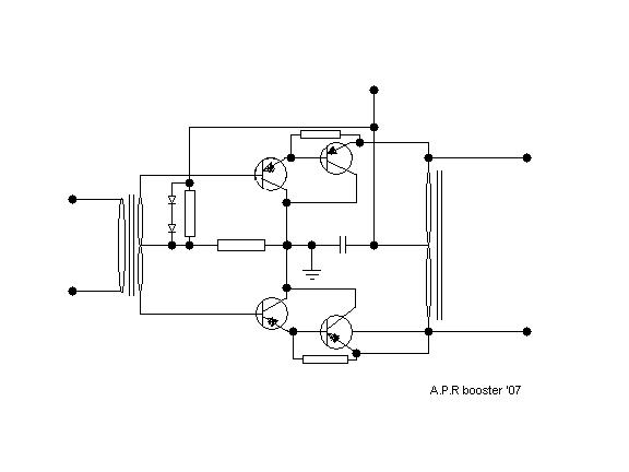

yep, that's the standard late '50s, early 60's xfmr coupled output stage...... used by zenith, rca, motorola, etc in all of their console stereos. about 5%THD at rated power. sounds horrible when clipped from magnetic as well as transistor saturation. one advantage over the tube version of this circuit was that the xfmr didn't have to be insulated for hundreds of volts. since you're driving an inductive load, i would add flyback diodes across the C-E lines on the transistors to protect the transistors from inductive kick.
booster Post #54 hienrich, i thought ill just post the schematic now,while i still have time. what do you think of this one?....

actually I've tried this one before.
darlington connected for enhanced beta for the final
outputs. yet also changing values of the 5watt resistors
for it bias voltages.

well the trick is not to change the bias resistors when you change the supply...
the two diodes in series limits the dc base current so that voltages ranging from 12-36v wont damage the transistors..since we vary the max power output through the supply (Vce that is )..
the power required to drive the input transformer is minimized,also the darlington configuration allows you to add more power tranies without much (negligible) loading on the input secondary,therefore higher voltage swing is achieved as compared to the conventional (old) circuit where the sec. directly drives the power output tranies lets say ummmh 6-10 pairs or more? some "technicians" even go as far as 50pairs! (100total) for just a single channel..
thats the usual practice here...
but of course i dont do that!!.

they did use 2955,(pretty cheap PhP 18-30) & the usual practice here, the total base drive current is around 6-10 mA...all that current is to be consumed by 100 tranies without the emitter stabilizers!!...as a result, 1,2 or more (but not all) heats up when supply is increased to 24-36v..
to most of them here,they neglect the idle current (not aware of it when tranies are warm even when idle)..
in my version,aside from darlington configuration, i did use emitter resistors & to 247 power pnps 4-8 pairs (for easy mounting, not MJ2955s), depending on how much the load impedance will be...
depending on the type & number of output tranies,the idle current does not exceed 100mA,
