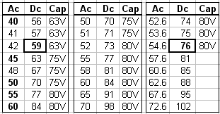

I think the most common secondary winding outputs are 40/45/50/55/60 Vac with DC around 56/63/70/77/84 Vdc.
I prefer lower voltage for the output. Anyone who wants to bias higher will have the option to do so.
And 9Vac (12.6 Vdc) extra winding (for the front end) is easy to find.

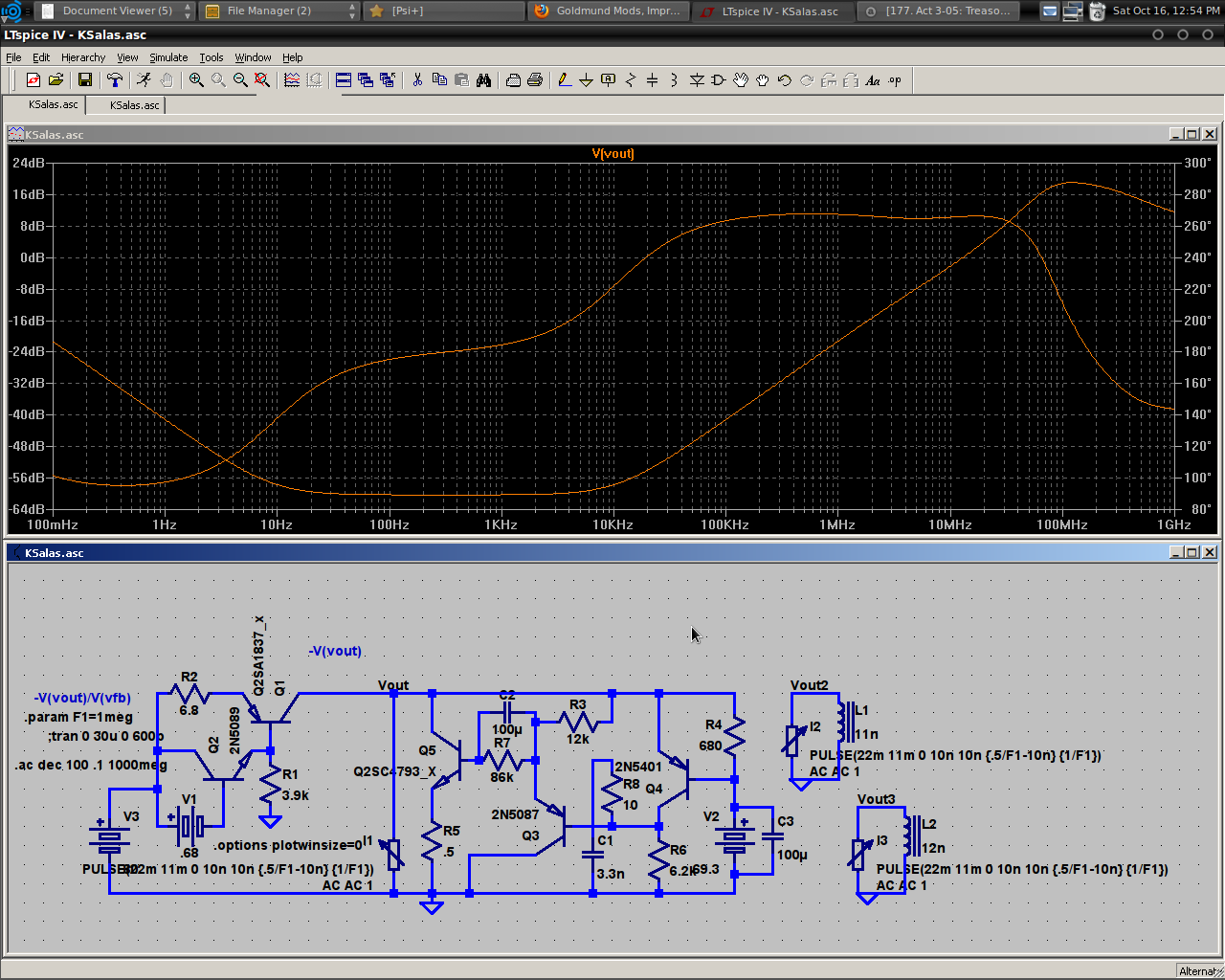

I think what we are aiming for is an output impedance below that of an electrolytic cap, and at least a comparable output inductance. As such your 1-Q reg needs gain. Salas' circuits are the perfect starting point.
- keantoken
Yes. Salas circuits are excellent.

My personal preference would be a Salas... With a degenerated BJT output. Will be faster and more predictable I think...
However I want it to be simple, too.
The criteria are:
Zout 20mohm or below
Very low output inductance
Is this one a lost cause? If I could eliminate C2/R7 without giving up output impedance...
- keantoken
The criteria are:

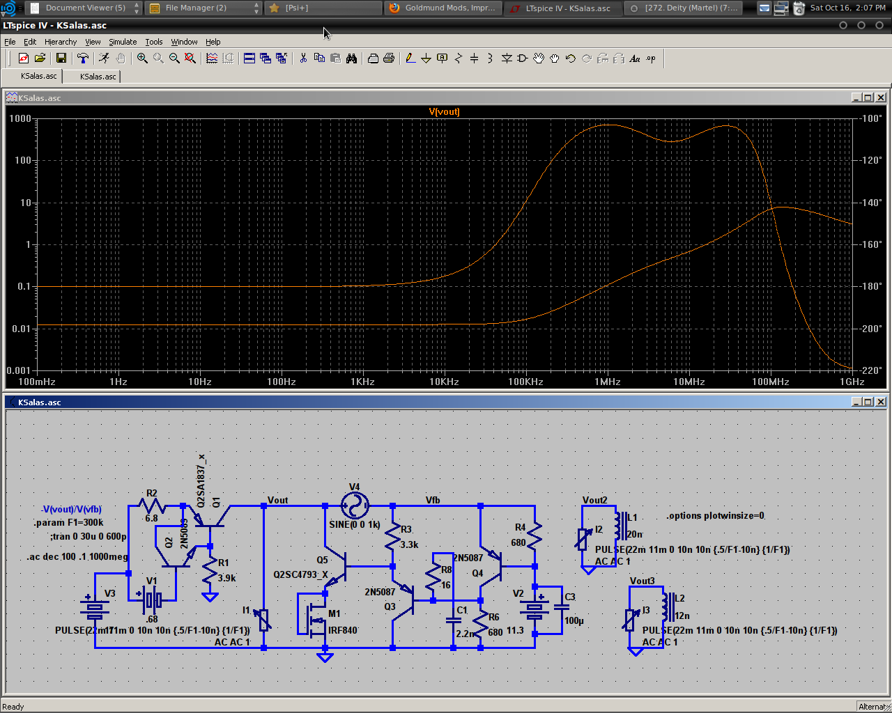

Okay, I wanted try this on my own before asking advice.
If I had all the transistors I wanted I'm sure I could do this, but I want to keep it simple. Currently I've found no better option than to abuse a MOSFET as per the attachment. Does work though, with 20nH output inductance.
- keantoken
- keantoken
- keantoken
Nice improvemennt. Keep going
