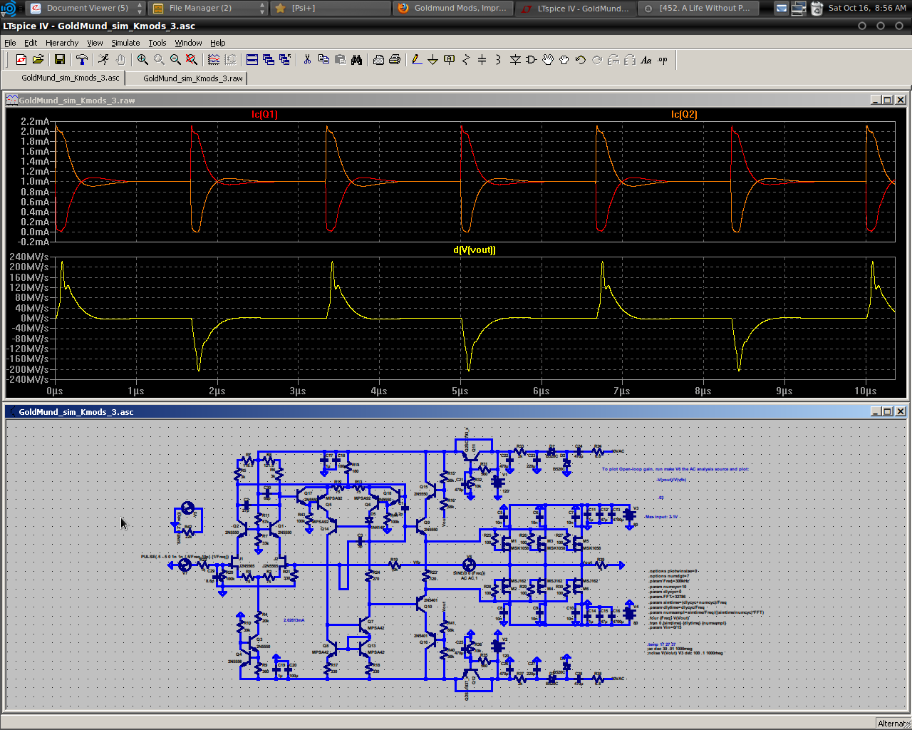

To an extent we can't really determine the rail voltages for the real Goldmund with simulation. It used an odd CCS for the frontend, and because it will depend on transistor characteristics, we can't tell exactly what the stage current was without measuring the real thing. I guessed 4mA. But a small change in this will make a large change in VAS current. Without knowing the exact frontend current, we can't determine the upper rail voltage.
- keantoken

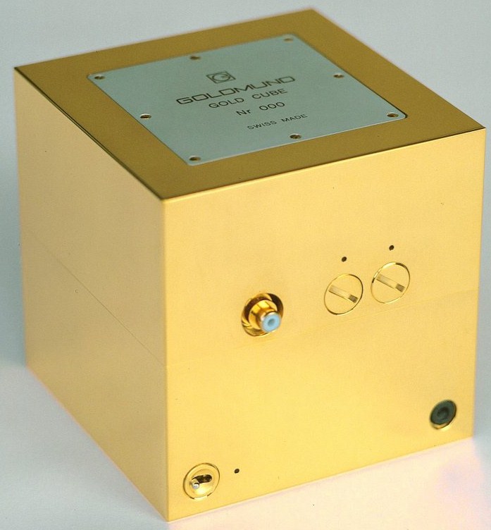

the perfect sounding amplifier may be one that is technically flawed.
Any 250W amp with small size toroidals and 9400uF per channel is inherently technically flawed.
The perfect amp is goldplated.

Here is the simulated slew rate currently. I don't know how much board layout is expected to cut into this.
Tanh, we all know your sims look good. But if you don't share, we can only ignore you!
- keantoken

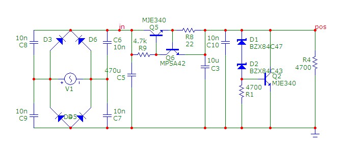

Shunt
Hi Kean,
Here is a simple shunt regulator you can play with and enhance.

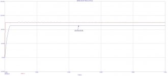

What we would need to consider is a speaker delay that will have a long enough time constant so that all the voltages in the amps stabilizes before connecting the speakers.
