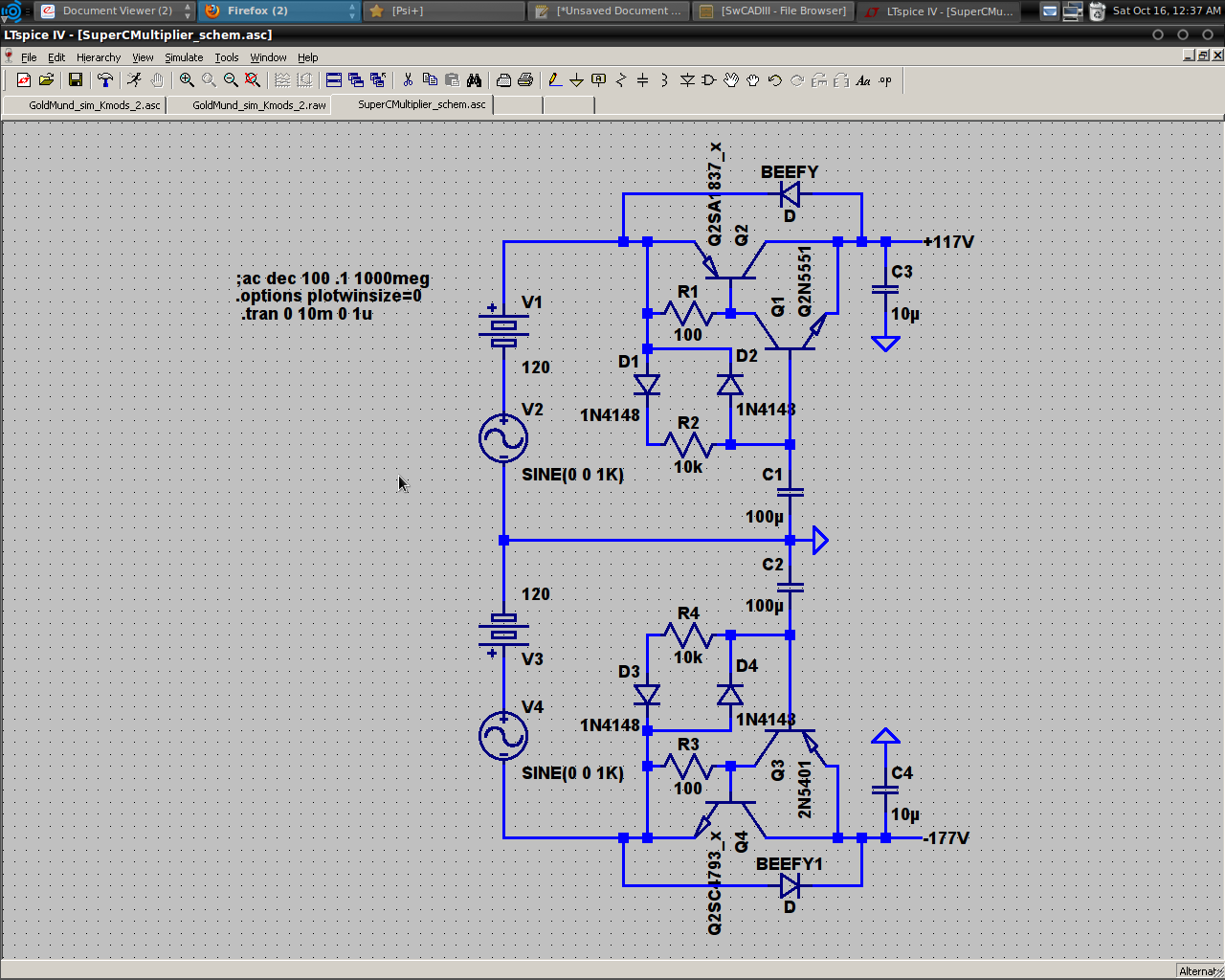

This is what I'm currently thinking about for the frontend. I imagine the power stage won't be actively filtered?
This is just a beefed up C-multiplier to me. There is no regulation involved, output follows the input voltage, even if very slowly due to the very high impedance feeding C1 and C2. Output impedance is comparable to low-ESR electrolytics.

why not just regulate the front-end properly instead of using "capacitance multiplier" Personally I would drop the voltage on the output to 65V per rail and run the front end at higher voltage to swing the mosfets closer to rails. Contrary to popular believe the output stage with gain less that 1 does not deteriorate THD, in fact it has little contribution at all. You need to reduce noise and distortion in earlier stages as much as you can.
Making a high voltage regulator is not that hard, besides you are assured of higher ripple rejection. Your capacitance multiplier uses almost as many components as a regulator in any way. As Andrew indicated the multiplier just adds a time constant it hardly improves matters.

Using a regulator will give lower output impedance, but will most likely be slower. Some posters have told me they want a fast regulator, to complement the fast amplifier.
Further, my regulator has output impedance no lower than that of a low-ESR electrolytic. While this is large to some, it means it is relatively inert, and non-reactive. This may be important for high-speed designs where we must eliminate resonances which may be excited.
Thirdly, my design is a beefed up C-multiplier, but it is simple and trivial. The DIYer need not mess with it. It is not hard to troubleshoot.
As far as the differences between a regulator and a C-multiplier, I think the only difference is that one follows the output at DC and the other doesn't. If you think about it, both of them have to be designed so that an input voltage drop won't saturate the pass transistors. It is no different when my multiplier is set up to have a sub-Hz time constant. In fact, the C-multiplier may be better, because if the rails sag for an extended period of time the C-multiplier will follow it rather than fight against it.

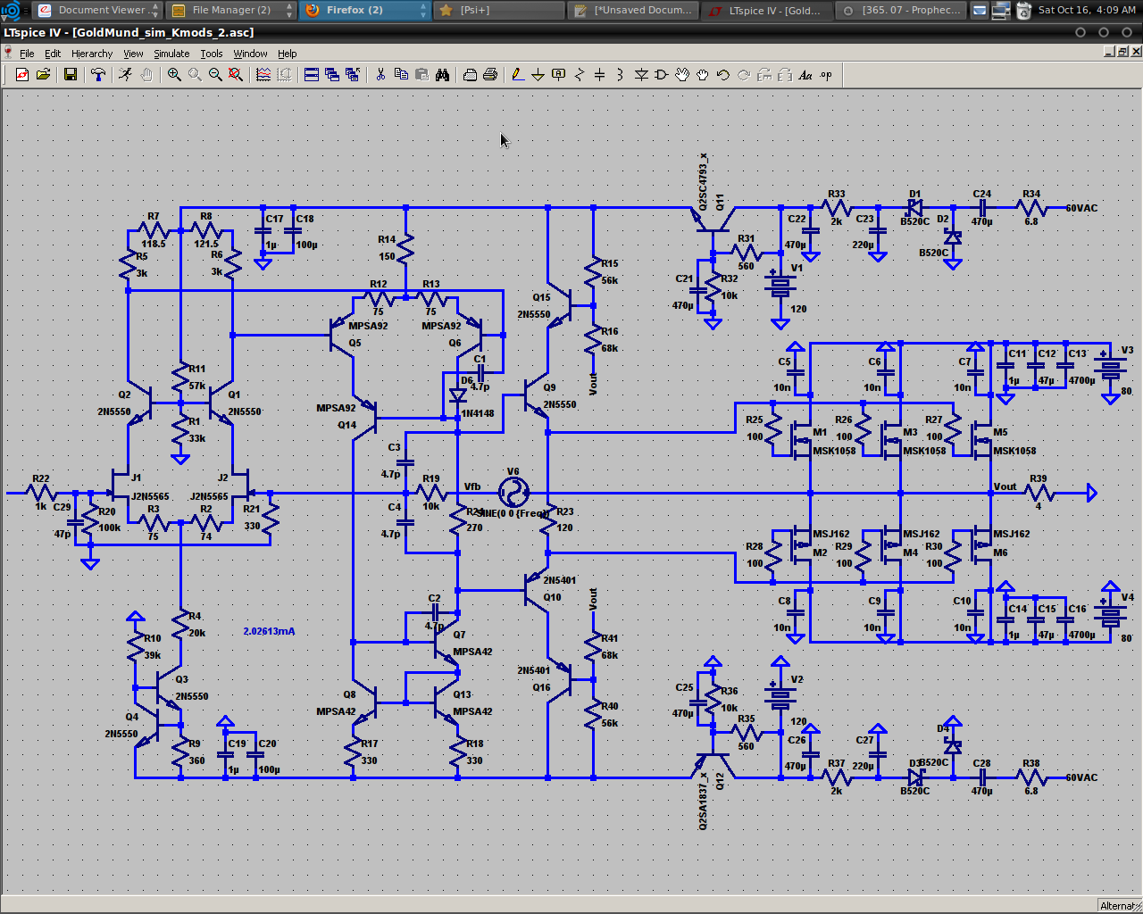

Equivalant input capacitance on both complementary FETs?
The use of 100R resistors on the gates of the mosfets seems very old school to me.
Later lateral mosfet amplifiers that I have played with seem to use a higher value than this. 680R is one value that I have often seen used as a gate resistor. There is also the asymetrical capacitance of the lateral mosfet pairs, with the N channel 2sk1058 having an input capacitance of 600pF, and the P channel input capacitance being 900pF.
This can lead to oscillation as the N channel device is faster.
Solutions have included adding NPO/COG ceramics to the N channel gates, or using different value gate resistors for the N and P channel.
When reworking a lateral mosfet amplifier, my preferred gate resistors are 680R for the P channel and 1K for the N channel. If the low 100R resistance is preferable for this amp then maybe the N channel gate resistor should be increased to150R?
Piersma, I kept the original gate resistors used on the Goldmund. I don't know exactly how these should be set. It may have to be worked out on the prototype.

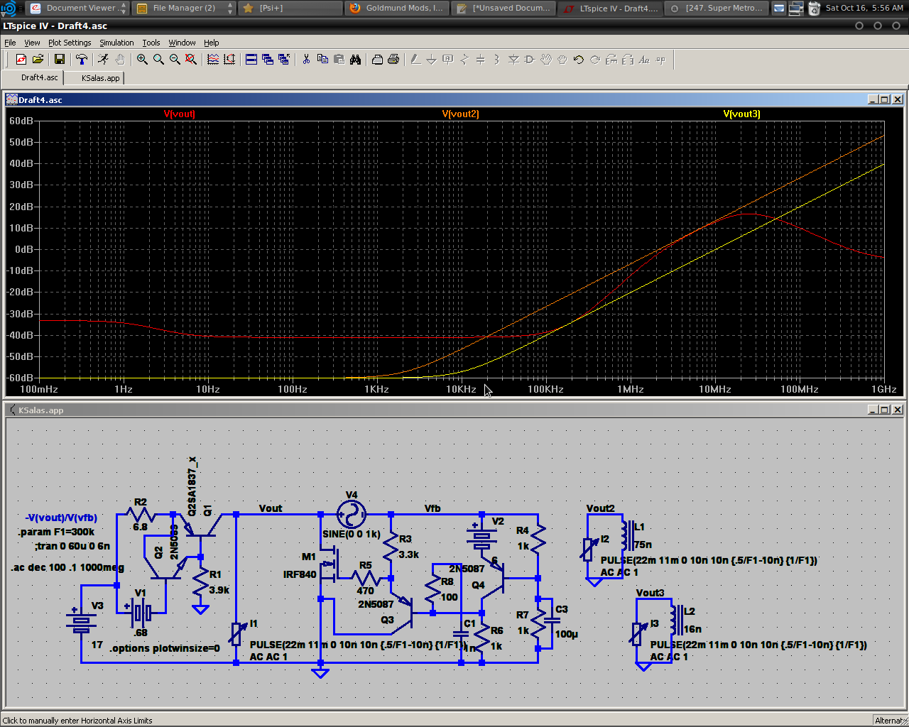

Nico, whenever I refer to speed in a regulator I mean effective output inductance. Every regulator/multiplier has reaction time. This tends to decrease with increasing active components. It's not much different from the ESL of a capacitor. For instance, you can see in the attachment that this regulator has a changing output inductance between 16 and 75 nH.
Andrew, it seems people want a lower impedance regulator, so hopefully we can get better than my C-multiplier without getting too complex. Attached is me playing with Salas-inspired circuitry.
