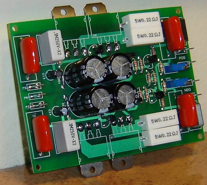

Here is the PCB pic. I use them in a lot of my applications. Works good and has slow start up which iliminates pop on speakers, also slow decay. CM works great also. If you want Gerbers you are welcome ofcourse

OS, my preference would be to use a shunt regulator for HV frontends, since they are inherently current-limited and forgiving, and are supposed to have better performance in most areas.
Nico, I notice you specify 1uF polycarbonate caps for the output decoupling... How do you get those?

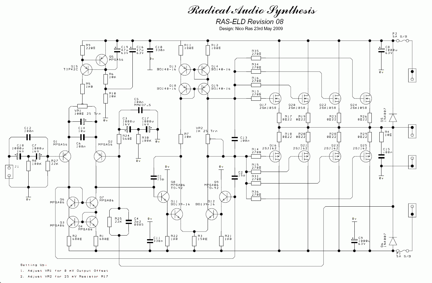

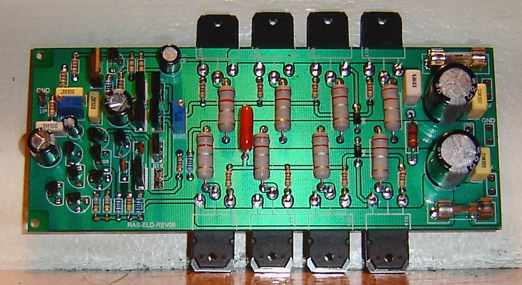

ELD was my version of this amp for some years.
RAS ELD has been my Goldmund for more than 1 year but is now a commercial amp with a few changes. It does sound pretty handsome and it contains almost everything that has been mentioned in these threads. The commercial equipment contains a regulator on each channel as well as a few other refinements which I cannot show here, but what I show is a complete working machine in every-day use.
Some may not call it musical for what that statement means, but it is like water, it has no taste, no color, no flavor, no smell and, it gives what is inputted, no more no less. Some my prefer flavored drinks others fizzy drinks, etc, this amp does not do that, it is completely vanilla.
Maybe you could use some of the ideas from it. I have not been a fet input fan, I stick to BJTs, of course one change is front end that now uses 2SC2240 and 2SA970. I will post some sims below, not that they are of much use in practice, but gives an indication.
Shouldn't R8 and R30 go to negative rails or some bias string, to help linearize the electrolytics? Currently they do nothing.
- keantoken
Hi Kean when I use electrolytics in an back-to-back config I bias them slightly. This makes them last longer as the electrolyte remains activated. I learned this from an old man years ago and keep on doing this., Why I used R30 is a waste obviously.

I use the regulator shown earlier. It works wonders compared to raw caps only.
BTW I do not say use this design, I say see if there is something to learn from it, if not then scrap the idea, it is not important to me. If there are ways to improve it I will be pleased also.

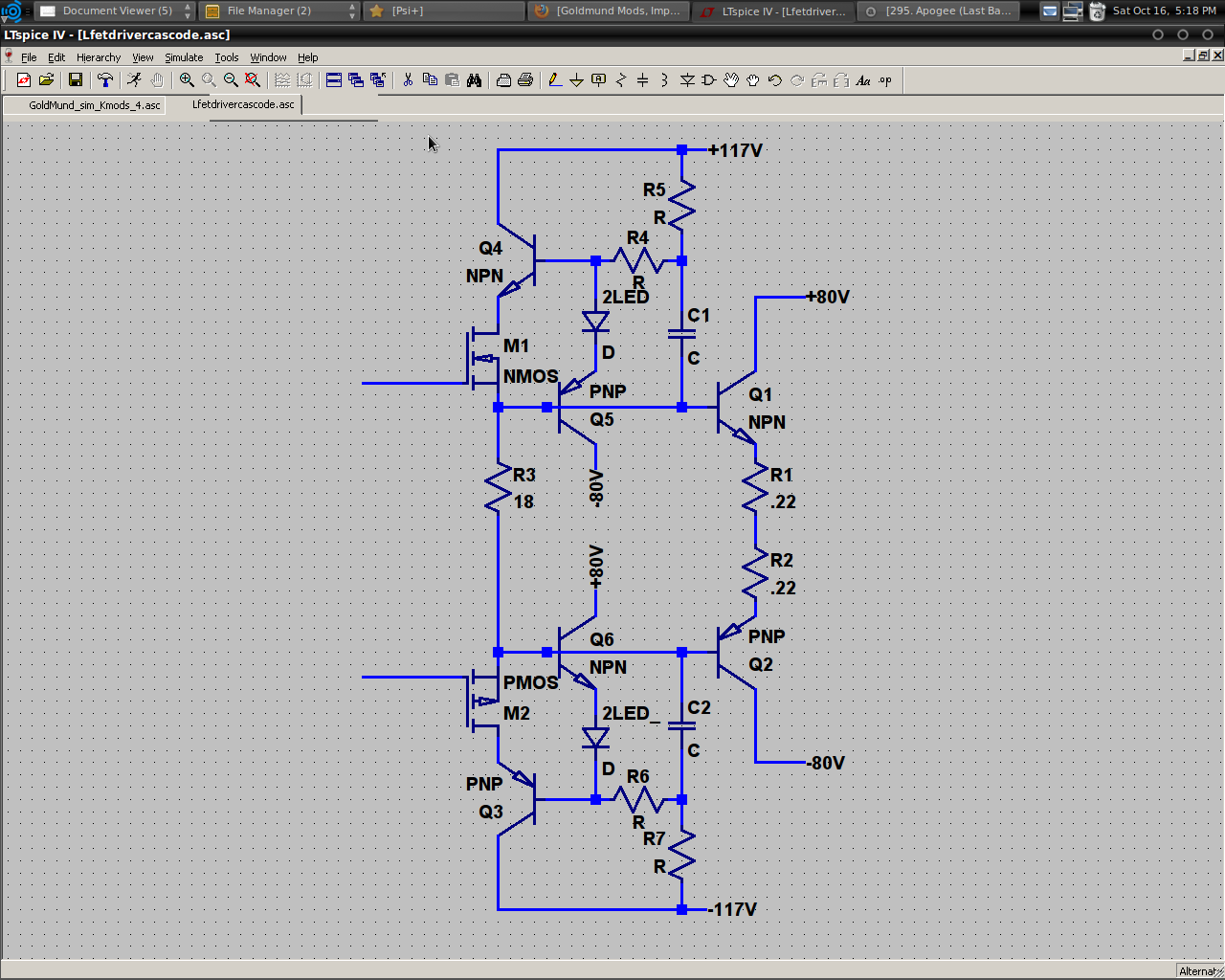

This is closer to my design than the Goldmund.
This is looking like this could be something special.
When people start to also consider the role of the power supply to the total package. Then there is a very good chance of success.
My vote goes for a shunt reg on the front end.
