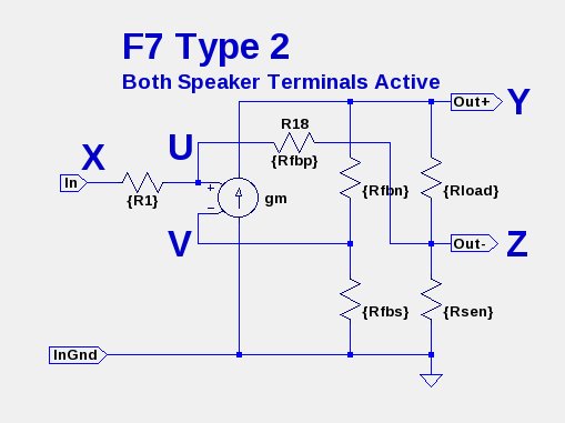

So you have, mostly thanks to lhquam, a selection of potential topologies,
even some nice equations for them. Probably more than you asked for.
This being DIY, I suggest that you pick one and build an amplifier.

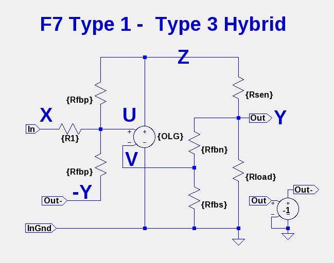

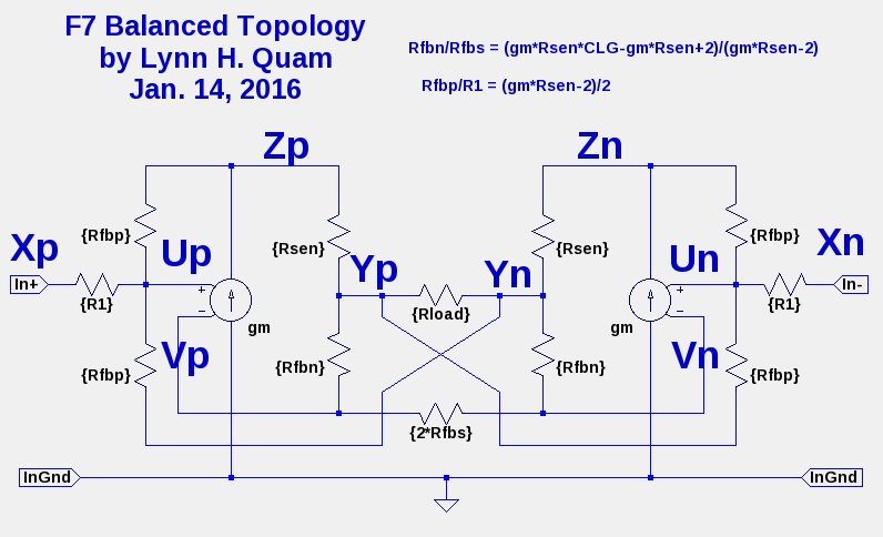

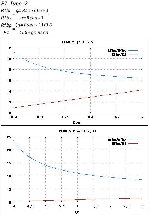

F7 Balanced
Here is a hybrid of the Type 1 and Type 3 topologies.
  • Speaker negative terminal at ground
  • Sense resistor above load
  • Negative feedback as in Type 1
  • Positive feedback as in Type 3 computing the feedback signal as Z-Y
The following plots show that the Type 1 - Type 3 hybrid has relationships between the feedback resistors that are comparable to the Type 2 topology, except that Rsen must be somewhat larger for a given value of gm.
How to generate the -Y signal will be shown in a later post.

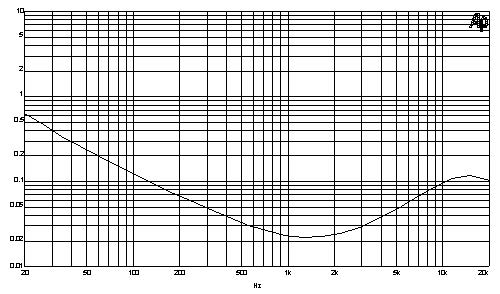

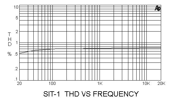

Nelson managed to get with F7 a similar distortion vs frequency curve like with the SIT 1 or 2.
for comparison M2 (that looks like the wilder brother of F7)
left F7 in the middle SIT1 right M2

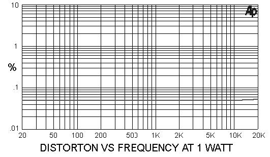

. . . Nelson managed to get with F7 a similar distortion vs frequency curve like with the SIT 1 or 2. . . .

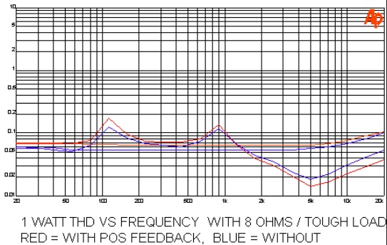

Now the THD still puzzle me. Bottom right figure at 6moons audioreviews: FirstWatt F7, p4 as attached, unlike THD posted on the F7.pdf, shows increasing THD > 3kHz on the 8 ohm graph (not the wavy ones).
The one and only
Joined 2001
Th wavy one is for the "tough load", whose impedance goes down below
3 ohms at a couple of places (where the distortion peaks are) and is
inductive at the top (where the distortion goes down accordingly.
The flat one where the distortion rises at the top is with a resistive 8 ohms,
and shows the non-linearity of the Fet capacitances.
:cool:
Thank you for the explanation. So it seems that compared to the F5, the F7 has a bit higher THD vs Freq, probably due to lower transconductance of the output Fets, but started to rise several octaves higher, most likely due to lower input and miller capacitances of the Allfets. I'm guessing a bit less edge on the transients, smoother top end and tighter bass control with perhaps a somewhat more depth to the soundstage presentation. I'm with Generg here, waiting for Srajan's review.
