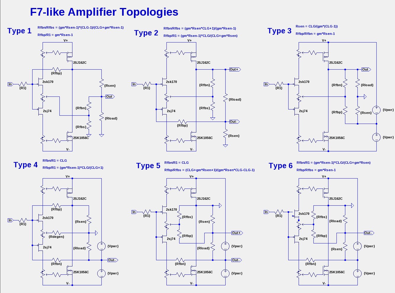

I have completed analysis of the 6 the combinations of Rload/Rsense resistor placement w.r.t. each other and ground. LTSpice simulations appear to verify the correctness of the equations shown.

The priceless infinite damping factor of your diyF7 prototypes maybe preserved by having the two overall feedback loops originate at the terminal

After some study of the ALF08N16V and ALF08P16V datasheets, it looks like the rail voltages could be increased to 32V and the bias current to around 2A, giving an amplifier that could easily produce 40W output. Of course the input JFETs would need to be cascoded to keep them within their operation limits, and the heatsinks would need to be larger or fan cooled. Obviously this would not fit within the FirstWatt parameters, but would be a DIYer's delight!

I would like to use the DIYAudio Universal Mounting Spec board and heatsink layout that is used for F4, F5, F6, ... boards. I was thinking about using pairs of the TO-247 (ALF08N16V and ALF08P16V) FETs. Can one safely parallel laterals without source resistors by matching for Vgs and gm at the idle current?
Alternatively, using the TO-264 packages, I guess I could place the FET pads further back into the board by about 0.18" so that the leads of the TO-264 package are in a suitable position in relation to the thru holes.

Looking at your board layout: Did you use the topology that I show as Type 1 in post #441? Without cascoding the JFETs, how high did you go with the rail voltages?

30V and no cascode should be fine in this circuit with 7mA Jfets.
I've done that before without issues.
