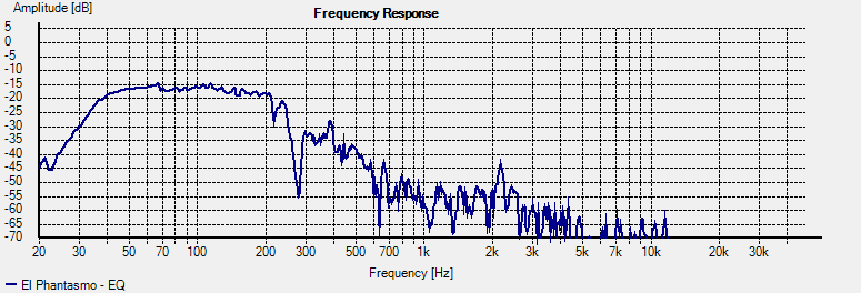

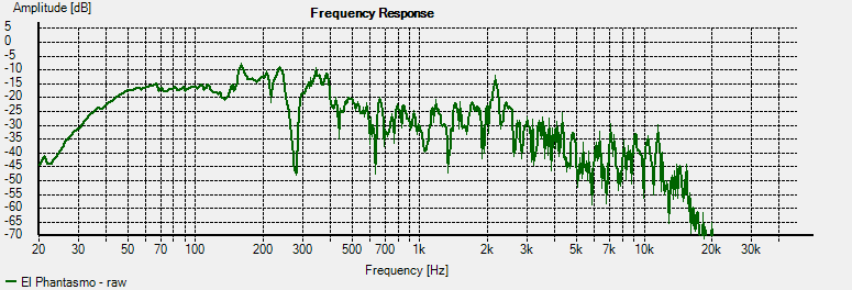

Can't the same thing be accomplished much easier via DSP?
If you've got enough parametric EQ channels available, of course.
Here's my POC #3 before and after some DSP-applied EQ to address the out-of-band response peaks:

I haven't heard THs with or without resonators, so I can't confirm that "sounds better" position. Certainly however there have been several cases here of successful THs that were built without resonators. Are resonators featured in all of Danley's THs?
I suspect it's going to be difficult to get them right without quite a bit of trial an error. For example, if you have a peak of 6dB and your resonator only drops it by 3dB, you'll still need to resort to EQ, or redo the resonator to be more efficient. What if you miss the target frequency?
Addressing the peaks via DSP seems much easier. And my TH sounds fine. And it's not like you'll be using it up that high anyway.

Those predictions are based off an Akabak model, not the actual measured response of the TH. For all you know the passband is a lot smoother due to losses not taken into consideration in the Akabak model.
I say measure than correct with DSP if necessary. If JG's not happy with the result, then JG can try drilling holes in the box and attaching PVC ducts (which IMO are likely to break off at the earliest opportunity if they're run externally).
