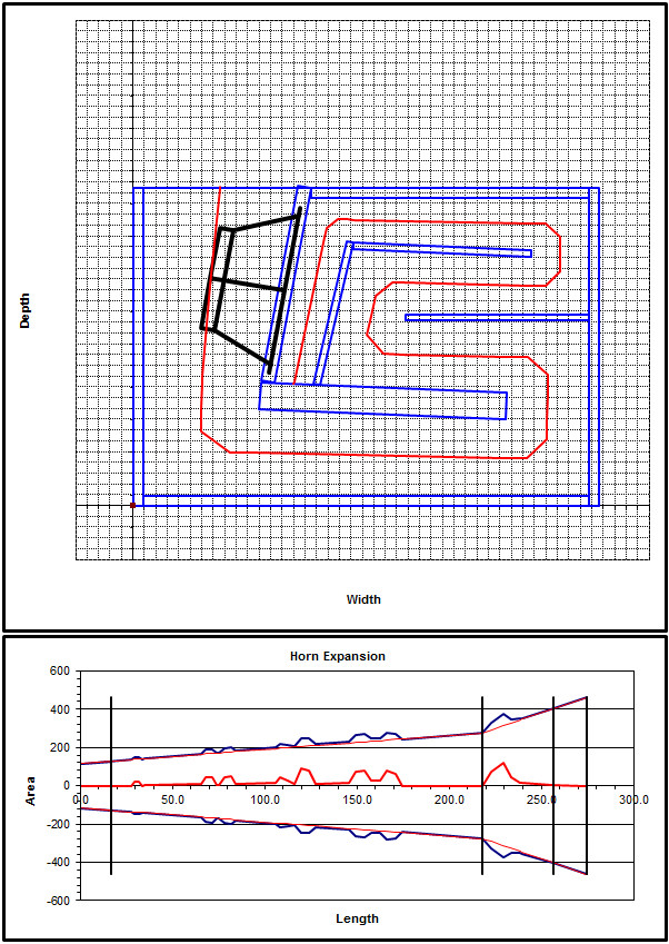

The Acoumass was something I picked up by looking at one of the examples in the manual where they describe the model of a dual driver band pass sub with flow through a corner. It basically accounts for the inertia of a flow on losses as it rounds a corner. Putting it on a straight expansion has a huge effect - but that is not where you use it. AcouResistance is pressure loss due to stuffing, wire mesh, etc. and is in Pa/m^2 per meter. Values arounf 5000 to 10000 seem to reproduce the losses of moderate to dense polyfill.
Hi xrk971,
Thanks, I'm just trying to read "Acoustical Network Components" in the manual.
I was able to attach a Helmholtz resonator (using duct and enclosure) @ S2. When I added Visc=500 to the duct it actually looked like it might work.

The "resonator" stub discussion got me thinking - perhaps it's possible to improve the response of "SS15"-fold THs by a simple modification - replacing one of the panels with a section that houses the resonators, and adjusting the box depth to suit.
See attached example. That is the layout for my POC#3, with one of the panels replaced with a box that can house the resonator stubs. The only significant modification required for the layout to accommodate the change was to increase the depth of the box a bit.
Now if those stubs can be used to suppress a 10 dB spike @ 160 Hz and an 8dB spike @ 220 Hz...
I think the discussion is academic at this point because I can't make the box any deeper anyway - it won't fit in the car's trunk. But it could be something to consider for POC #4, which I'm planning to start building around Xmas...

If you have the AkAbak script already I can add the stubs for you. Or get me the HR export to AkAbak for your SS15.
I don't want to hijack this thread any more. I'll see if I can get the export done and perhaps resurrect the thread discussing the POC3 to address this possible enhancement.

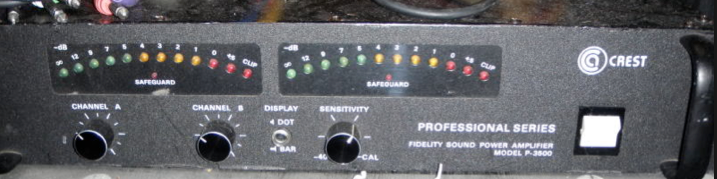

Cool, brings me back to 1981, when I used to own Crest P3500 amps with "eyebrow" LED VU meters, you could see them from 100 feet away!
You might look for a schematic of one of those amps to see what they did, as any DC in the output caused an output relay to disconnect the speaker outputs, preventing the "Flame Linear" (nickname for Carver's Phase Linear amps) syndrome of burning cones caused by the full output of the PSU's DC rails dumping into the speakers after a (marginal) output transistor would fail. There are many things I don't miss about the "good old days"..

They were super cool, but added a lot of price to the amp, so I only owned one with the "eyebrow" meter, and just watched for the single clip light LED on the versions without. Notice the switch that made the meter "Dot" (single LED) or "Bar" (all below peak level) illuminated.Art- that VU meter looks awesome!
Torroidaley wound transformers were new back then, and reduced the Crest P3500 size and weight compared to other amps, HF switching power supplies which reduced weight by another significant margin didn't come in for another half a decade or so.
Power to weight ratio in amplifiers has reduced by almost an order of magnitude (-10 dB) since 1980. Dragster 1/4 mile time has reduced only about 3 dB :^).
