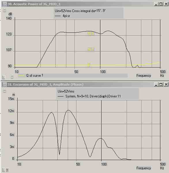

A little note about the 90Hz dip. when you reduce L12 to the edge of the woofer cutout, the main effect seems to be a reduction in this dip.
As a side effect (and I'm not saying add this to this box, it is great as it is, this is only an observation) you get enough volume for at least one resonance stub, e.g.: for the lower of the twin peaks.
Maybe xrk971 can have a look what this will do in his AkAbak simulation.

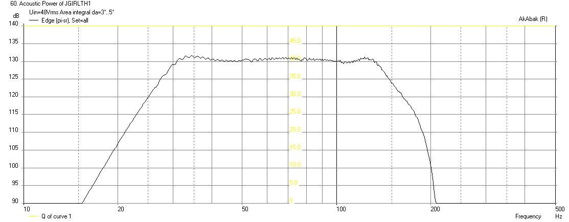

I gave it a try in AkAbak, the script is attached as a .txt file (this is not as good as xrk971's work, just more or less straight from Hornresp). This has the shortened L12 and two ducts, I also copied the high and low filters into it. The input voltage for the SPL curve was 52V. Just in case someone wants to try it.
It might also be interesting to see if one can use the extra volume resulting from shortening L12 as Helmholtz resonators.
