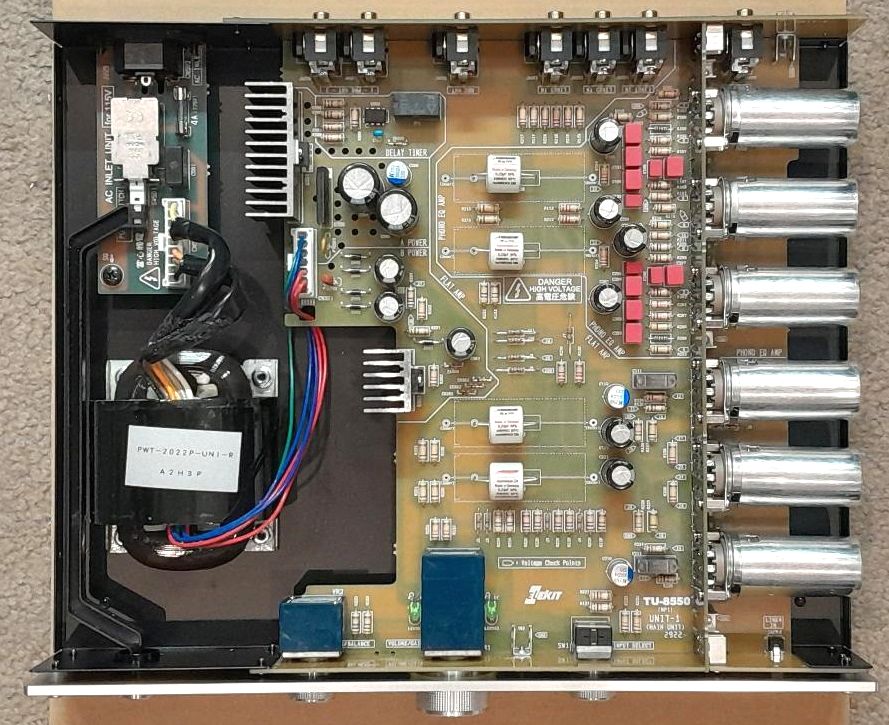

shed up the TU-8550 today, after doing all the PCB assemblies (about 4 hours) it takes an hour to put them in the chassis,
install the tubes, and put the cover on. I'll be doing the voltage checks and actual listening tests this weekend.
It's a very nice package, a lot more classy looking than some other Elekit's, nice faceplate and compact size.
Looking at the circuit diagram, any real audio improvements will come from tube selection and output coupling caps.

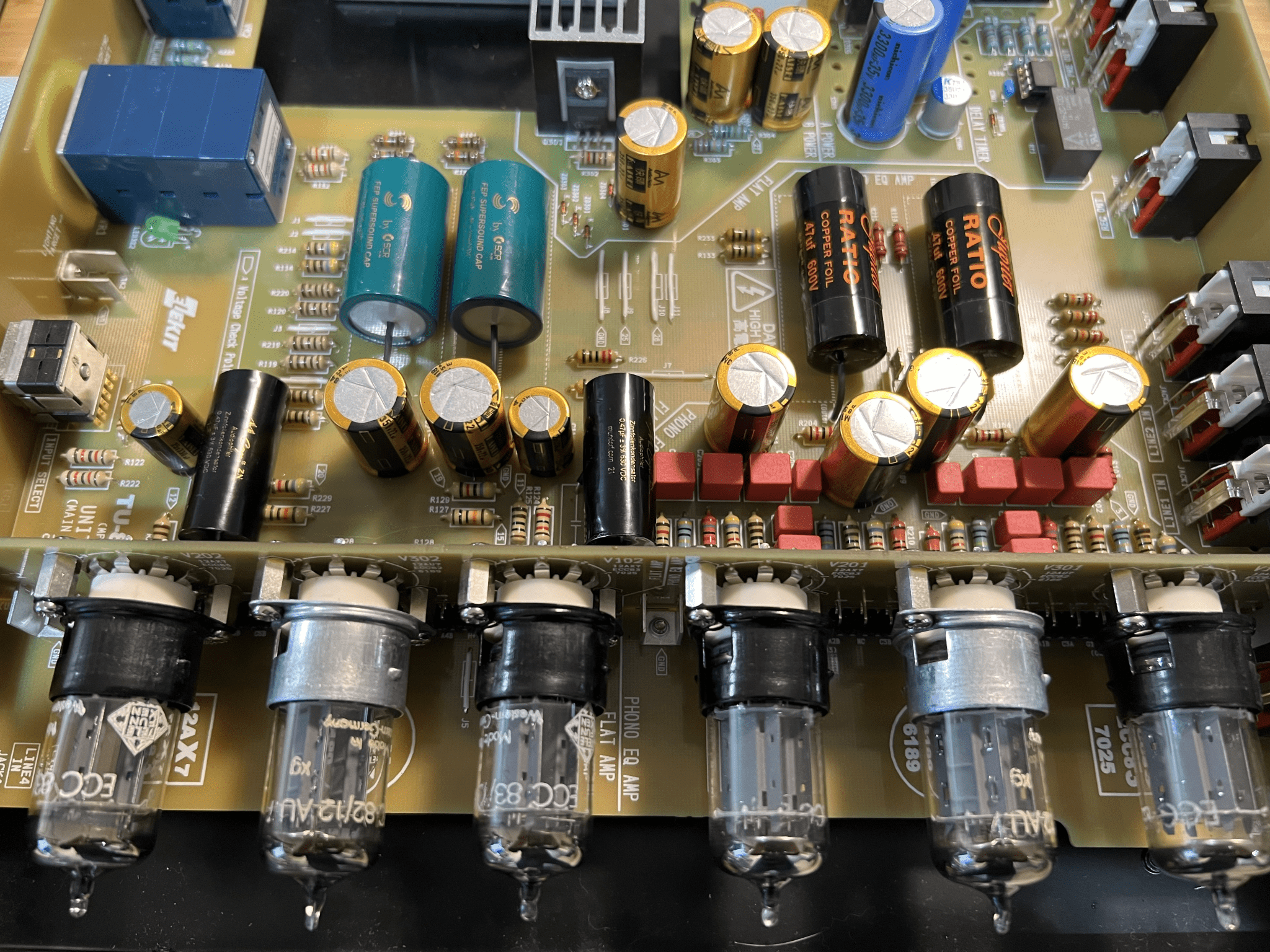

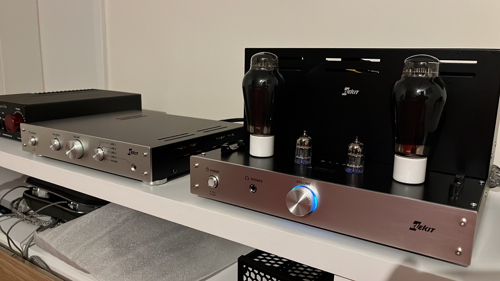

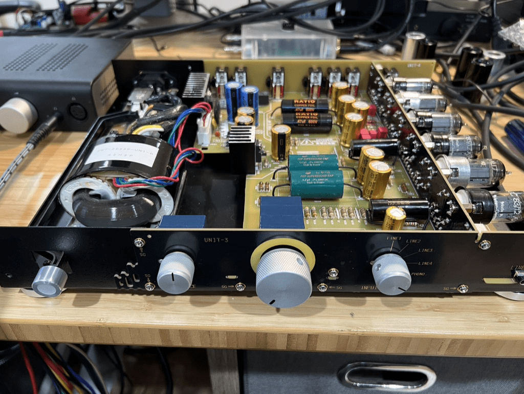

I finally completed my 8550 built and burn-in(100hrs)! It sounds pretty great in combo with my TU-8900, though I think the Teflon/Tin caps and the AN resistors could use a bit more burn time.
I ended up upgrading a lot of parts:
Fun build overall, not as involved as the 8900, but makes a great buddy/stand for it
- Audio Note Kaisei polar caps in most locations
- Audio Note Non-Magnetic Tantalum / Niobium resistors in most places, Takman REY and Vishay Zfoil for some odd values or non-signal path
- Jupiter Ratio for the Phono Caps / Solen S3Q Teflon for Amp side Caps + Mundorf Mcap ZN
- Pure silver wire, replacing jumpers
- Amtrans Silver-Plated Ceramic Tube Sockets
- NOS Telefunken 12AX7 / 12AU7 in Pre and Phono sides (though I'll probably switch to gold lion for phono as they are on all the time regardless of using phono)
- EMI shielding tape lining the top removable lid, MuMetal barrier between the transformer and PCB (not shown)
- New all aluminum matching front knobs (got the same for the 8900 to match)

I use PTFE Tubing or Heatshrink.What did you use to cover the leeds for the Jupiter Ratio and the other capacitors?
