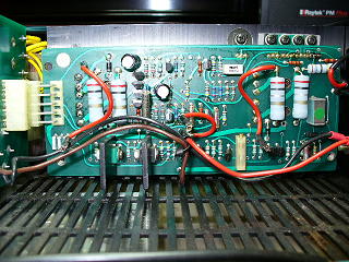

I know this is an old thread and I apologize for reviving it. Any help you can provide me will be greatly appreciated. Do you have a parts list and a schematic for this AW100DMB? The board markings show:
ECL92
9633
A schematic for the power supply would be helpful also.
I tried to post photos below of the left channel board, hope it worked.
Thank You
HW

Hello sir,
I have done quite a couple of ampliwires. I still own the original two-channel, a (serial 534) AW-100, and a AW-75dmb. Up to now I still love them all but the two-channel the most.
First of all: don't assume a thing (!) there are many 100's out there with bad repairs and /or wrongly interchanged boards.
First of all, check if the amplifier boards are the same. And if they are also the same qua components.
We are talking about an AW-100dmb. Not an AW-100.
What I would like to know is the number on the amplifier pcb. (it could be on the back in between the heatsink and pcb) But a picture of the amplifier board would be better, so i can easily identify the board and help you out.
(also point which components are "gone") Your amp is probably coming from the early nineties.
One thing about ec's : They are NOT normal amplifiers. You need to see them as heat factories and accordingly treat and restore them that way.
It sounds silly, but some of them run really hot. Especially the two-channel, which is set for 1c bias (!).
I'm also sure that you already have the schematic send to you by someone.
Interpreting it is a different story. Not all the amps in a line are the same.
some will have rc filters on the + somewhere on the amp board, some don't. It depends on the quality of the pcb. So one golden rule would be :
Don't repair an ampliwire, Take very proper fotos of the parts and how the amp is build, so you can take it apart and don't have to worry about where that wire comes from. Next make a list of parts you need. It is probably for the best to renew all transistors too besides the basic overhaul.
Be sure to create the best and proper soldering connections you can deliver and do the entire board. (some parts needs the heat to be redirected, so be careful) Depending on the model .... not all of them are build like yours, You can clearly see the progression to deal with the heat: lowering bias.
Send me some info if this thread is still valid for your amp.
I just stumbled upon it .... a little late i see

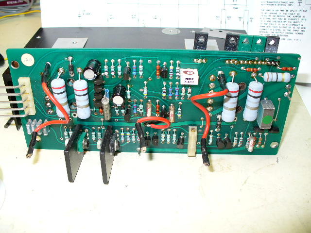

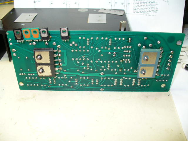

Is that board from an AW100 DMB? Only 1 pair of output devices cant be right. Specs say 2x200w @ 4r and 2x350w @ 2r. Your PCB is marked 120L-3 .. AW75 seems more likely.
What are your rail voltages?
BTW: Is that a Burson descrete op amp as DC servo?

Well it came to me this way with a faceplate that’s shows AW100 DMB. That is a Burson but I haven’t powered the amp up with it in place yet. Not completely sure it is comparable. I just had a set lying around.

The schematic below seems to show only one set for the AW100 DMB .
