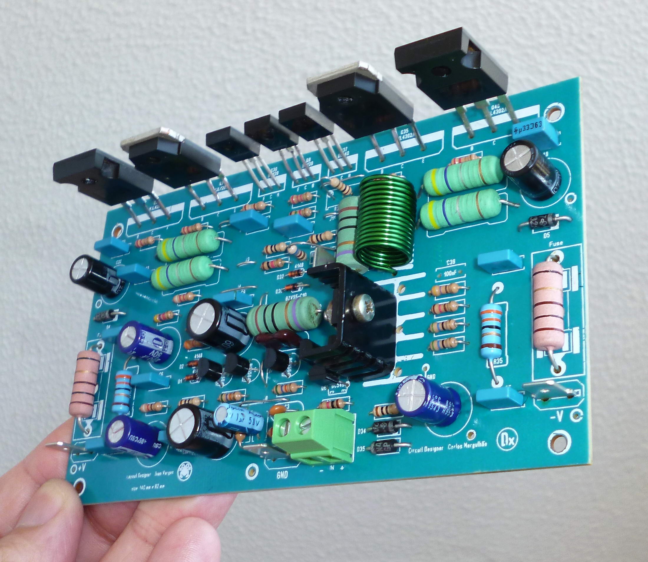

Juan Vargas Diaz pcboards
Here you have some pictures.

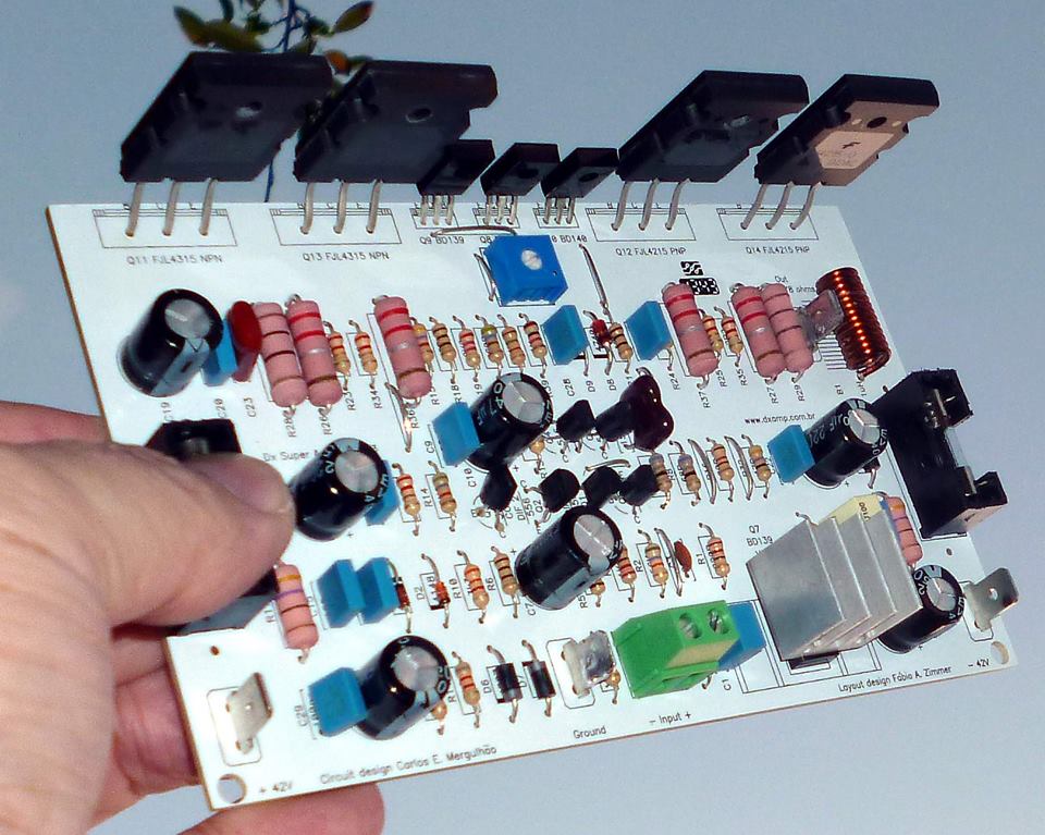

We have not Iordan...... about Brazilians building this unit
I am glad some people still build this unit....they like to reduce the bias to to avoid heat (the same as me) as they do not listen Classical Music and the increase of bias will not help modern music actually.
I have asked Zimmer not to provide pcboards anymore..people has not good knowledge (In Brazil) to assemble....they use to complain the sound is distorted because they forget to install fuses and power supply goes througth protective 100 ohms resistor (one per rail)...some increase the voluma and complain the resistor (no fuse) burns
Well.... others forget wire jumpers..and this opens the VBE multiplier and the consequence is the NPN driver goes immediatelly as 42 volts goes to the base.
So.... i concluded (very late conclusion i have to admit, as Hugh Dean concluded that in 2005) that it is not a good idea to sell kits of boards..i ordered Zimmer only to sell assembled and adjusted amplifiers...so....this is the way we are doing.
But!.... people has access to layout..and they can etch at their own home...people that etch their own pcboard, usually (not always) is more skilled and does not give me too much hard work explaining details and giving follow up trying to detect foolishes made in the power amplifier construction....or...builder errors.

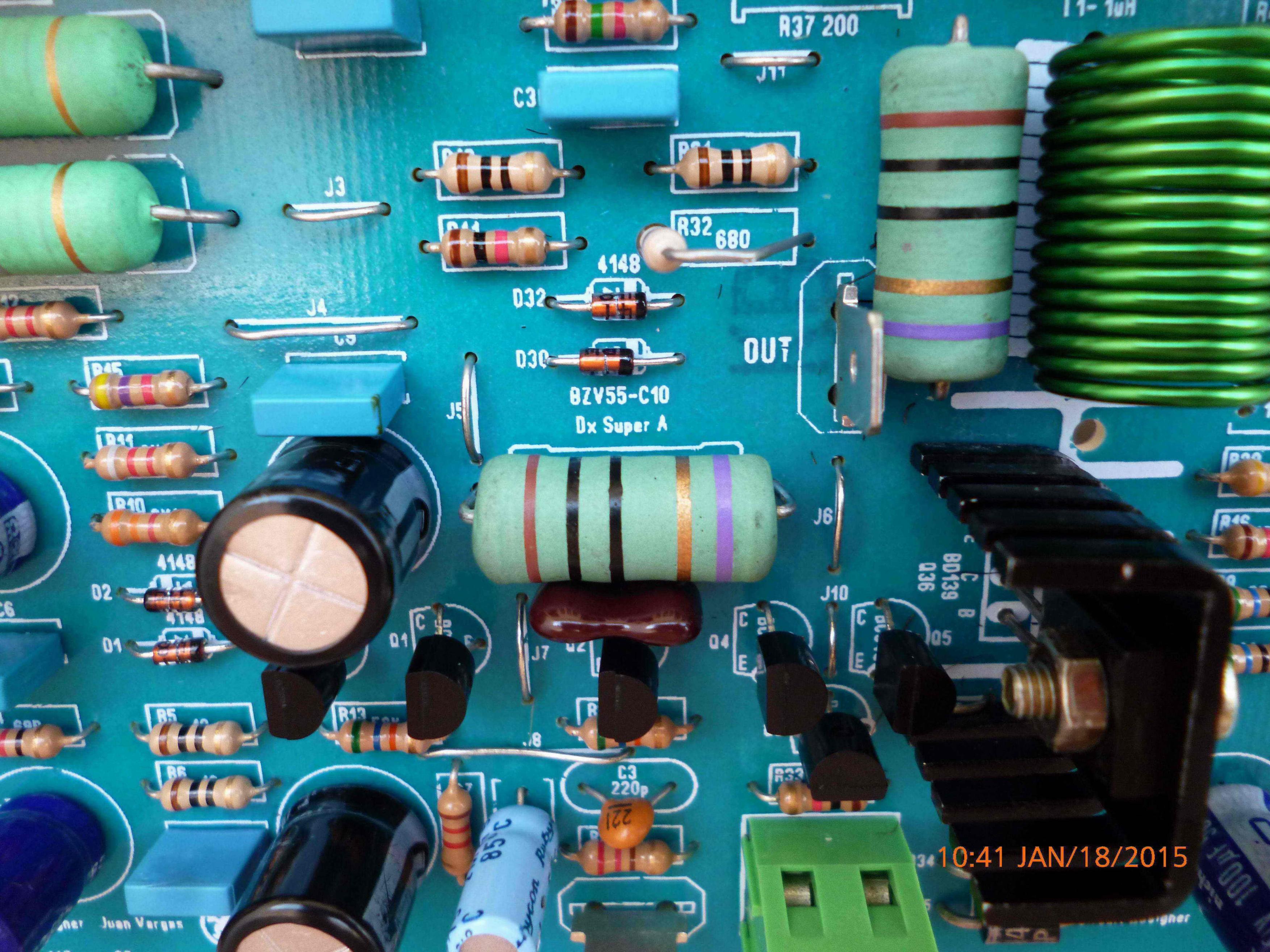

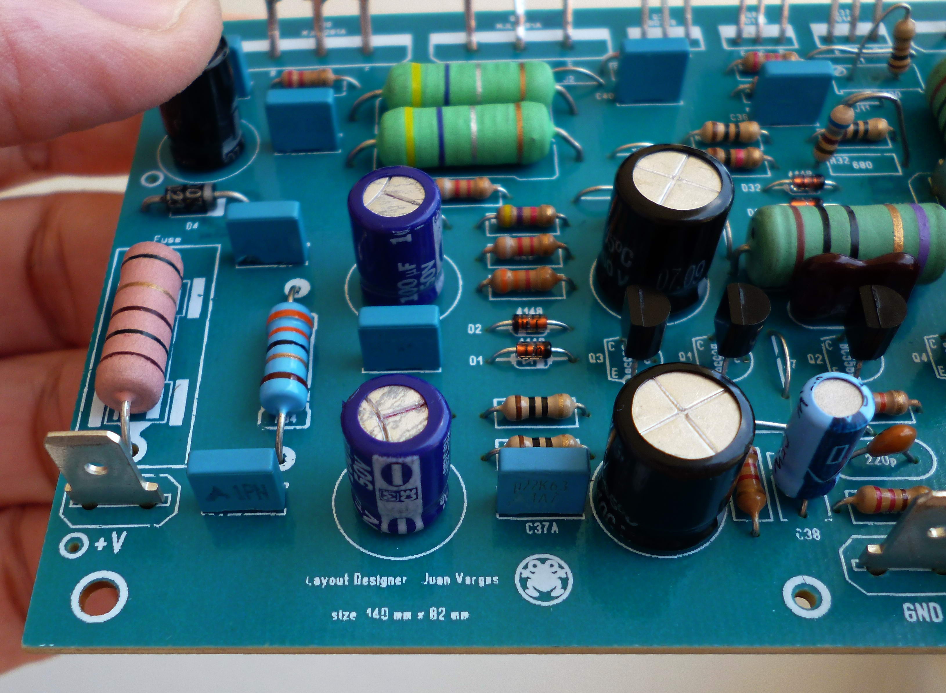

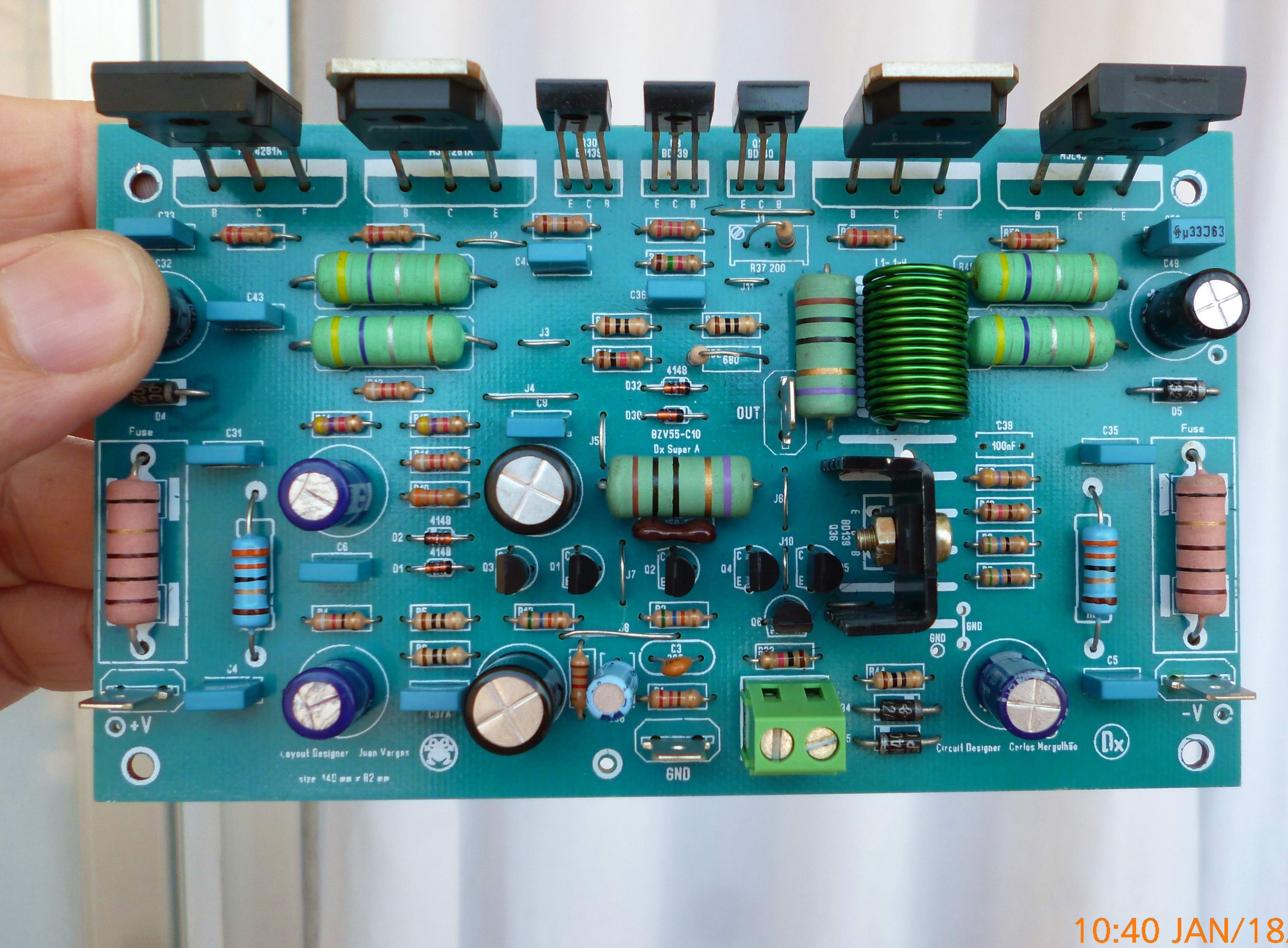

I have found a wrong stuff in Juan Pcboard...my mistake
https://www.youtube.com/watch?v=MglTwdQr17s
The CCS control resistor is wrong.... the best value there is 180 ohms instead of 68 or even 82 ohms as published in march 2014 update.
With 82 ohms, some transistors operates at 50 degrées celsius...small ones...and this harm the amplifier performance.
Please, replace it!
Sorry...my fault.

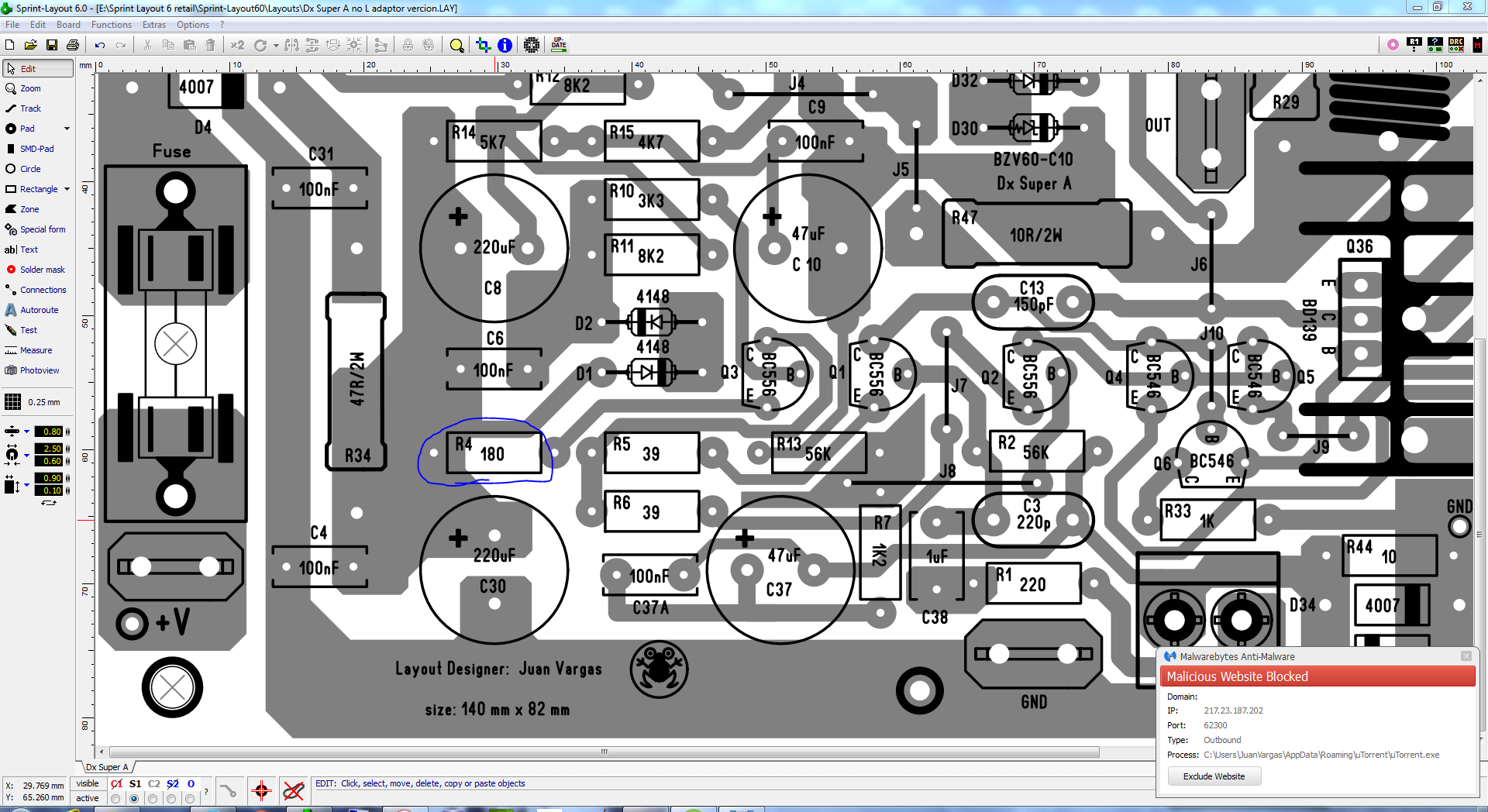

How a mistake happens...several guys checking..no one have perceived
About this video below:
The optimized value was 168 ohms... value found in simulator and tested into the prototype pcboard a long time ago....then i have reported to Juan 68 ohms....i reduced 100 as a big mistake..... latter, on a revision in March 2014 i found some transistors too much hot (50 degrées celsius)...... then i have increased to 82 ohms.... this made things better, but making comparison in between some amplifier models i have..i found sound compressed on this unit, due to the excess of current into the differential pair....this made me understand the sequence of errors made...and not detected in the revision...things we perceive when making A to B comparison..without reference we usually do not perceive.
Yes...i do mistakes.

Yes dear Juan..... a shame.....i am sorry, my mistake
The amplifier works stable with the previous values...but overheat some transistors that may cause some off set drift and compresses the sound as the current to the differential is out of the "optimum" range.
With 180 ohms we have even new life to the amplifier...it was awesome in sonics before and now much better...try it and listen.
People have not complained about compressed sound..imagine how they gonna fell after modification...they will fell from their chair astonished with the sound.

I think I have a bunch of 180 resistors so I will make the change to see how it responds is amazing because I don't even notice the change on sounds with R4 as 68R I will let you know after I make the changes
Regards
Juan
