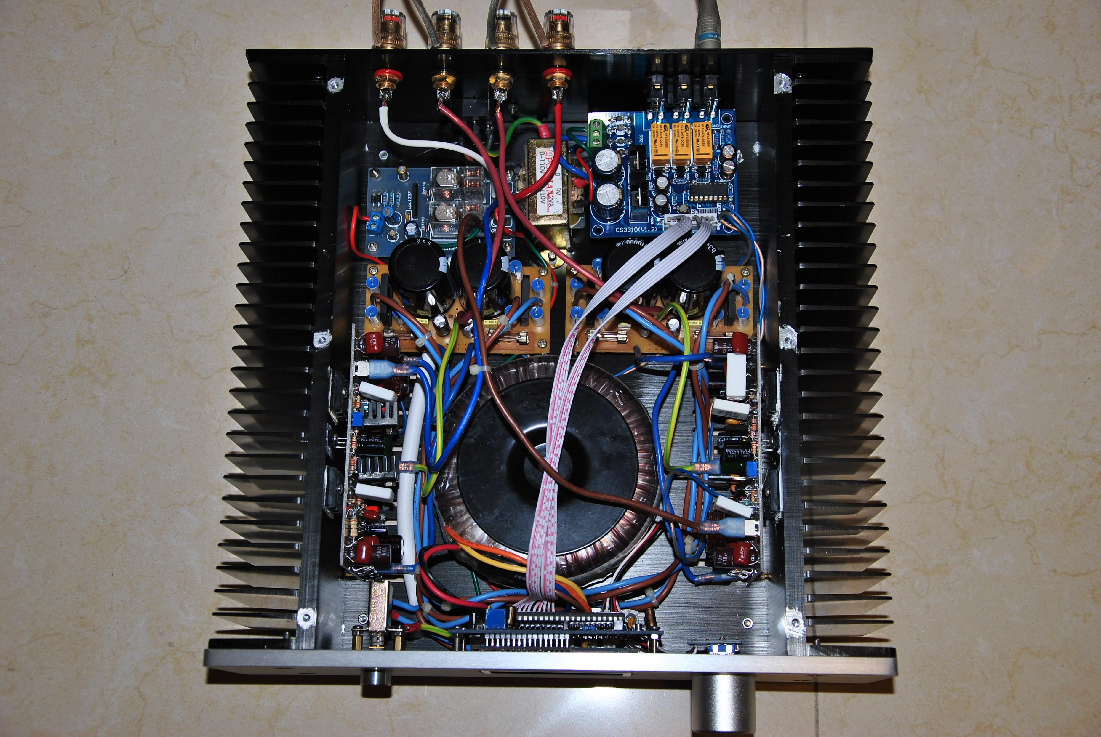

My Blame ST
It was built a few years ago, with PGA2311 volume control. Sonic is awesome and my friends were amazed by its smoothness and musicality.

It is a tweaked Blameless from Doctor Self
This design, with very low THD, is unbeatable, you can turn the volume all the way up and even nearby the threshold of clipping the sound is awesome....due to low harmonics generated at this level of power...below 0.003% and 0.001% in most of the cases.
I have tweaked, some spice added on it, but real great guy is Doctor Self...i deserve to be recognized as someone made the rigth choice and worked hard to develop and to promote it....modifications made, but even this way you can see the Blameless frame on it.... the differential style, feeded by a CCS, the enhanced VAS style, also feeded by a CCS (mine ones, not always this way), the emitter follower output in a darlington style, the floating drivers resistor..the suckout capacitor ...well....there's something a little bit different..but you can see the skeleton is from Blameless...the spirit, the idea, is there.... i do think what i have learned from Aspen Amplifiers, from Doctor Hugh Dean, is what result in a so good sound.

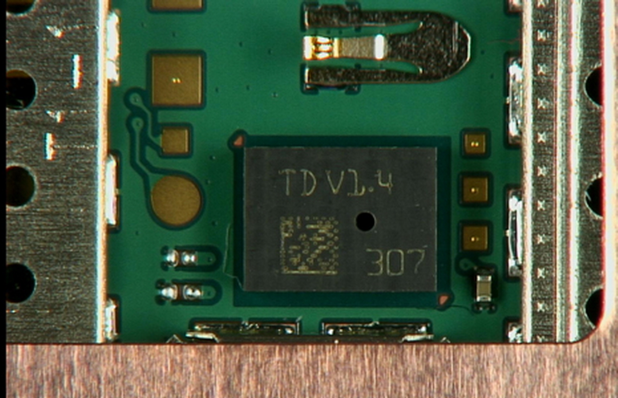

Then i have studied a little bit more this subject, i have discovered that inside Nokia we have an engineer that has passion for Rock live shows...he could not make good recordings..then he sold the idea to Nokia, he convinced people to produce a better audio system based into two microphones, one hard to move to high pressure of sound and another soft, to low level, something that can saturate easy..... then a microprocessor switch one and other on and off.... this way (simple way to describe) he made a nice audio recording system able to face 100 decibels of sound pressure, also able to capture very low levels..... he increased signal to noise ratio to 86 dB.... also crosstalk was increased from 76 to 85 i think (not sure).
Well... real numbers...not advertisement numbers that use to say 120 dB or something lunatic this way.
This system was applied in some Nokia cell phones...i am not sure about the N8, but i am sure this was applied into the 808 rich sound.
